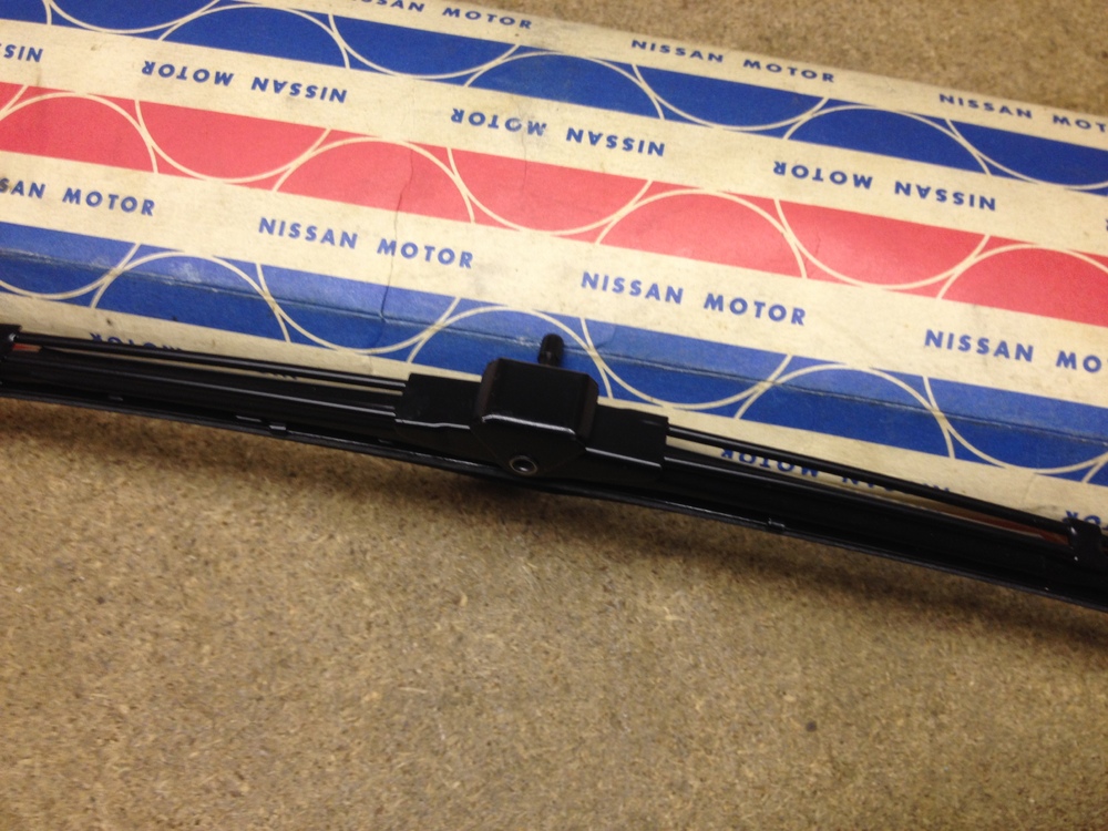

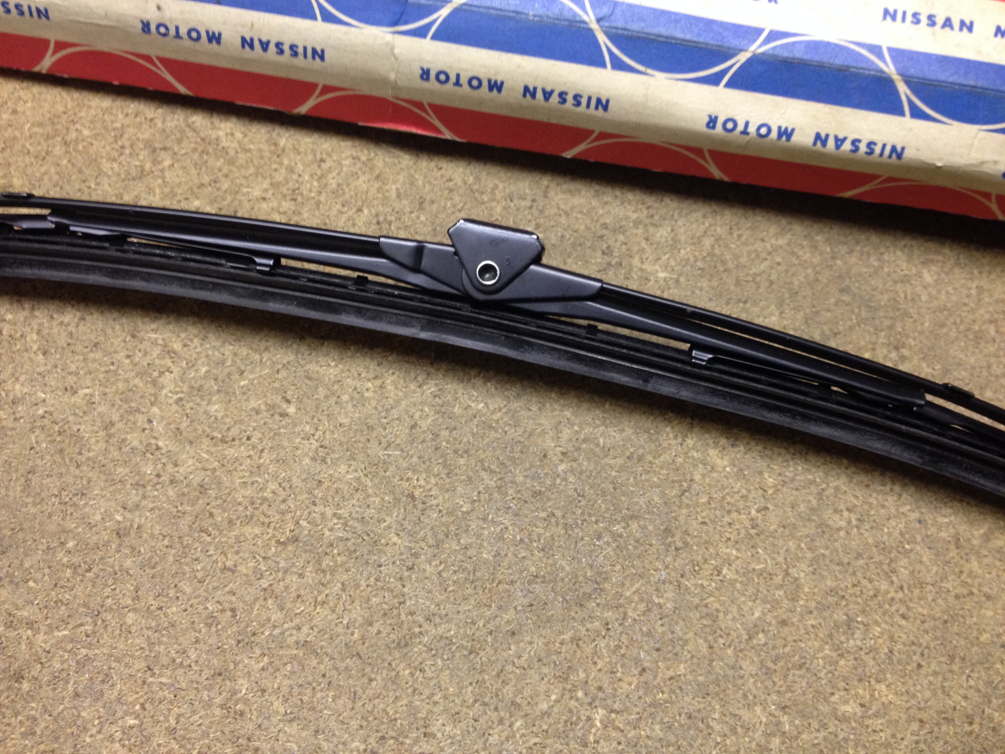

I'll take a pic or two of what I've got as soon as I've got a stable picture host set-up.

Yup. That's what my blade holders look like. Thanks for the pic.
