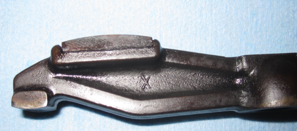

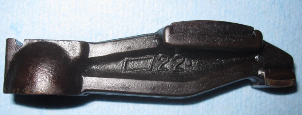

Here's a picture I took in the past.  I'm 99% sure it came from my 1976 cylinder head, which I'm 99% sure is completely factory original.  The two sides are different.
Same with mine, but the other side is a 's' instead of the 'x' on yours. I got these in packages shown from another person. It does have the factory P/N on them but
some of these aftermarket suppliers sometimes like to mark the Nissan number on their package. Don't know if the (ATS) means anything on the package.
I may keep them for awhile yet in case I set up another cam in the future.
I was thinking that parallelogram was part of some company's logo but I can't remember which one. But now I see the second pic and the angle changed on the parallelogram. I probably have a couple hundred rockers so I'll try to look at some of mine. I think some companies also use the Nissan part numbers.

It might the mark of Paraut.  Apparently they were the OEM supplier for Atsugi (or vice-versa).  Who supplied Nissan and maybe still does.  I had another thread on Hybridz about rocker arms and one of the guys over there seemed to know quite a bit.  Xnke.
http://www.elautoparts.com/item.wws?sku=A4040-51981&itempk=86615&mfr=Paraut&weight=0.20
The package does have 'ATS' marked on it so may well be Atsugi make. And they also have that white paint mark on them.
