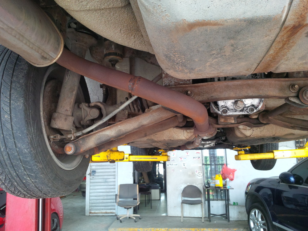

What exahust do you have? I used to have the stock exhaust with a resonator in the middle and a dynomax muffler at the end as per the pictures attached. It had no deceleration backfire even with a 4 turn clockwise ( 4 turns left) when releasing the gas pedal in 2nd and 3rd gear. My cam is a Schneider 274F as my car engine has been modified to 2.6L by PO. After installing the MSA Premium Stock exhaust for stock manifold i am experiencing lots of popping when releasing the gas pedal on 2nd and 3rd geat. PO also eliminate smog pump and all emission crap.

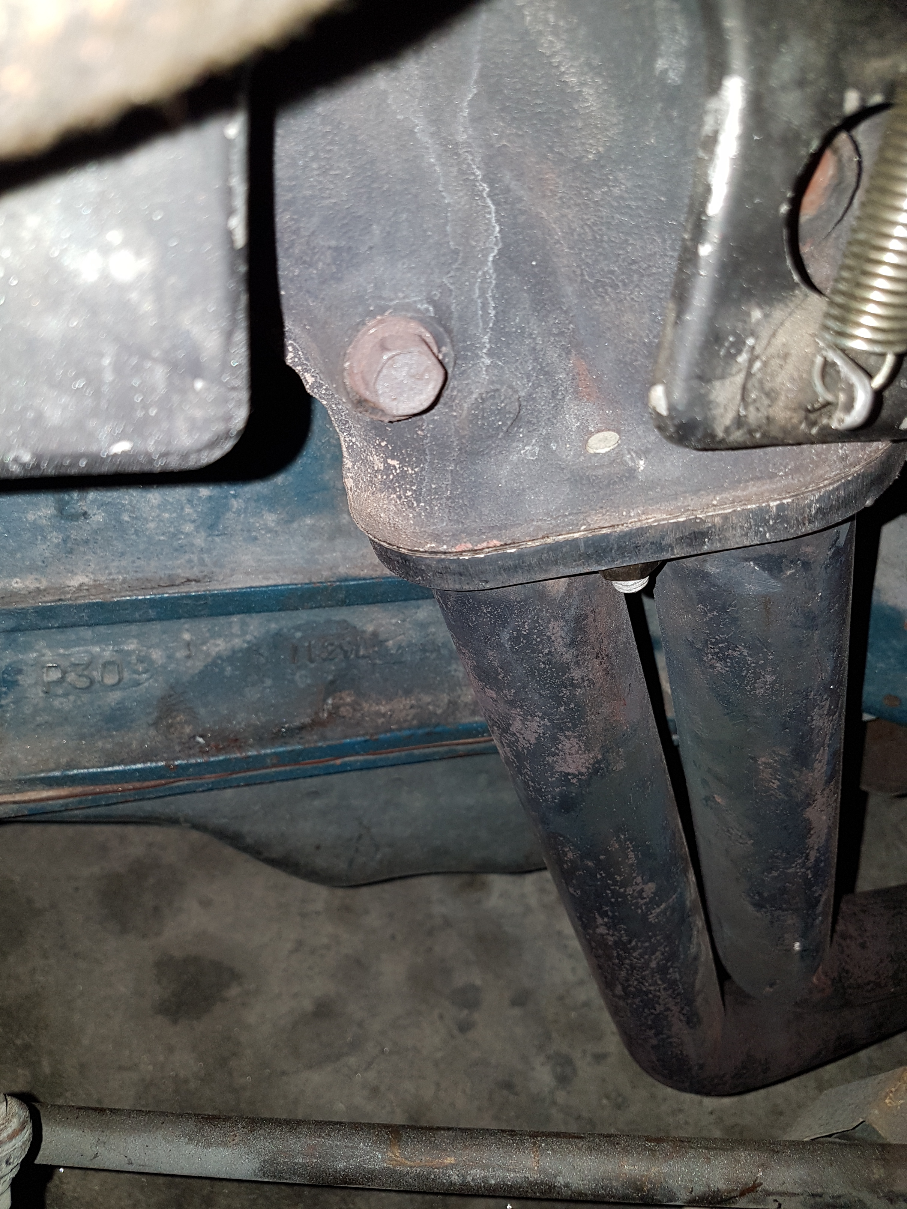

Any clues? I will verify all the flange gaskets once again as i still suspect a leak between the manifold to the downpipe. I felt some hot air blowing at that union last week. Maybe i can drop some wáter and soap in that área to verify. Anyone????

This is what i have on my engine. I guess since you have the original camshaft and the original engine you are not experiencing any pop. I also noticed some hot air leaking from the union between the manifold to the downpipe. Could fixing this solve the decel popping?

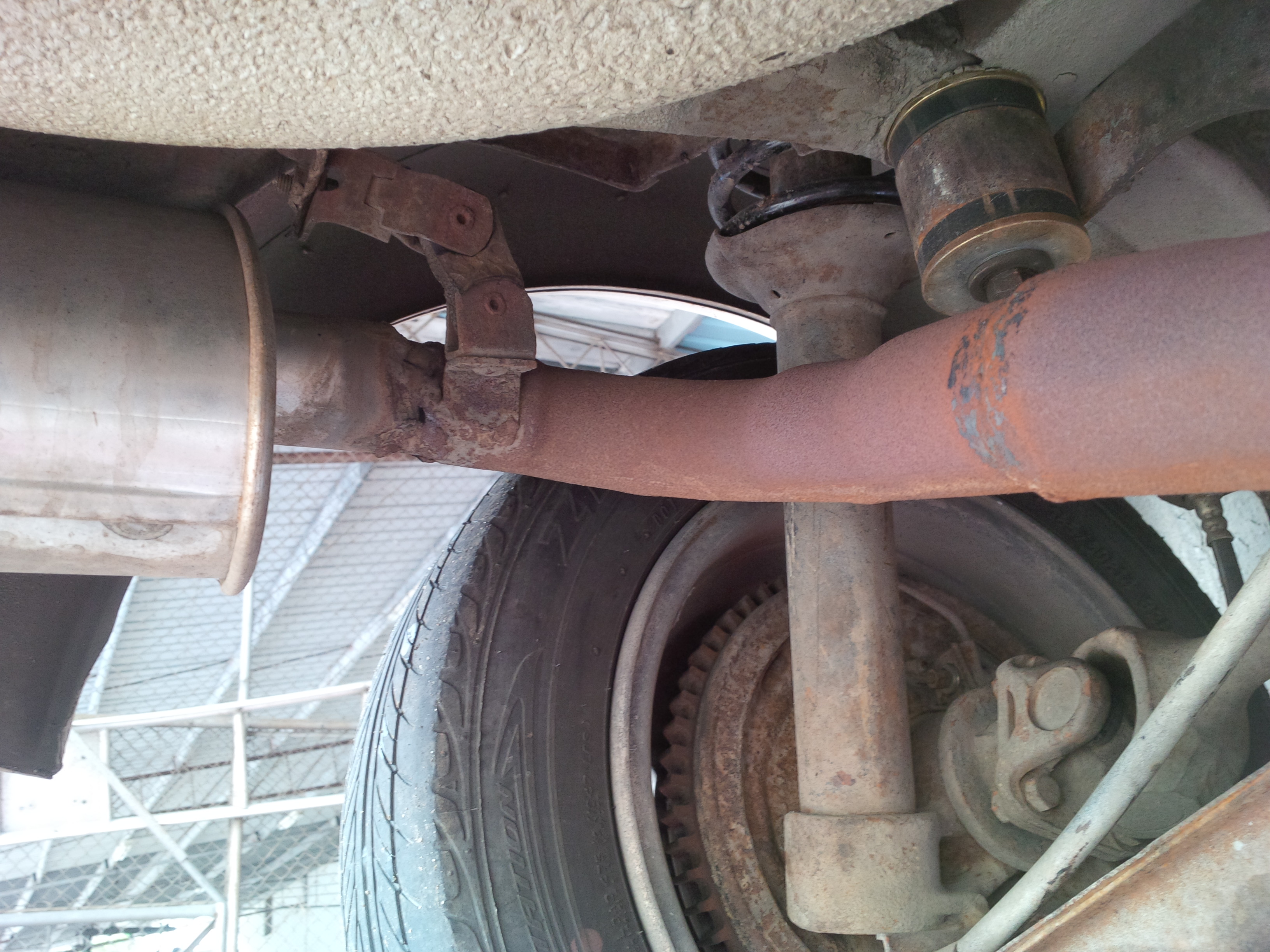

Looks like there's a hole in the weld where the rusty old stock tailpipe meets the new muffler. That's the worst welding I ever saw. Sorry if you welded it yourself. Whoever did it should practice a lot on some old parts before welding for a customer.
