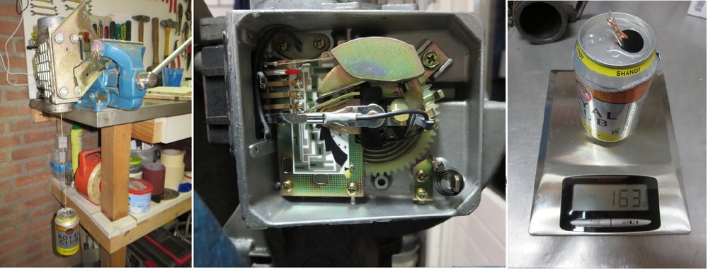

June 24, 20178 yr comment_523846 Here is the leak test procedure I did on mine a couple of years back. It's good to eliminate possible causes. I know you replaced a lot of items, but some of the parts these days are "remanufactured" items and the quality is sometimes lacking. Btw: You can not remanufacture 280Z injectors. All you can do is change external stuff like the inlet filter and hose, and run them on a test unit with special cleaner. Not all aftermarket parts are new parts... Instruction - Fuel Pressure Test 280Z RevB.pdf Link to comment https://www.classiczcars.com/forums/topic/57946-78-280z-flooding-when-starting/?&page=4#findComment-523846 Share on other sites More sharing options...

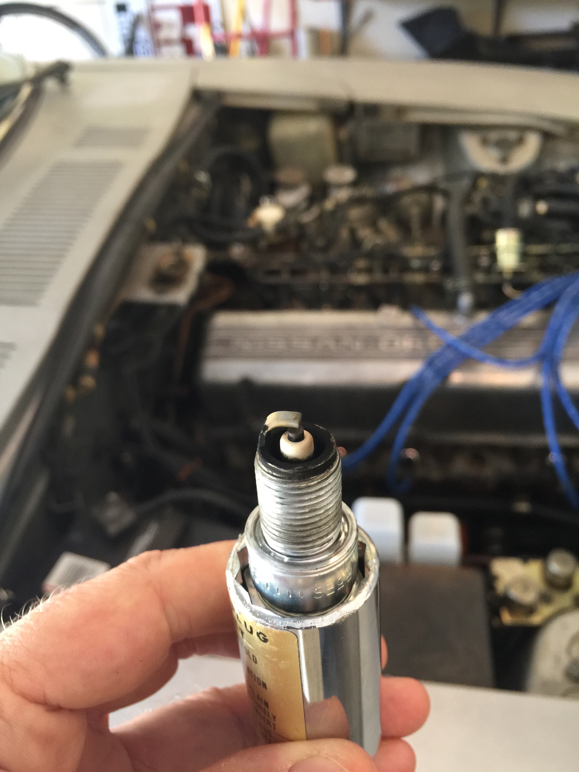

June 24, 20178 yr Author comment_523876 ok. Beginning a few tests. The goal is to determine my over fueling issues and the reason the Z has begun to simply cut off. To catch you up.....I started the car yesterday and let it idle for about 15 minutes then pulled the plugs. It hesitated ever so briefly before firing off and idling smoothly. The plugs were dry but covered in black soot. Not a surprise after the car cutting itself off the previous day. I pulled the plugs cold this morning and there was no change. No additional wetness etc. I then started the car and again it briefly hesitated before firing off an idling smoothly. I then checked the AMF and manipulated it a bit at idle and 3,000 RPM. It ran slightly better moving it only a mm or 2 clockwise at idle to lean it up. Manipulating it counter clockwise made the engine run rough at idle. I did not notice a difference at 3,000 RPM when manipulating it clockwise but it ran rough counterclockwise....... I have the glue on my AMF by the way. It has never been adjusted. I then decided to take my tools and take the car around the block. She ran like a champ. After 5 minutes I turned back toward the house ...not wanting to challenge the Z gods. About 100 yards from the driveway she cut off. No heads up. No miss-fire. The Tach went to 0. I was able to coast back to the garage and immediately gave thanks I was not stuck on the freeway again. I then pulled the plugs. Photo attached. If I had run it longer more of the soot would have burned off in my opinion, but the tip was hot and clean. So I am determining that I don't really have a fuel issue that is leading to flooding and the car simply cutting off. I will now move to searching for an electrical gremlin. I believe I will begin with the ignition module buy will also check connections in the ECU. Thoughts? Edited June 24, 20178 yr by Dogariffic Link to comment https://www.classiczcars.com/forums/topic/57946-78-280z-flooding-when-starting/?&page=4#findComment-523876 Share on other sites More sharing options...

June 24, 20178 yr comment_523889 50 minutes ago, Dogariffic said: I then started the car and again it briefly hesitated before firing off an idling smoothly. I then checked the AMF and manipulated it a bit at idle and 3,000 RPM. It ran slightly better moving it only a mm or 2 clockwise at idle to lean it up. Manipulating it counter clockwise made the engine run rough at idle. I did not notice a difference at 3,000 RPM when manipulating it clockwise but it ran rough counterclockwise....... I have the glue on my AMF by the way. It has never been adjusted. I then decided to take my tools and take the car around the block. She ran like a champ. After 5 minutes I turned back toward the house ...not wanting to challenge the Z gods. About 100 yards from the driveway she cut off. No heads up. No miss-fire. The Tach went to 0. I was able to coast back to the garage and immediately gave thanks I was not stuck on the freeway again. I then pulled the plugs. Photo attached. If I had run it longer more of the soot would have burned off in my opinion, but the tip was hot and clean. So I am determining that I don't really have a fuel issue that is leading to flooding and the car simply cutting off. I will now move to searching for an electrical gremlin. I believe I will begin with the ignition module buy will also check connections in the ECU. Thoughts? If someone played with the adjustment of the AFM, you can calibrate it by using the coke can method. Here is a link to the Atlanticz website: http://atlanticz.ca/zclub/techtips/afm/calibration/index.html I had problems with my TIU and ended up changing it to a 4-pin HEI module. It use to work perfectly and once it warmed up, say after ten to twenty minutes, it would start playing up fierce and left my parked on the side of the road. I sprayed it with a can of contact cleaner to cool it down and the problem would go away for ten minutes or so. This thread explains what I went through and it's also in the download section of this site. Section 9 in the download file has some tests you can do. It wont find a problem that happens at random, unless it's happening while you are testing. Goodluck searching. Edited June 24, 20178 yr by EuroDat Link to comment https://www.classiczcars.com/forums/topic/57946-78-280z-flooding-when-starting/?&page=4#findComment-523889 Share on other sites More sharing options...
