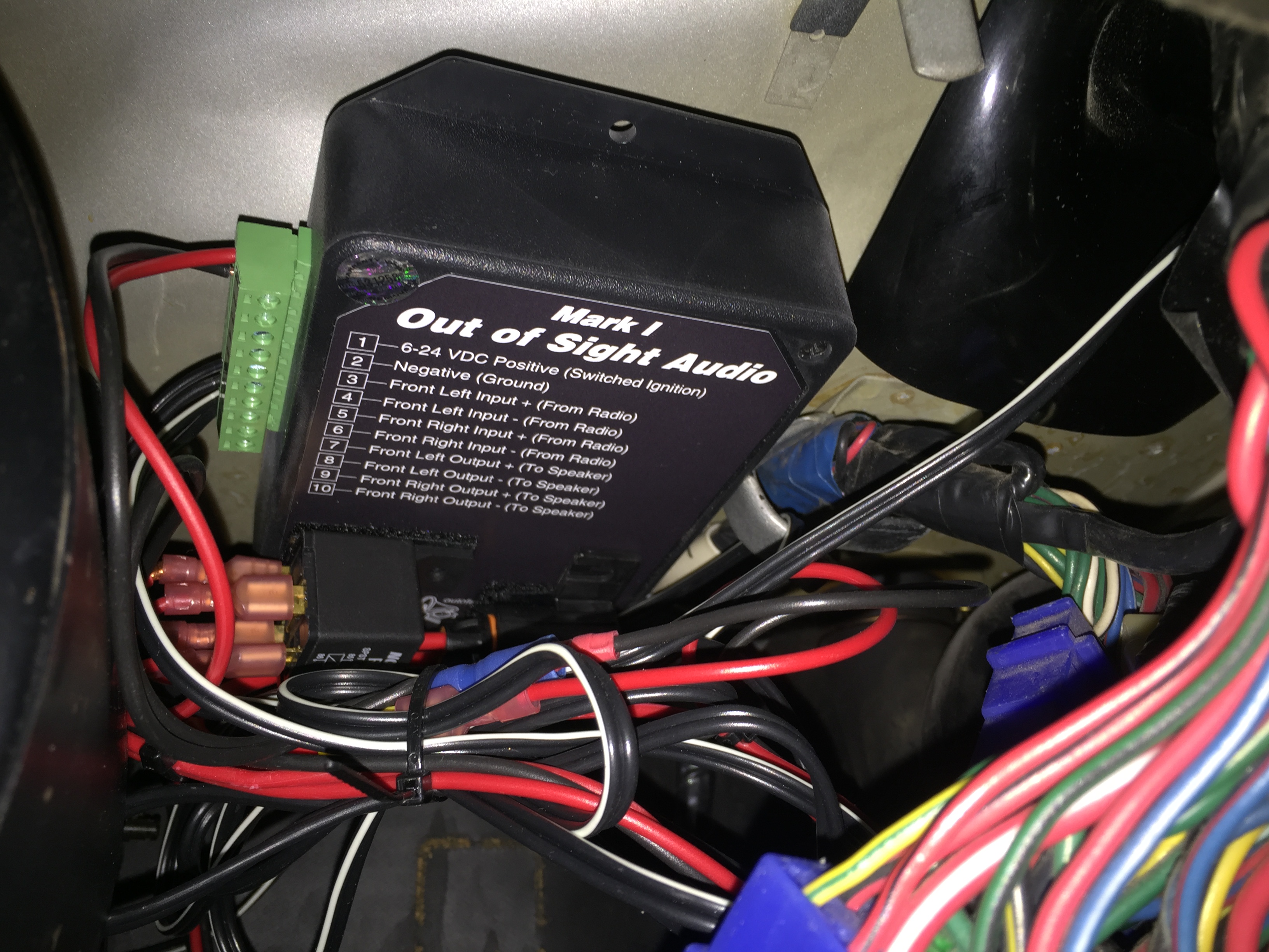

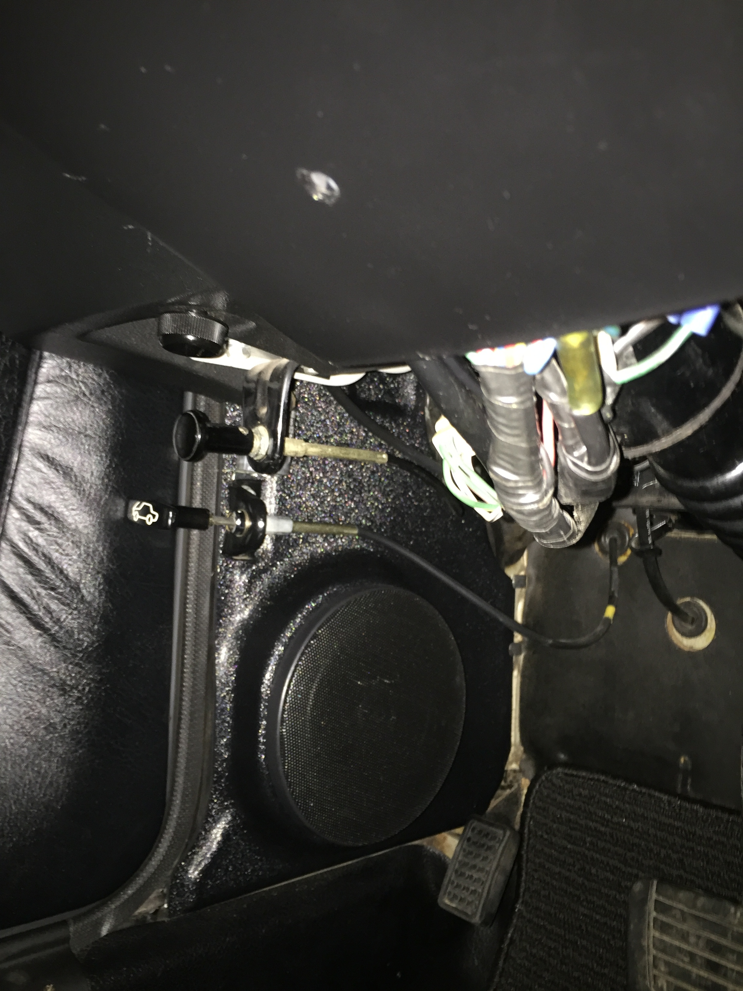

I looked at the RetroSound a while back when I was attempting to find a solution to my lack of tunes issue.  Ultimately, I decided to go with a Bluetooth audio box from Out of Sight Audio and the kick panel speaker kits from Motorsports Auto.  This allowed me to keep my stock radio in place but, add amplified stereo bluetooth streaming from my iPhone.  The phone pairs automatically when I start the car.  Volume is controlled by the volume buttons on my phone.  Since I was able to leave the stock radio and speaker alone, I can use that if I'm sick of Pandora or my MP3 collection (most radio stations offer streaming anyway these days so, very little need to touch the radio anymore).  I have been running this setup for over a year and the only complaint I have  is with the performance of the Motorsport Auto speakers.  They tend to be on the tinny side if I am using an app on my phone that does not have graphic equalizer functionality.  This setup also works nicely as a hands free solution.  No drilling or modifications required.  Just used some good velcro to stick the Bluetooth box under the dash, run power to the battery and ignition wire.  Speaker wire runs are all under the dash as the speakers used by the bluetooth box are up front.  The company makes several models.  I opted for the 2-channel but, they also have 4-channel and options for  pre-amps.
http://www.outofsightaudio.com/?gclid=CMvH2bGPsdQCFY6FswodRUQKJw
Forgot to mention that I installed the connection to the ignition wire using a relay.  Did not want this thing to draw current through my ignition wires!  Relay closes a direct connection to the battery via trigger from the ignition wire.

Glad this helped sir!  Let me know if you go this route and have any questions.  Only change I would consider making is using better speakers than I did!  Get the kick panels from Motorsport but, I know there are better speakers out there that will fit the kick panel space than the ones offered in the Motorsport kick panel/speaker bundle.

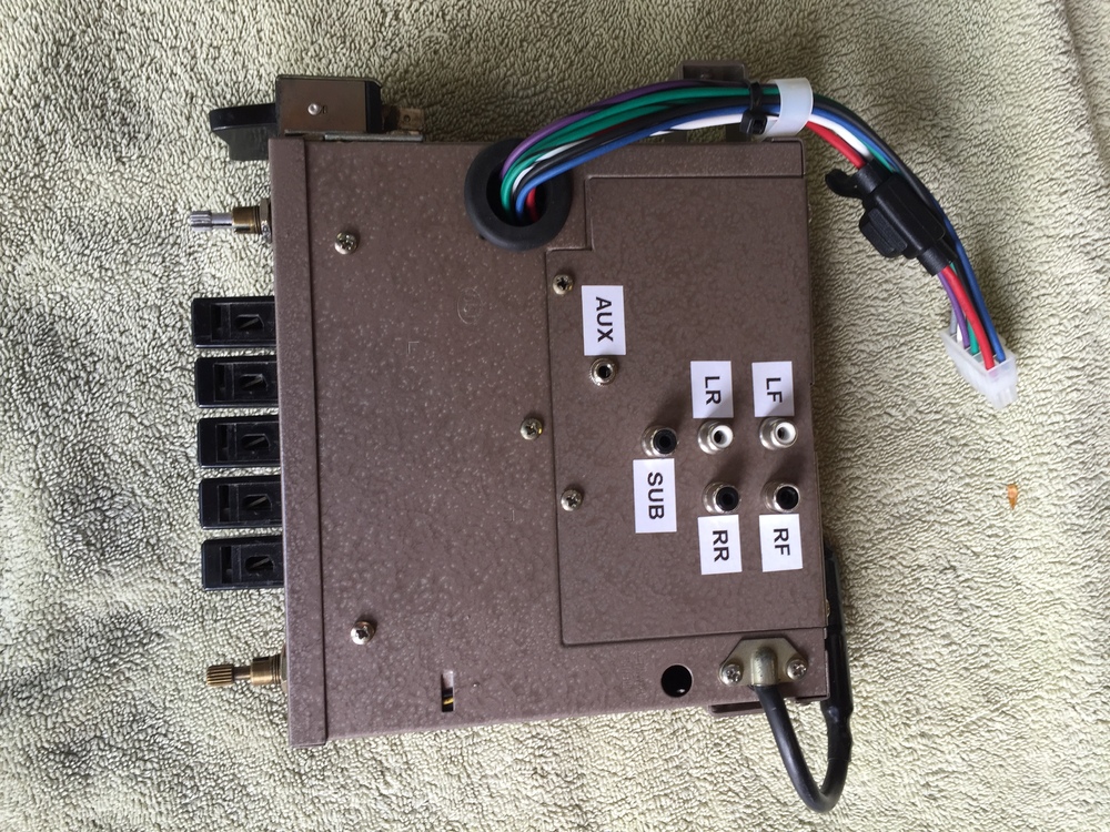

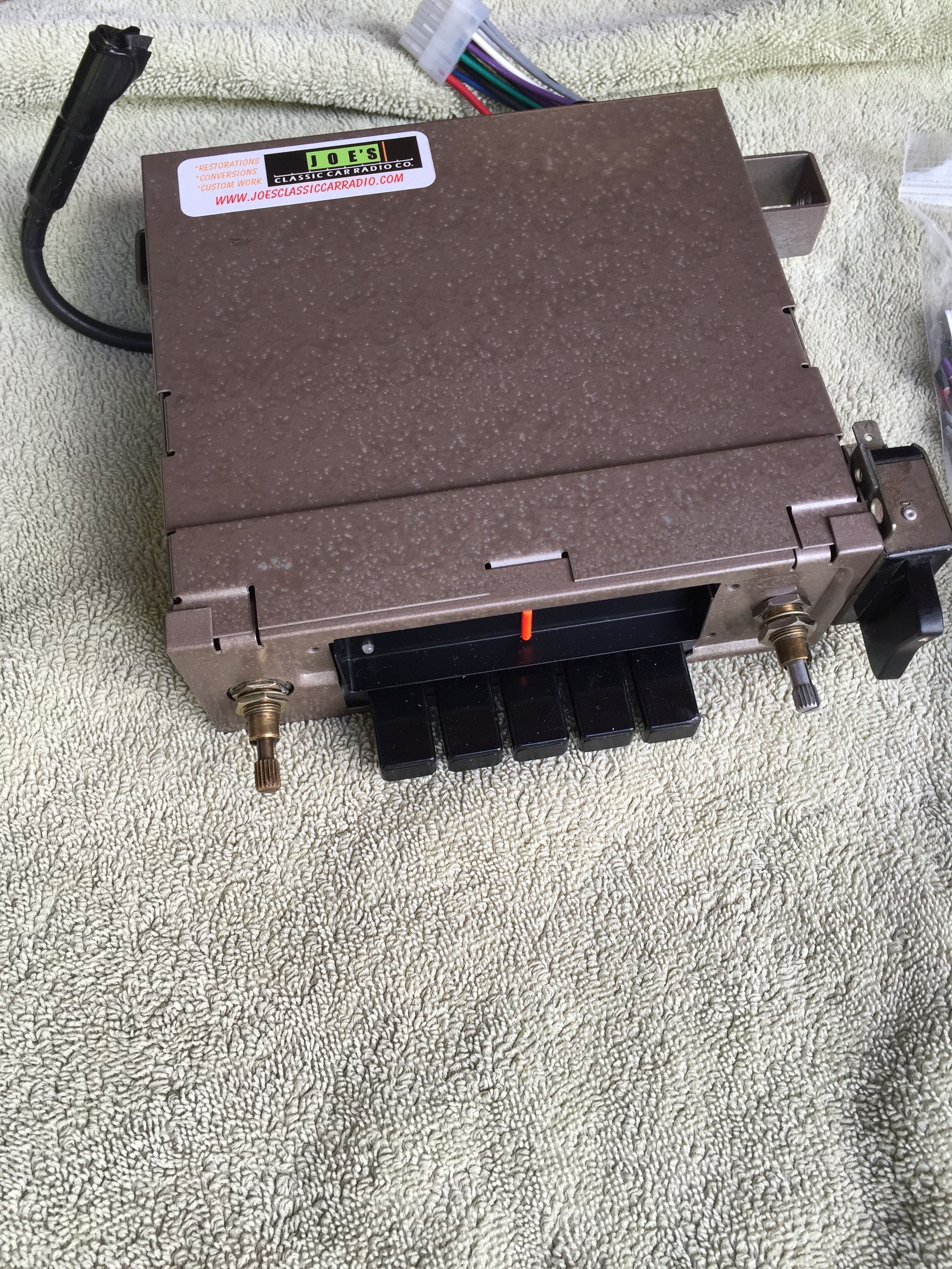

Just received my series I original non working radio back after having it converted to FMR-2 system. 4 speaker 45W per channel plus " sub out "and an "aux in". Had a Blue-tooth option but didn't add it.
Had the same thing done to a Wonder Bar radio from a 62 C-1 Vette. Work great

I paid $395.00 without the blue tooth adapter.  Same vendor did the same conversion earlier this year on a Wonder Bar radio for 62 vette.
This gives me a completely stock look with both AM/FM search and ability to attach my iPhone to play Pandora or stored music or pod casts. Or attach iPod..etc. Capable of driving four speakers without an amp. I currently have speaker kick panels with Tweeter mounted in the Air Vents for directional control. Planning to add an 8 inch amplified sub under passenger seat and two rear speakers.
