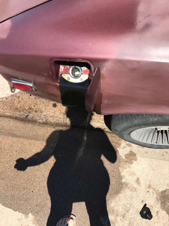

Posted May 6, 20178 yr comment_520068 Hey guys I don't know if you can help me out. I bought this car about 3 weeks ago and the fuel system seems to be a big problem. Every time I go to gas it up if I don't take 20 minutes to slowly fill it up gas spills out of the tank from where I am filling it. I fixed the pressure problem it had by getting a new ventilated cap from the auto store but it still spills and when I tracked my mpg's I'm getting barely 10 to the gallon on a car recommended at 22. Also I can smell unburnt fuel whenever I'm driving so I feel like I have a leak somewhere but I just don't know where or what to do. I appreciate the helpI have a 1977 Datsun 280z Sent from my iPhone using Classic Zcar Club mobile Link to comment https://www.classiczcars.com/forums/topic/57652-fuel-spilling-out-if-tank-and-about-9-miles-to-the-gallon/ Share on other sites More sharing options...

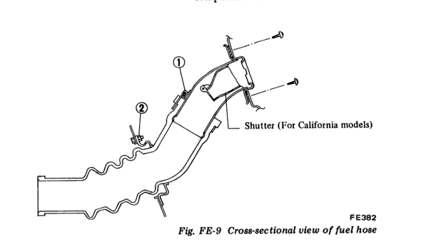

May 6, 20178 yr comment_520073 Fuel filling problems are often caused by a problem with the vent air return hose that T's into the filler hose near the top. Air has to escape out the vent line as the tank is filled BEFORE the nozzle of the filler, or the air will try to escape back out the main fill hose triggering the release on the gas station knozzle. Chances are you have broken cracked vent lines. Link to comment https://www.classiczcars.com/forums/topic/57652-fuel-spilling-out-if-tank-and-about-9-miles-to-the-gallon/#findComment-520073 Share on other sites More sharing options...

May 6, 20178 yr comment_520076 Venting problems do sound likely if you have the unleaded "shutter". But even most shutters have vent holes built in to them. Somebody with a 77 or 78 filler style would know better. On my 76 you can look directly down and see your reflection in a pool of gasoline in the tank. Link to comment https://www.classiczcars.com/forums/topic/57652-fuel-spilling-out-if-tank-and-about-9-miles-to-the-gallon/#findComment-520076 Share on other sites More sharing options...
May 6, 20178 yr Author comment_520077 Ok well I was going to get you guys some pictures to update on what my tank looked like and my hatch and apparently in the Colorado heat sunny and 84 degrees I opened my gas cap and a good portion of gas soaked me, my keys and my streetSent from my iPhone using Classic Zcar Club mobile Link to comment https://www.classiczcars.com/forums/topic/57652-fuel-spilling-out-if-tank-and-about-9-miles-to-the-gallon/#findComment-520077 Share on other sites More sharing options...

May 6, 20178 yr comment_520083 You have the unleaded style, with a little flap that the gas nozzle pushes open. But air should vent out above the gas nozzle as fuel enters. Poke the little flap open with a screwdriver and take a look. The sun is at a good angle in your picture. Take a closeup with the little flap open if you can, might be easier to blow up a picture to see something. Link to comment https://www.classiczcars.com/forums/topic/57652-fuel-spilling-out-if-tank-and-about-9-miles-to-the-gallon/#findComment-520083 Share on other sites More sharing options...
