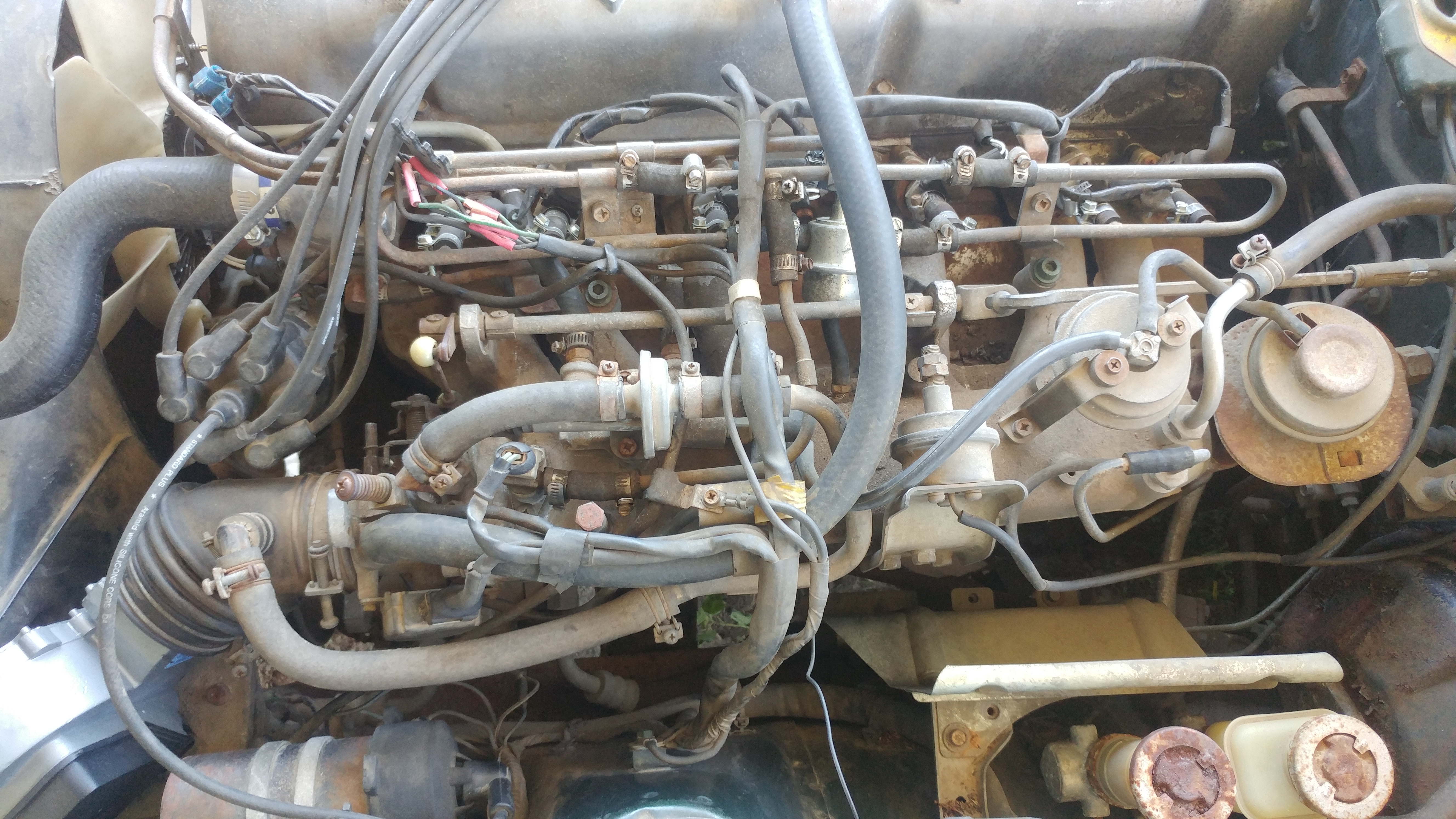

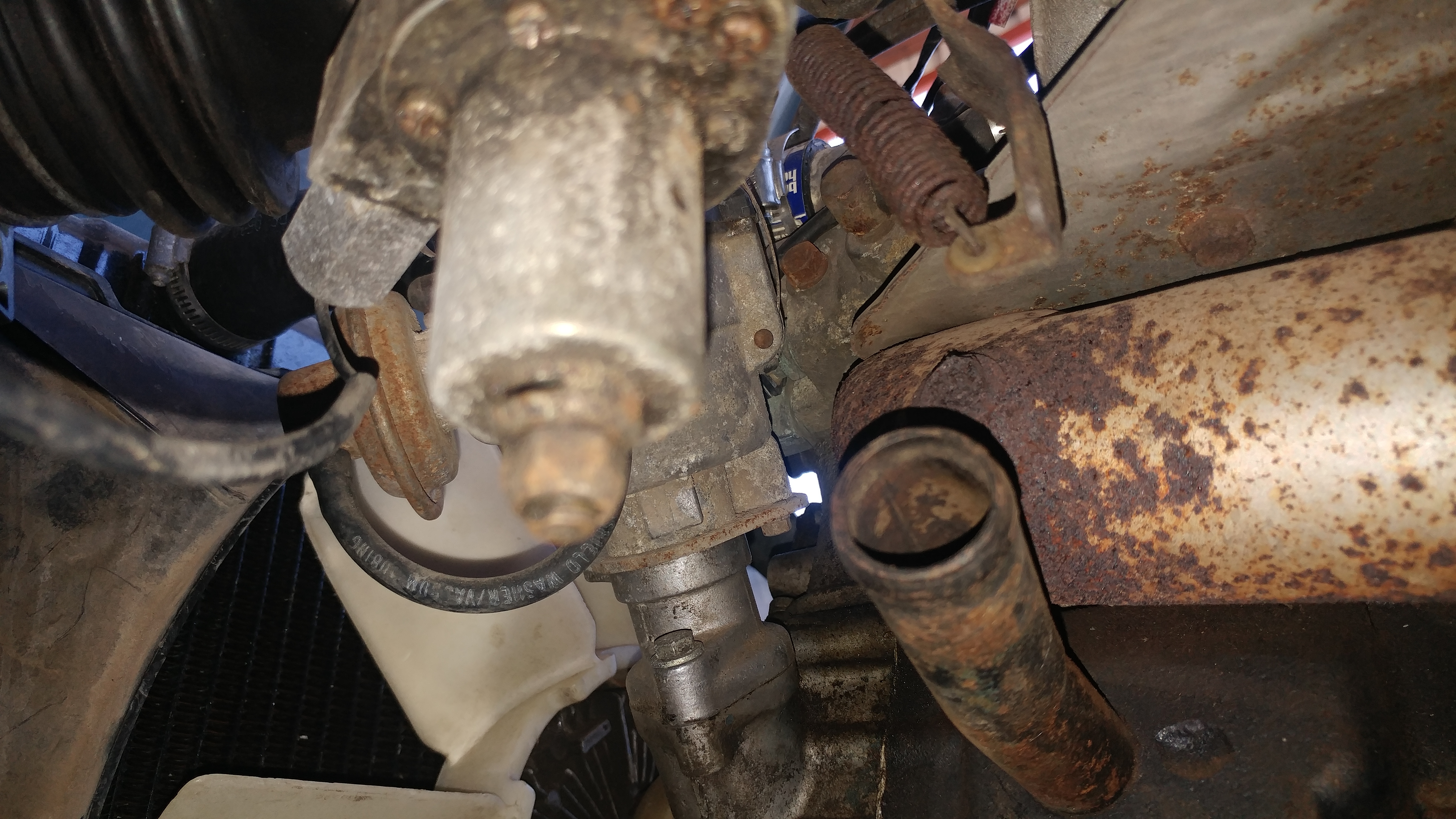

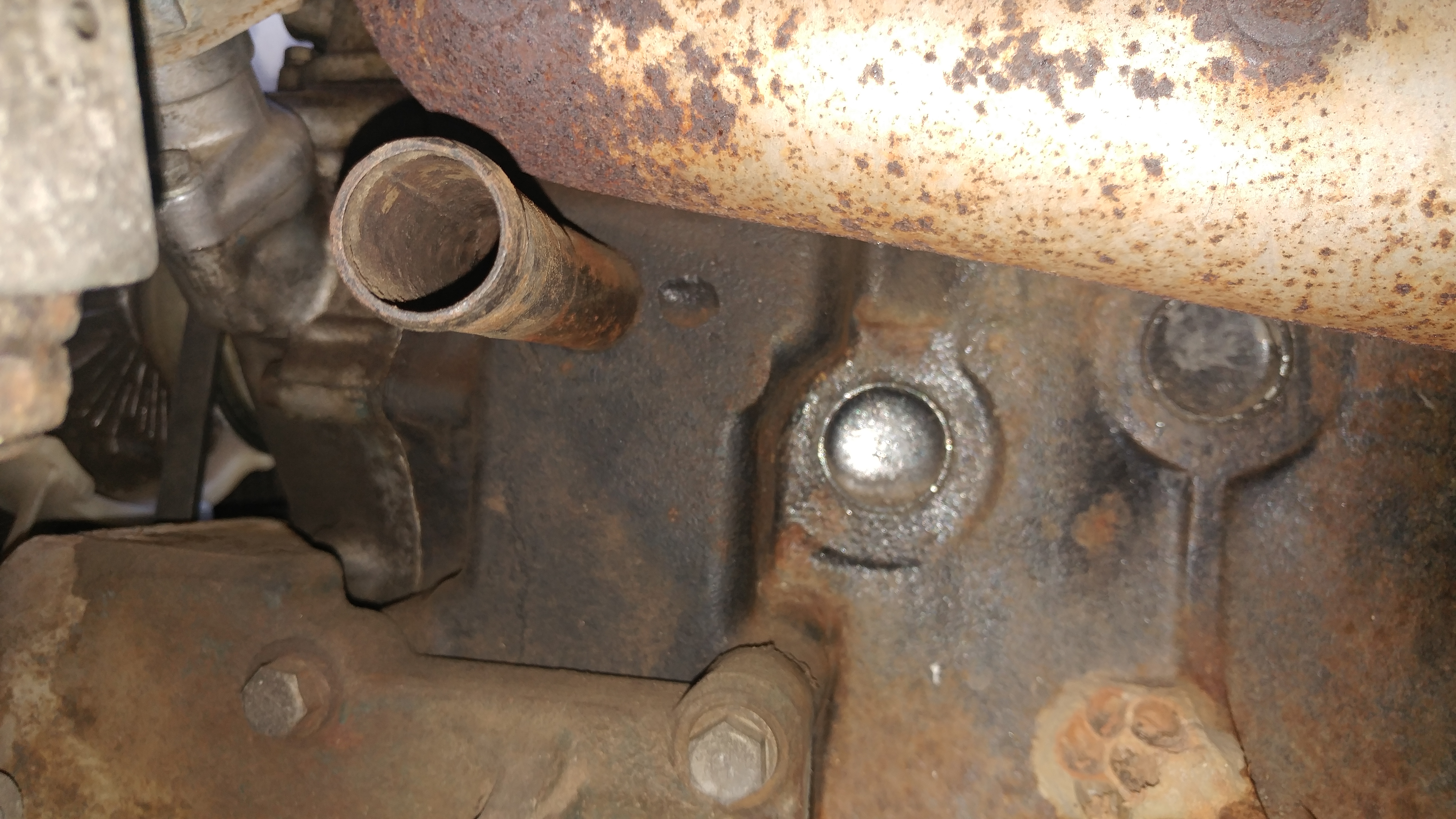

So I did find a vacuum leak. A rather big one at that. The first picture is a hose that's directly under the intake manifold. The picture might be upside. The second picture is of my current setup. Where dose the hose in the first picture go? If I hold my finger over the hole the idle gets real rough. The third picture is of what I assume to be the PCV valve
That is the positive crankcase ventilation (PCV). It should go to your intake.
Download a copy of the FSM if you haven't already. The link is in my signature. The information to start you off is in the EC section.
There should be a hose from that tube that has a steel mesh (anti backfire) near the tube and a PCV valve at the other end of the hose. The PCV system should go into the intake downstream of the AFM, so if it open, you have a big vacuum leak in your intake.
The PCV valve is screwed up in to the bottom of the intake manifold, about centered, away from the engine.  There's a space in the heat shield for it.  It would be to the right in your pictures of the crankcase vent tube.  That tube should have a hose running from it to the PCV valve.  We can't see the top of your valve cover.  It might have a little breather on it because somebody deleted the PCV hose.
You're probably lucky that you have a new AFM.  Don't adjust anything on the AFM, get the hoses back where they should be, and you should be back in control, using the idle speed bypass screw on the throttle body.
Good luck finding the hose.  You could probably make a water hose work for a short while, for testing and tuning, but it's a very high heat area and the proper hose is designed for it.
