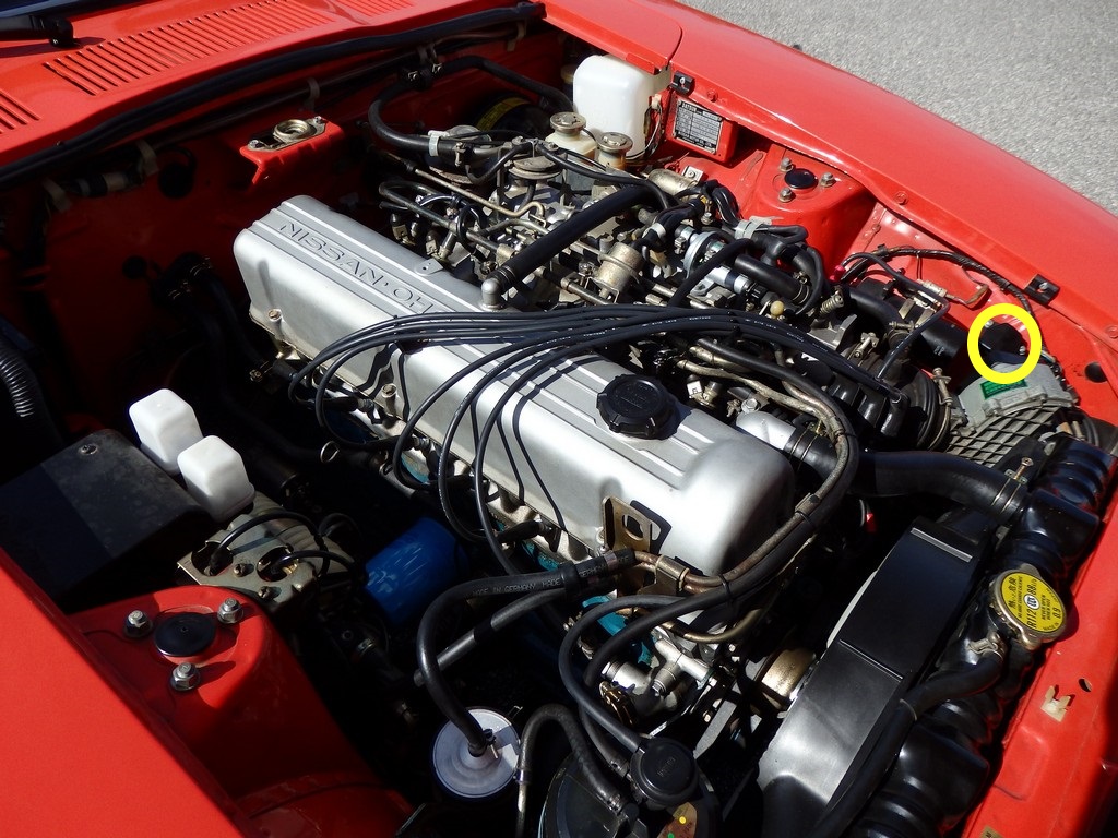

March 1, 20178 yr Author comment_514106 I have tried to identify the mysterious black plastic thing that is screwed to the driver side inner fender forward of the coil. See yellow circle in photo. I haven't found it through searching, since I don't know what to call it. I tried to open it last night while working on the car, thinking it might be a junction box of some sort (trying to avoid having to unplug all of the injectors). I figured out it's potted, and can't be opened. But what is it? If it has something to do with the fuel pump, it might explain why mine quit working. Unfortunately, during the compression testing, I paid no attention to the fuel pressure. So I don't know exactly when it quit.  Link to comment https://www.classiczcars.com/forums/topic/56998-engine-rough-running-at-wits-end/?&page=6#findComment-514106 Share on other sites More sharing options...
March 1, 20178 yr comment_514113 It is a junction type box I guess. Â The green and red wires from the distributor connect with the green and red coming out of the wiring harness. Â It can be opened from the top, it's hinged at the bottom, by pushing in this little clip you'll see. here you go, I had it backwards above ^^^^^^. Â Edited March 1, 20178 yr by siteunseen Link to comment https://www.classiczcars.com/forums/topic/56998-engine-rough-running-at-wits-end/?&page=6#findComment-514113 Share on other sites More sharing options...
March 1, 20178 yr comment_514117 1 hour ago, the_tool_man said:  I tried to open it last night while working on the car, thinking it might be a junction box of some sort (trying to avoid having to unplug all of the injectors). I figured out it's potted, and can't be opened. But what is it?   Unfortunately, during the compression testing, I paid no attention to the fuel pressure. So I don't know exactly when it quit. Are you sure that you're not actually enjoying working on the car more than having it run well?  Are there wires attached to the mysterious box?  You didn't mention them.  And if you can't get it open, then how can you know it's potted?  Just saying. There's a simple test of fuel pump operation that get's mentioned about ten times a month.  Remove the starter solenoid wire and turn the key to Start.  Although, you say that you've lost pressure but haven't mentioned if the fuel pump is operating. You have a lot of good information in your threads.  If you could just get them in order the cause of the problem would probably show up.  You're jumping around from thing to thing, and some of them don't really fit a good diagnostic method.  Like why would you be unplugging all of the injectors?  Seriously, once you've tried the obvious things and haven't found a solution, it works best to go through the basics, in an orderly fashion.  The car looks very clean and original (unless that's a car from the internet).  Doesn't seem like there is much wire hacking, you even have the original rubber cap on the coil, so the basics should work to solve the problem. Link to comment https://www.classiczcars.com/forums/topic/56998-engine-rough-running-at-wits-end/?&page=6#findComment-514117 Share on other sites More sharing options...

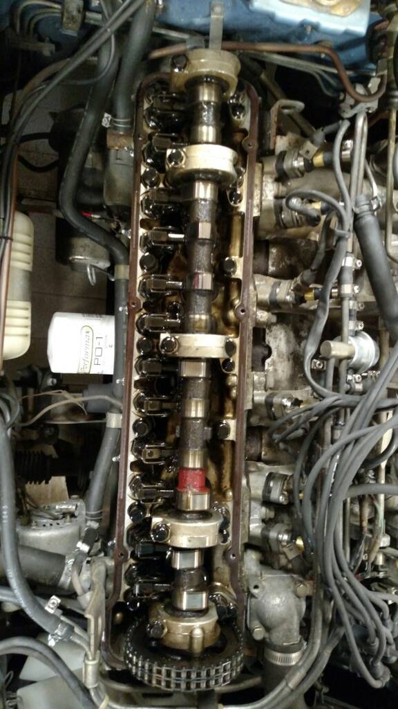

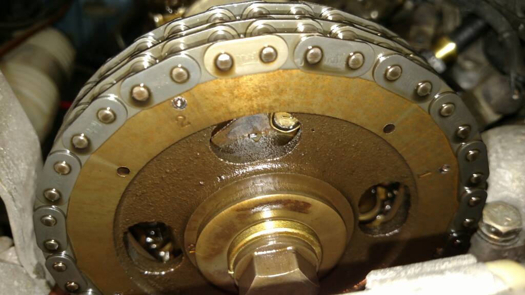

March 3, 20178 yr Author comment_514284 Tonight I pulled the plugs, cleaned them and gapped them to .038". I pulled the valve cover and checked the valve lash. All were in spec. While I had it open, I rotated it to put #1 at TDC and verified the cam timing was correct. I checked the torque on the head bolts. They were all tight. Does the red on the camshaft mean anything? Then I buttoned it all back up and started the engine. I pulled each plug wire in succession to see if the idle changed. The idle is so rough that it was hard to tell. But it seemed as though #2, #4 and #5 made a difference and the others didn't. I confirmed with a timing light that all plugs are getting spark. Fuel pressure is good. That leaves injectors and vacuum, right? I don't have a stethoscope (I'll pick one up this weekend). And my hearing is shot. So I've decided to just replace all the injector connectors. I already have new ones, since I'd planned on swapping them anyway (boots are disintegrated). As I said, the injectors are brand new. I practiced connector pin removal tonight at the kitchen table. I also borrowed a fog machine to test for vacuum leaks. I'll play with that this weekend.  Sent from my XT1254 using Classic Zcar Club mobile       Link to comment https://www.classiczcars.com/forums/topic/56998-engine-rough-running-at-wits-end/?&page=6#findComment-514284 Share on other sites More sharing options...
March 3, 20178 yr comment_514288 Hey, I was wrong in my post about your 1977 ignition system. Â Nissan was setting plugs at .040 by then, not the low end like my 76. Â But .038" is fine for what you're doing, not worth going back. Here's a test you can do to see if you have a vacuum leak that maybe somebody tuned around in the past - loosen the oil filler cap and slowly remove it. Â See if the idle speed gets faster or slower, and if the engine dies when it's fully removed. Â It's a simple test, similar to moving the AFM vane, except it makes the mixture leaner. The other test you can do is to either remove the hose from the AFM and push the vane open, or remove the black cover on the side of the AFM and move the weight to open the vane. Â The black cover pops off with a flat blade screwdriver, but is sometimes sealed with silicone. Â If it has a large amount of silicone then somebody has already been in there and may have messed up your AFM tuning. Â Opening the vane tells the ECU that more air is entering and it supplies more fuel, making the mixture rich. Â The amount of air is controlled by the throttle blade so don't think that you're allowing more air in, you're just fooling the ECU. Since you've confirmed all of the timing events and compression and the engine should run right if the fueling is right, these two tests might tell you if you're running lean or rich. Â If you can get it to run better by changing the fuel-air ratio then you'll have a target to shoot at, making the mixture leaner or richer, or fixing vacuum leaks. Â Good luck. Link to comment https://www.classiczcars.com/forums/topic/56998-engine-rough-running-at-wits-end/?&page=6#findComment-514288 Share on other sites More sharing options...
