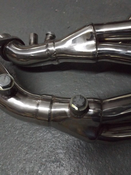

I had a set of S50B32 headers here to compare (you know why Franky) :
38mm primary pipes (makes me laugh when people say they 'must' have 44s, 48s, 50s for their Z!) and twin 50mm secondaries.
Diameter
lenghth
so many variables.  the sb50b32 is a good setup though.  for that application.

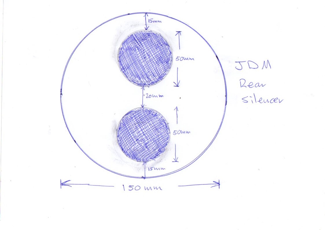

Hi Sean, these are the dimensions measured roughly, excuse the diagram. Might be suitable as a big bore option for your line of exhausts.
Reinhard stopped selling them separately after I got this in 2013. A few Aus guys tried buying them but they would only sell the entire system.

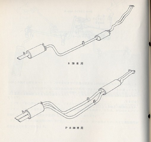

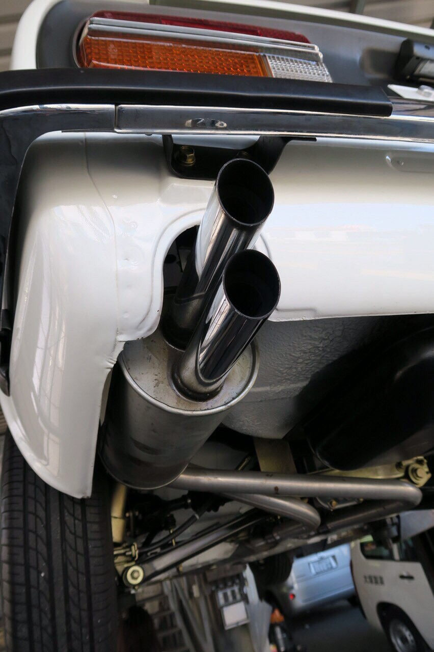

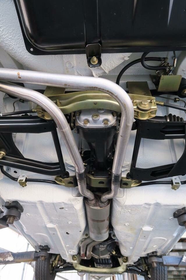

2x JDM exhaust photos and note the drawing (thanks Alan T) - especially the longer resonator !
My 'JDM' muffler of which the 'box' is 380mm long with a 100mm long entry pipe.
Exit pipes are 180mm long (top) and 150mm (lower) at maximum lengths (on the top of each tube).

No, I don't think that Nissan would have left that detail in if unused. Much more likely to have allowed the use of the 'Z432' twin-pipe system as a JDM sports-option for L-series engines.

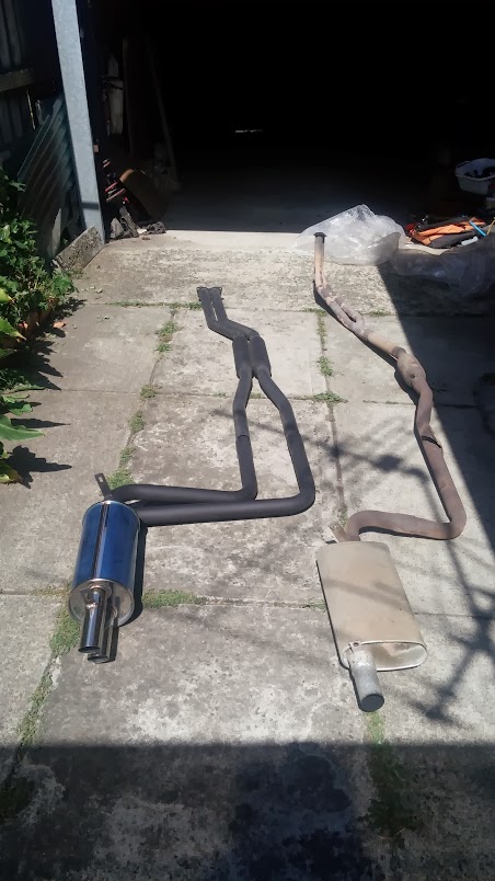

What are these two, Sean? The one on the left is aftermarket. Looks like a stainless Spirit Garage item to me. The one on the right looks like one of the old MSA systems.
