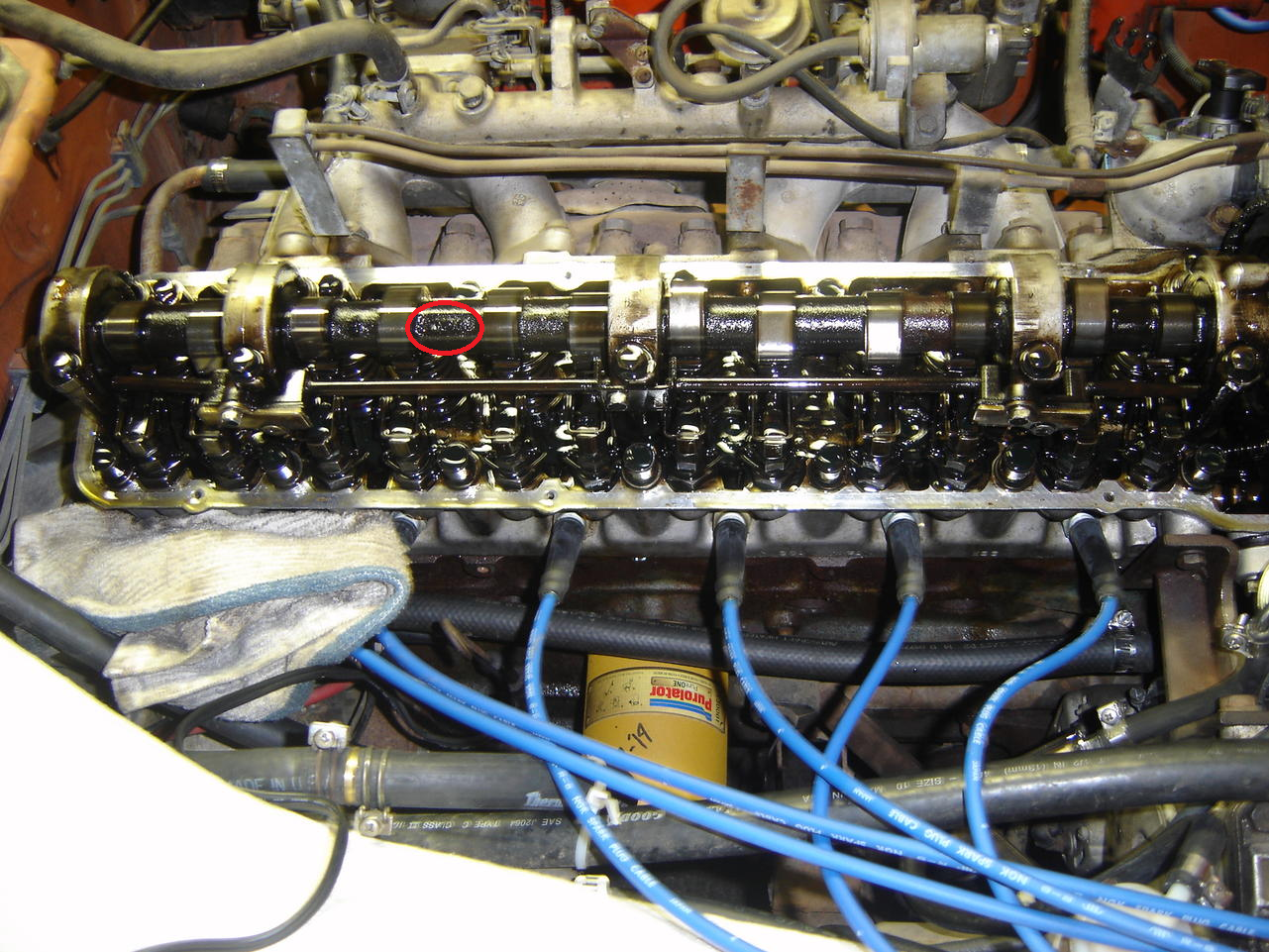

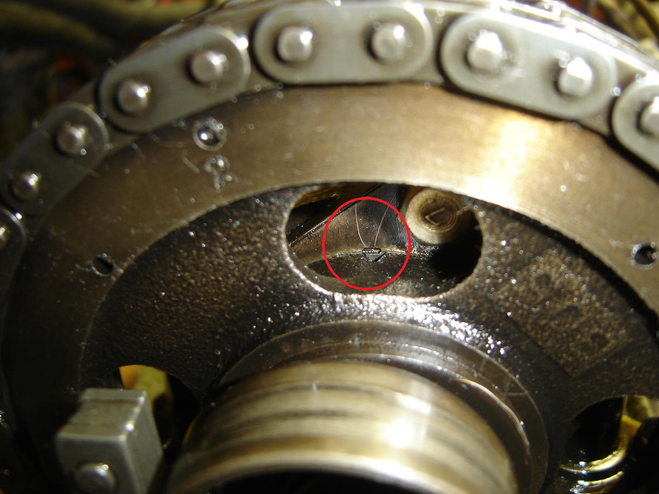

Here's the original E88 head on my 2/'72 when I first bought it, I was having the same problems you are.  The original sprockets have 4 oblong holes.  And my cams have a rough edge too, they'll scratch your fingernail.  Original cams are stamped "JAPAN" where the red circle is, mine's kinda dirty and hard to make out from the picture.
Here is my thread on everything lining up for the timing, and some comments on moving the chain to fudge the timing. :)

The cam should have JAPAN and E30 in raised lettering in between #8 and #9 lobes, I went downstairs and looked up close.

Thanks for the photos. I definitely did not see that notch as I rotated the cam 360 degrees. It looks like my cam was freshly cut hence the rough edges on the cam. I'll check when I take the cam cover off.
It looks like my camshaft was freshly cut hence the rough edges on the side of the lobes. I'll check when I take the cam cover off.
Edited by hatepotholez

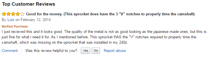

I remembered some past comments about sprockets that didn't have a notch.  I thought that they were Cloyes brand so I searched around and found a comment on Amazon about the S462, which is the L6 sprocket.  The comment doesn't support that it was Cloyes but does mention that he had a sprocket with no notch.  So they are out there.  Probably just an oversight or a manufacturing mistake.
The sprocket is fairly easy to replace (if you don't drop the chain).  If you have a used one with the notch, it might be worth a few minutes to swap them out, just to see.
