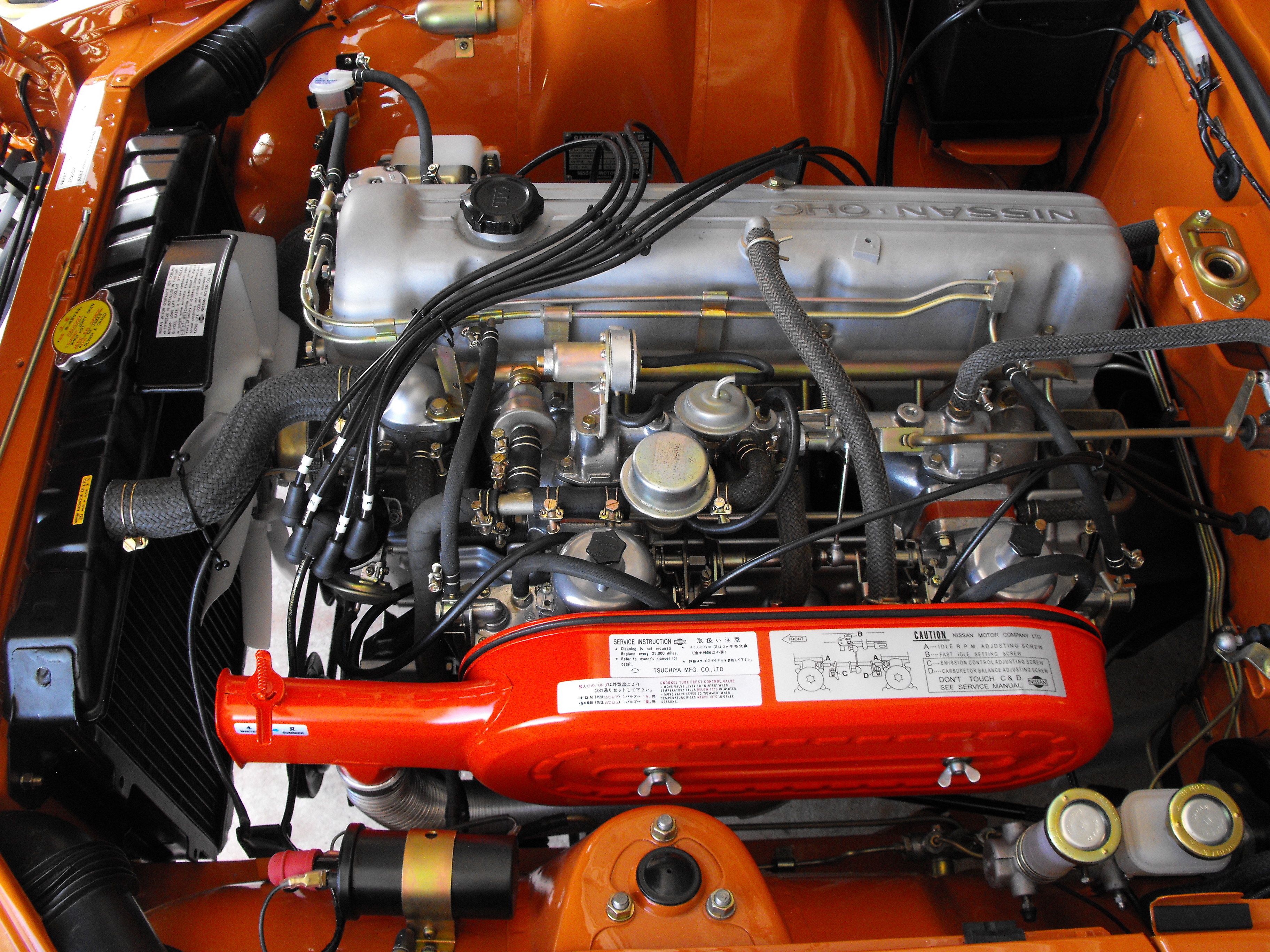

Here are the latest motor pics.  Got the final decals on and voltage regulator cover.

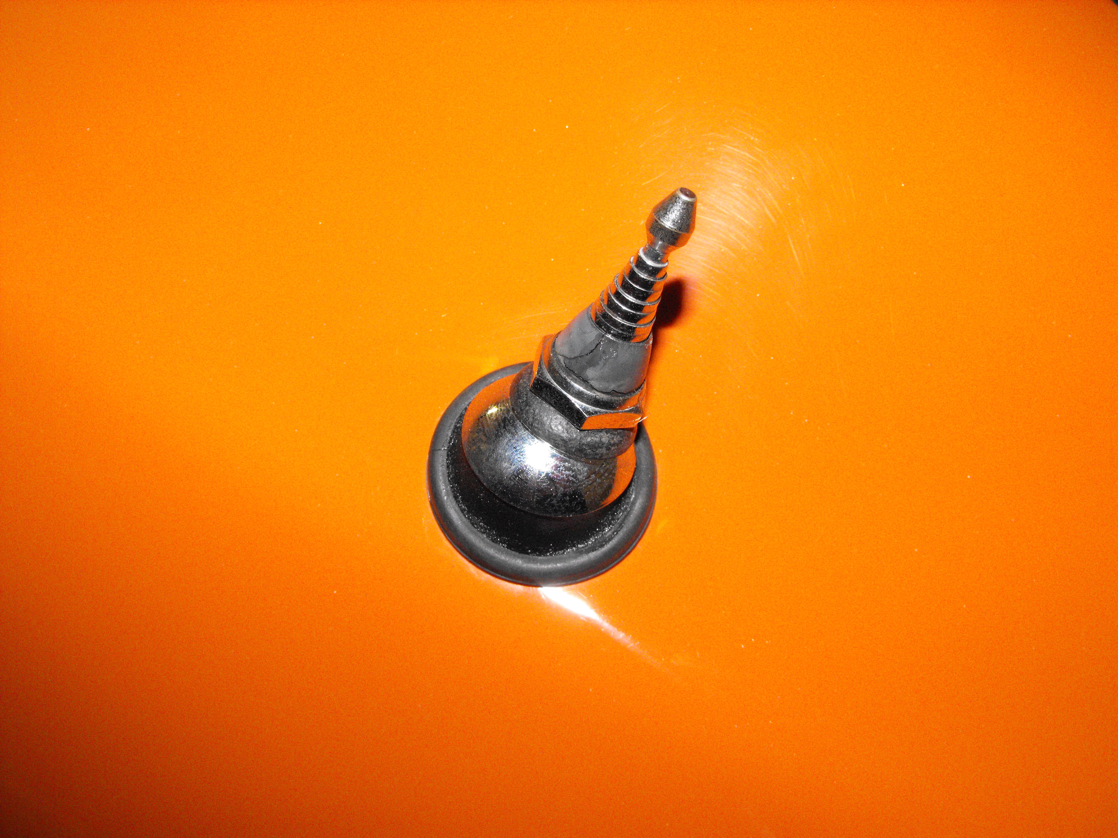

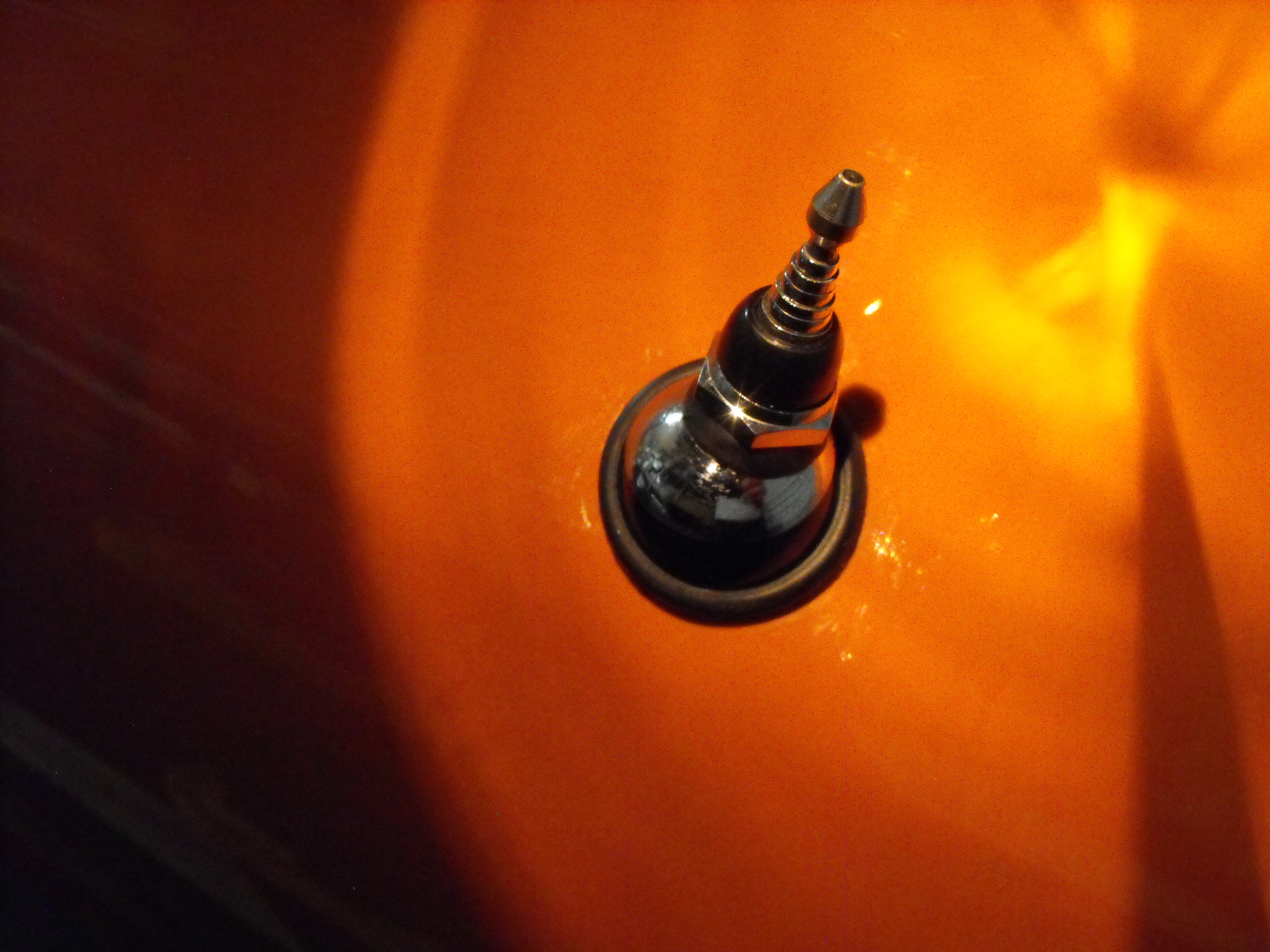

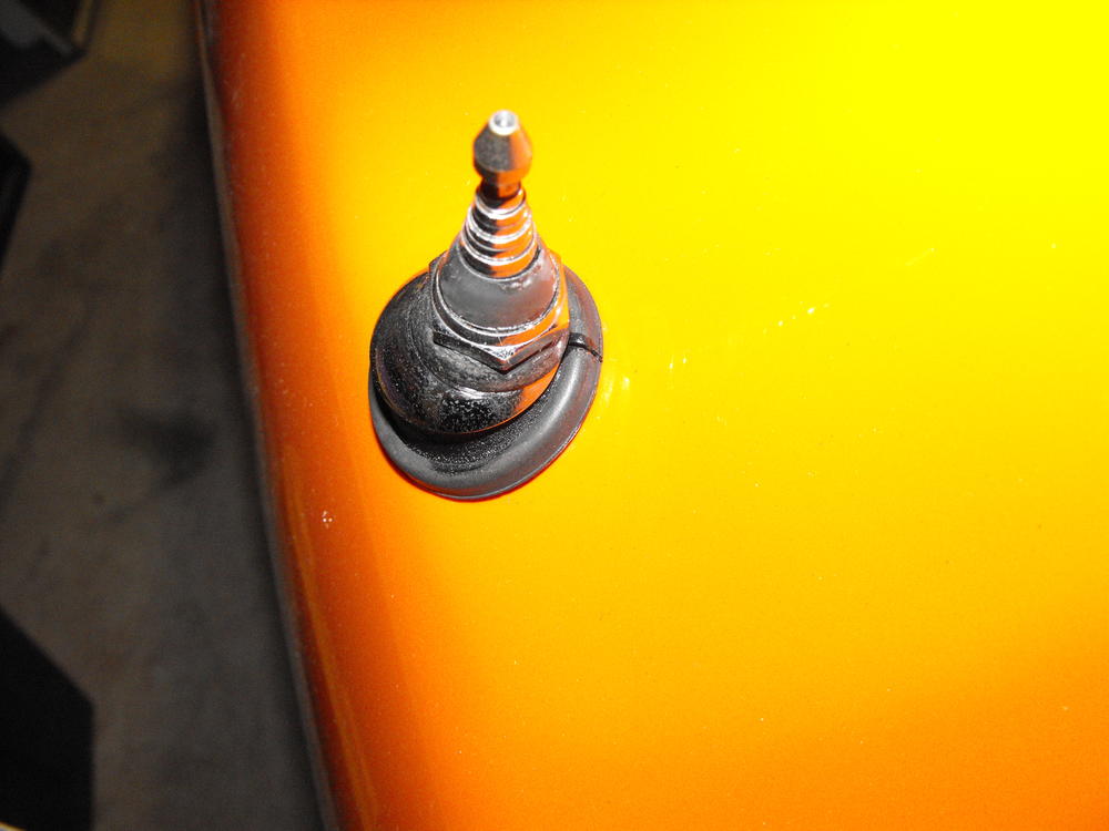

Got the new antenna parts in.  The originals were cracked and oxidized so picked up the new parts from http://www.240zrubberparts.com/.  Pics below show the old antenna parts and then one with the new parts.

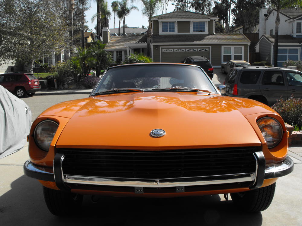

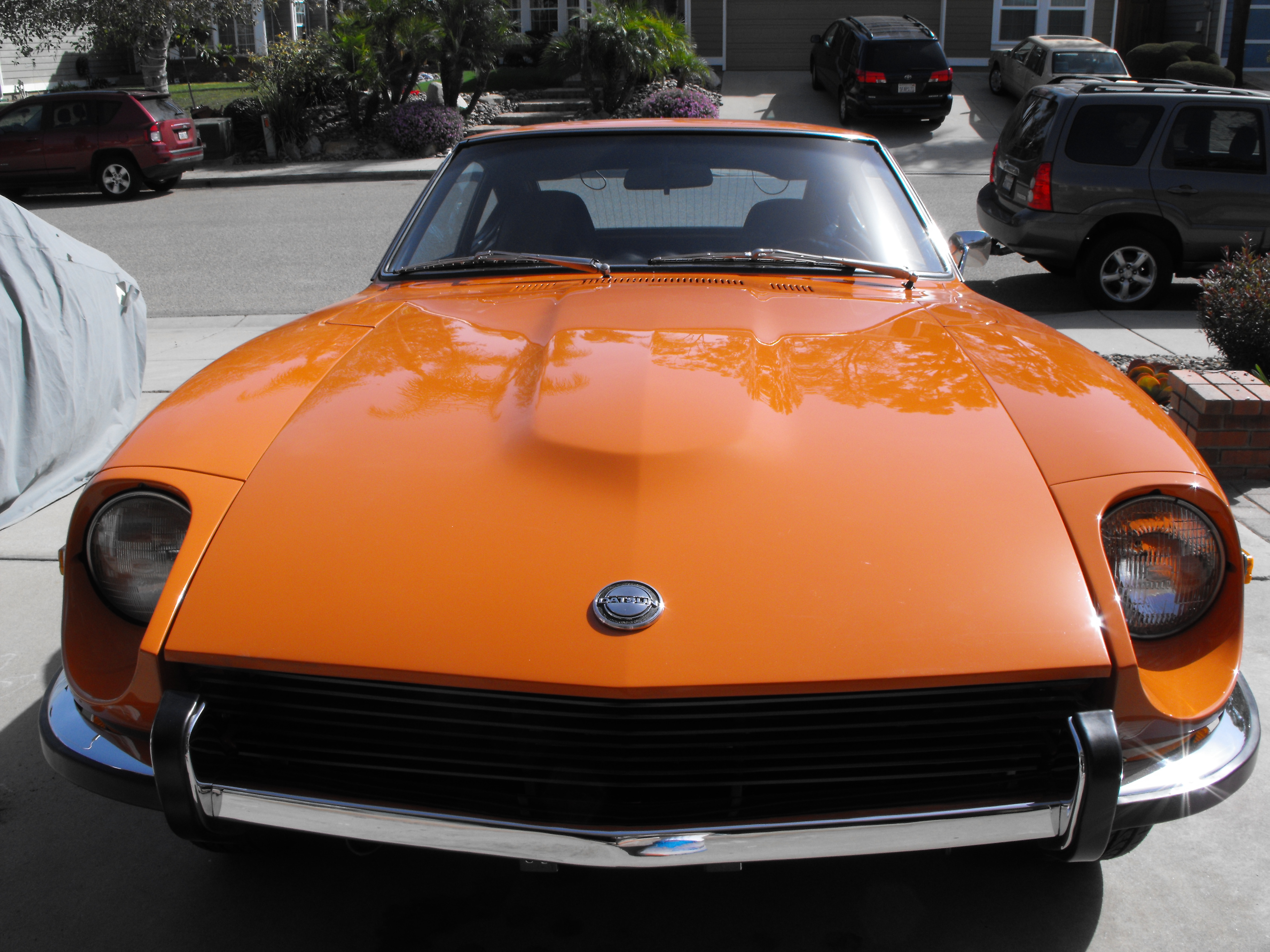

Had a nice sunny day today, so I backed the car out for a couple pics.
