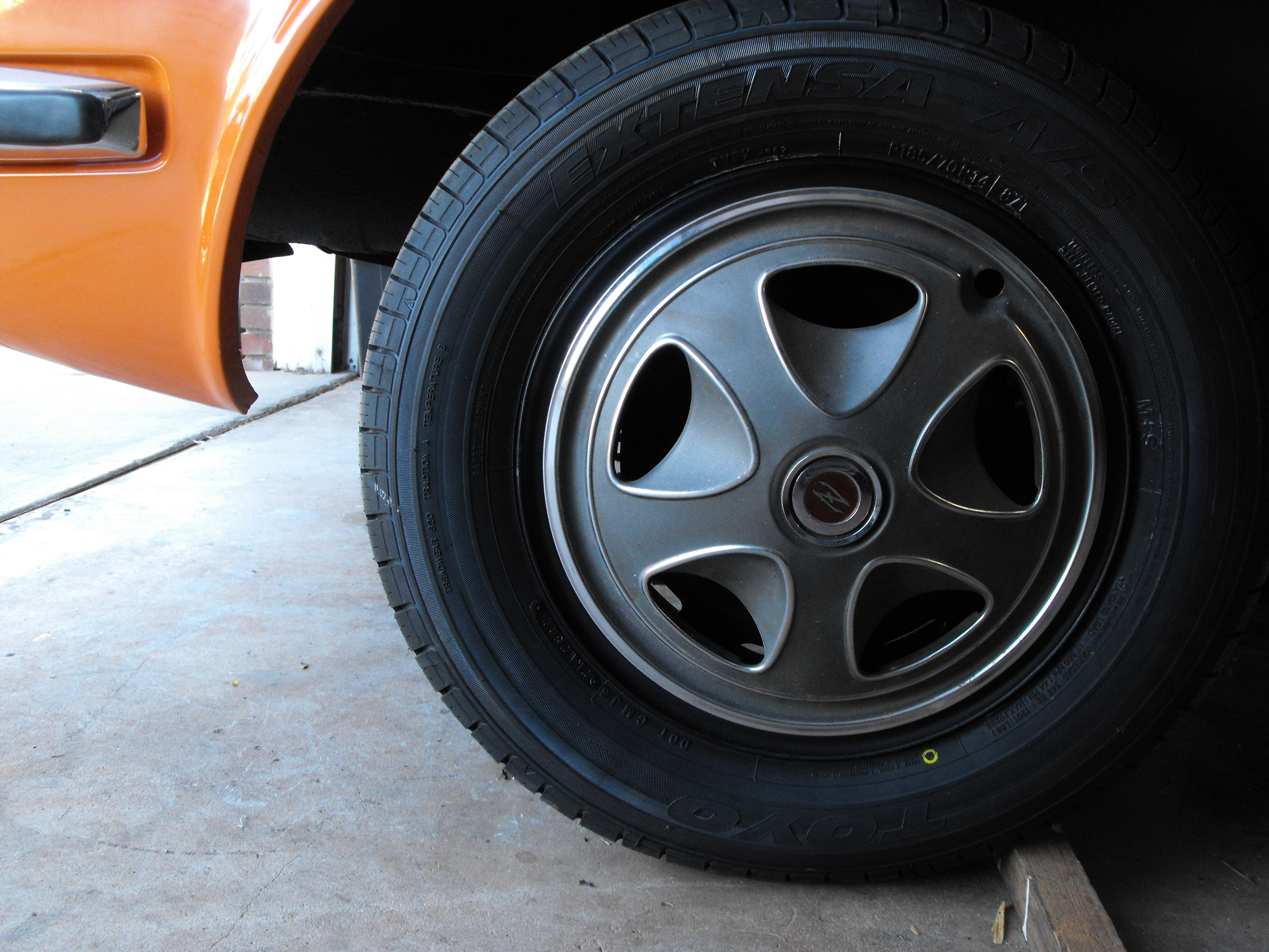

I had the four 'Steelies' powder-coated a matte black and sprayed the backside silver similar to the factory rims. Also got new Toyo's mounted and balanced.   I loosely placed a hubcap on just to see how everything looks.  Hubcap needs a bit of refreshing and a new coat of paint, but otherwise things look good.  I installed the four tires on the car since this is how we will roll :P.

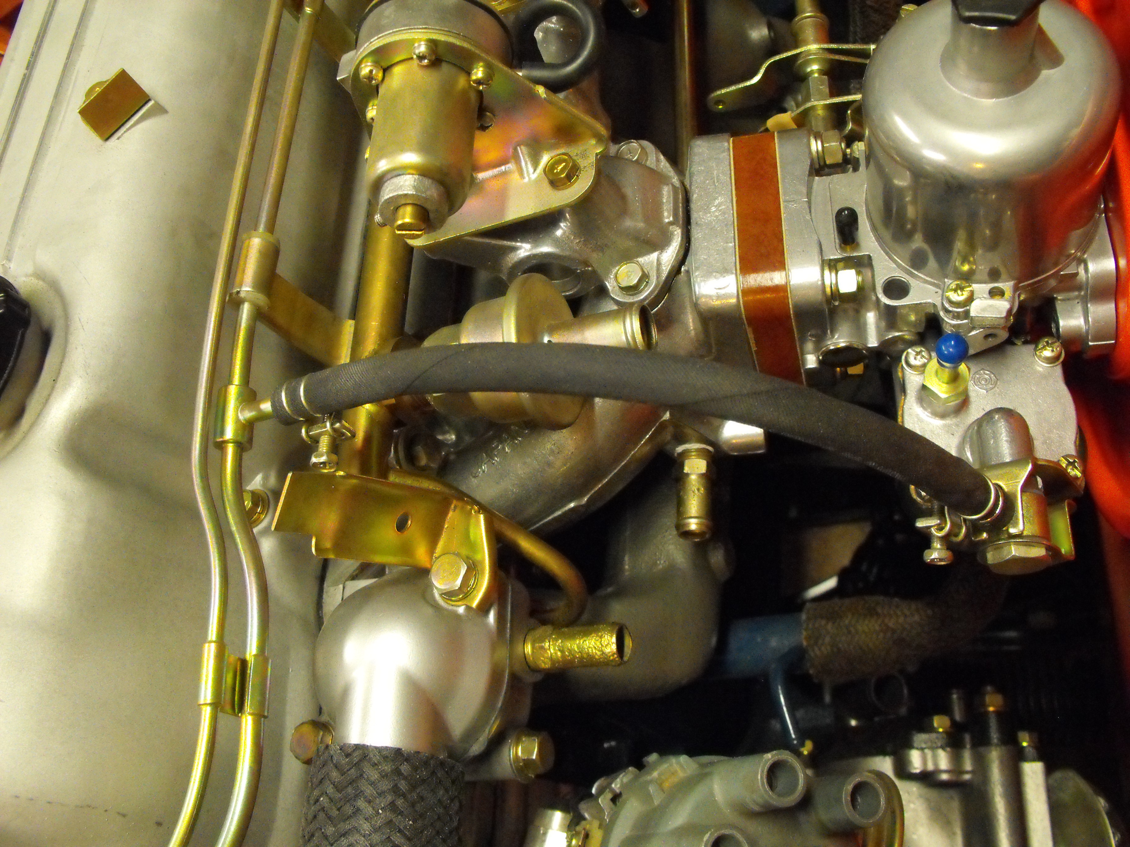

Speaking of JDM, the braided hose came in so I put them in place.  Now I just need the clamps.

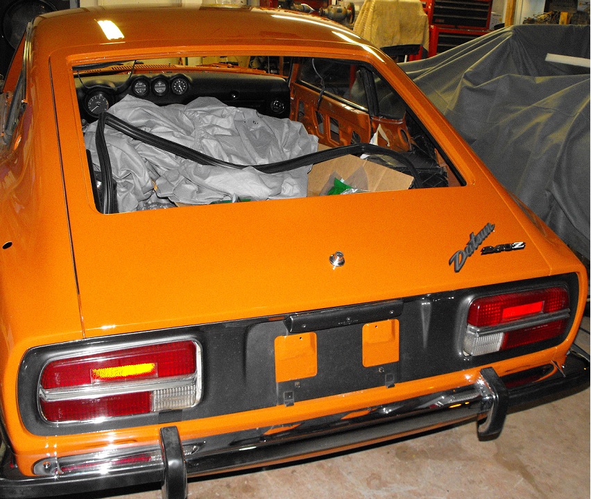

Also got the hatch, hatch seals, hatch hinges and hatch latch installed.  Will take hatch pics when I can get some good light.

Here is a (bad) picture of the hatch installed.  Still terrible lighting since I am using a flash at night.  Should be able to get some nice shots this weekend.  I will have the glass in by then.

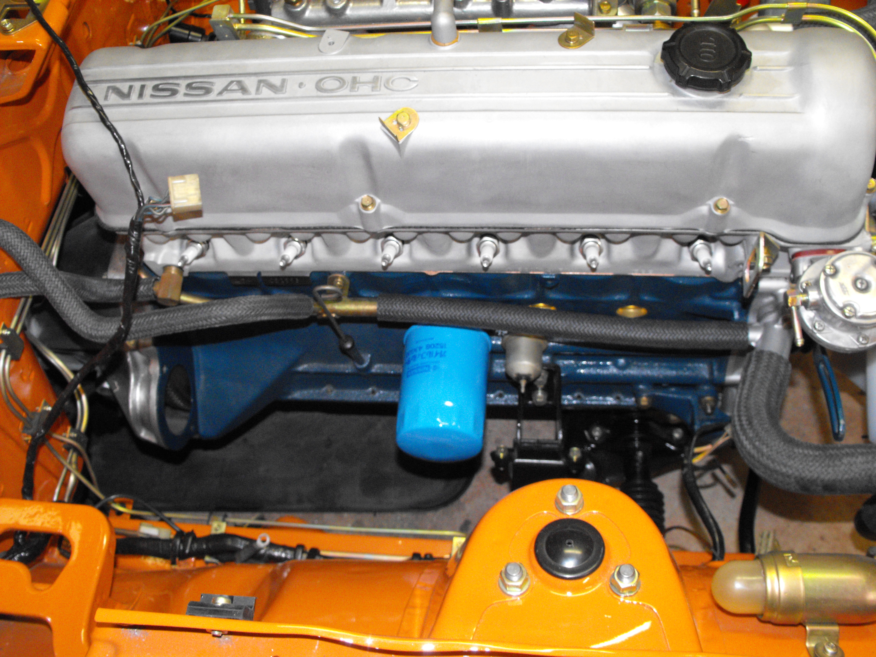

I got the new wrapped fuel hose and I absolutely love it  :love:.   This is the closest match of the original fuel tubing that I have seen. and looks very nice with the wire clamps.  Pics are below.

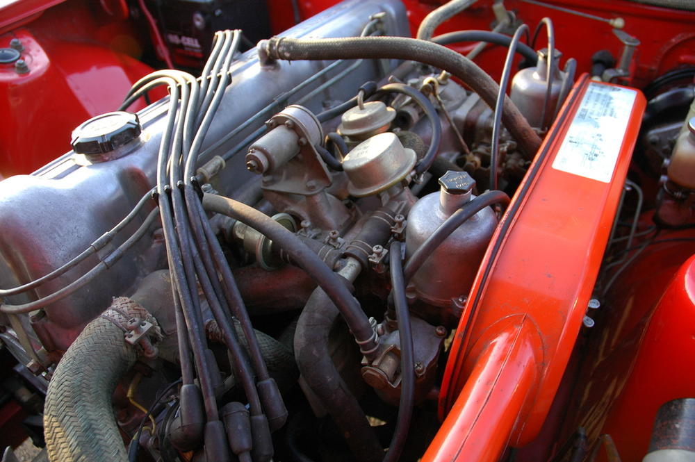

Apologies for jumping in here so late in the game, but I thought that the OE fuel hoses running from the fuel rail to the float bowls (and from the fuel pump to/from the fuel rail) were not fabric covered.  For the three Z's that I've had my hands on (one '70 and two '72's), these hoses were not fabric-covered.  Of course, hose originality can be tough to nail down because they've so often been replaced during the earlier service life of the car.  Maybe others can comment...

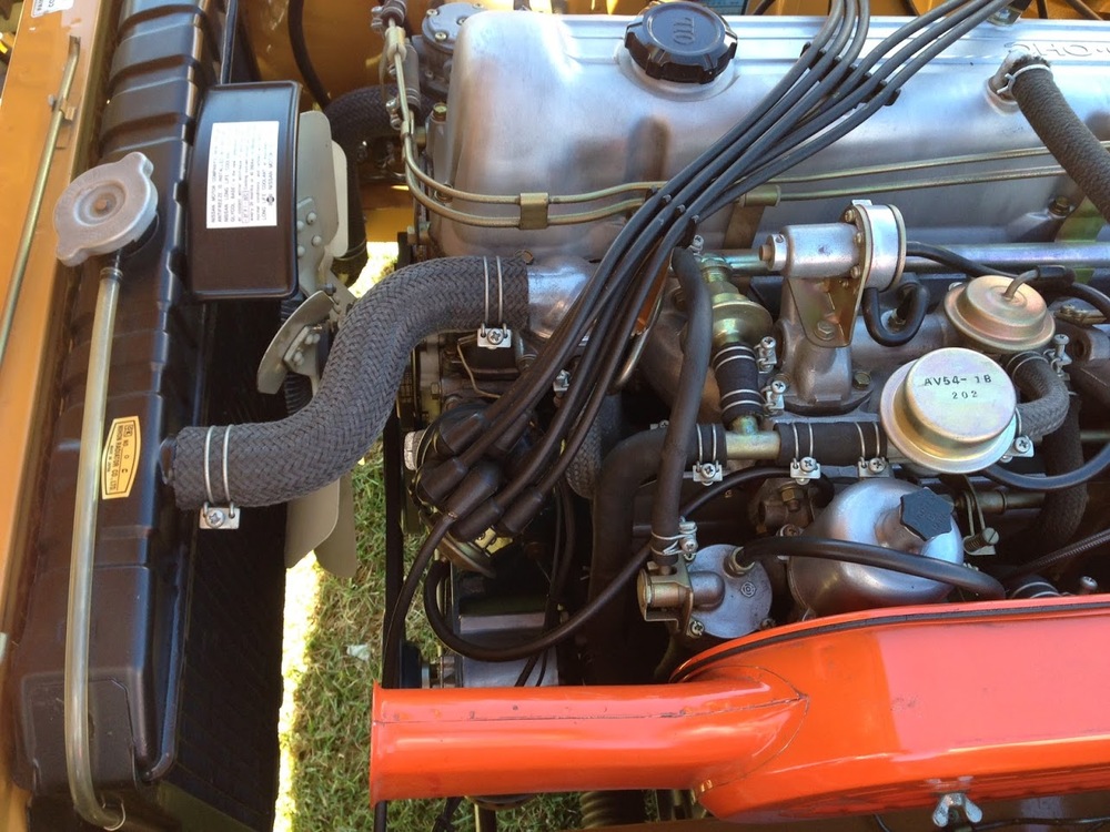

Have a look at this photo of an unrestored Jan. 1971 car.
I am pretty sure that the cloth wrap is the original fuel line.   I use my dad's 1970 240Z as a reference which is for the most part un-restored and has been in the family since day 1 so I know its history.  Also, this thread is a good reference.
Thanks for the pic CanTechZ
