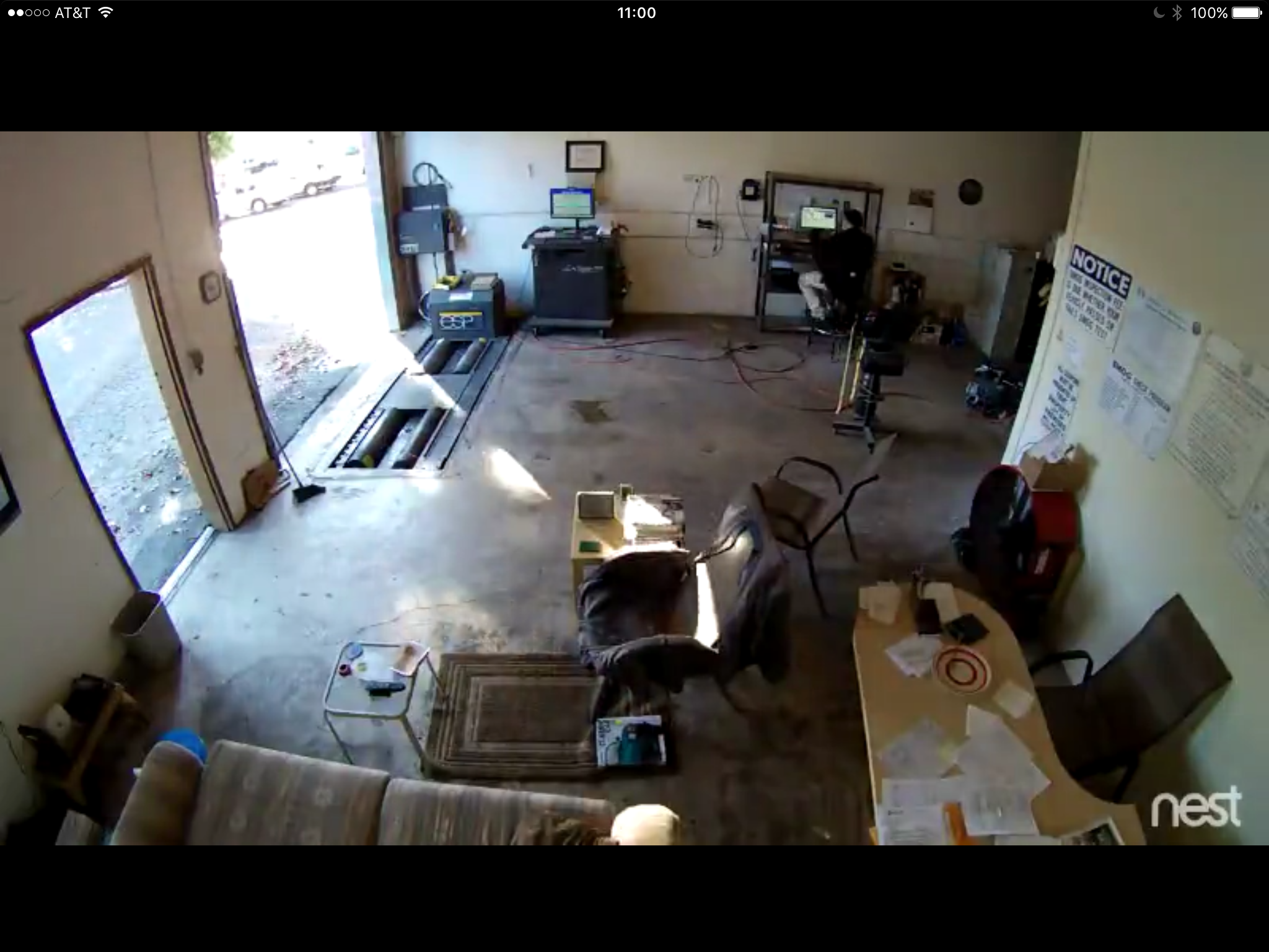

December 16, 20168 yr Author comment_508226 7 hours ago, moelk said: This will be interesting to follow, as all engine builds are. Thanks for sharing. Please put it on a respectable hub dyno when you are all done. What fuel do you intend to use?  I actually own a dyno. It's good for tuning but not for peak HP and Torque numbers. It will measure up to 150 hp and similar Torque. It's great for lap-top tuning though. I own a smog shop in Sonoma California. This little video was taken just a moment ago from my security camera. Seems like the video upload didn't work, so here's a still. Sonoma Smog Center for you guys in the area.  Premium unleaded per Dave Rebello.  Edited December 16, 20168 yr by conedodger Link to comment https://www.classiczcars.com/forums/topic/56686-just-another-damned-project-thread/?&page=2#findComment-508226 Share on other sites More sharing options...
