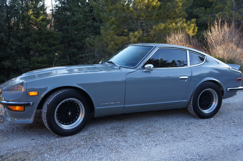

Thanks both of you for the suggestions.  Grannyknot, where did you find those spacers?  That looks like you increased your height by 3/4".  Is it tricky to find spacers to fit the z coils?
It has been a while,... I think I just googled poly spring spacers then found one with a similar diameter and the height I was looking for, I had to cut it to get the step and shaved off the the upper edge to match the stock perch. You will need proper spring compressors to get the shock nut on, I was trying to eliminate the rear end sag that sometimes happens with Eibach lowering springs, this how the car sat with those 3/4" spacers on the rear, to my eye that is the right height for these cars.

I never thought about spring spacers.  They look very well seated on those spring perches.  I really didn't want to go with used 280 shock mounts. My '71 mounts are wore out. Getting some that are 5 years newer from a 280 didnt sound smart.  My car has 60k miles on it so my used springs are probably less used than most other springs so I was hitting a dead end.  I will give that a try.
