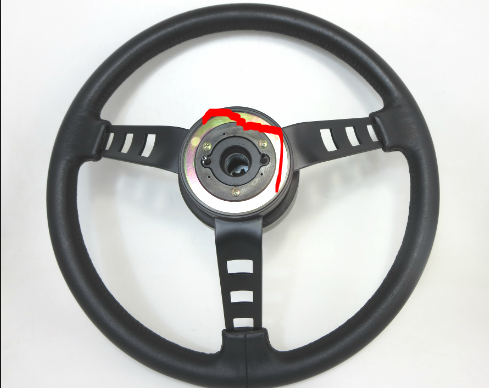

Anyway, the wheel just sits on top of the column.  The signals and everything else are below it.  The horn pad is mounted to the wheel.  It'll work.  The only electrical contact is a round contact on the bottom of the wheel.  A little copper spring-loaded contact slides on it as the wheel turns.
Stole this picture from here - http://jdm-car-parts.com/products/datsun-competition-steering-wheel-with-datsun-horn-pad-for-datsun-240z-260z-280z-510-skyline-and-more

There are differences in how the 280 horn pad and the 240 horn pad mount, but as long as you are using everything from the same year (ish), then there's no problem. Get the 240 steering wheel, the 240 horn pad mounting hardware and stuff, and a 240 horn pad. They'll all work fine together and will fit on any year column.
All the column splines and mounting scheme is the same for all the years.
