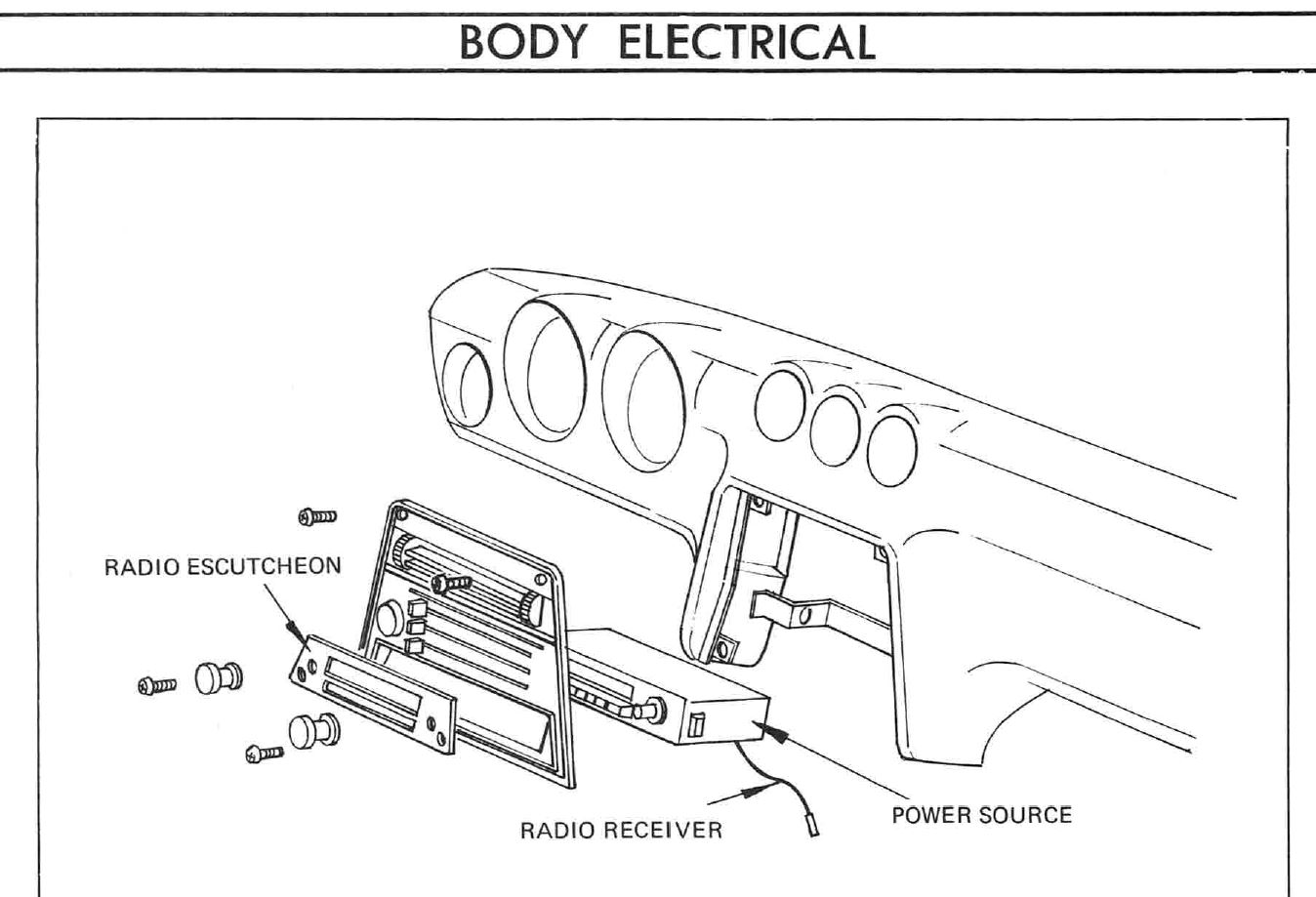

I am currently in the middle of trying to install an auto seeking AM radio in to my 1971 240z.  I did not remove the radio from the car it was in and do not know the order in which everything came off.  I am trying to figure out if the metal plate goes in between the heater control panel and the plastic radio face plate or if it sits behind the heater control panel.  When I have the metal plate in between the control panel and face plate there are not enough threads on the shafts to screw the nuts on to.  Having the metal plate behind the heater panel does not seem to make much sense but I just don't know.  I Googled this several different ways and cannot find the answer and the FSM does not provide this much detail.  If anyone has recently remove the original radio from their car and remembers how everything went I would greatly appreciate any guidance you can provide.  Thank you!

I recently had the heater control panel and radio partially dis-assembled and I don't remember seeing the metal plate you mention.  If I just didn't see it, it was definitely not between the radio face plate and the front side of the control panel.  Can you post  a picture of the metal plate.  Like you said the 1970 FSM is not greatly detailed but on the picture on page BE-25 does not show it. Are sure that plate was not part of a previous after market install.

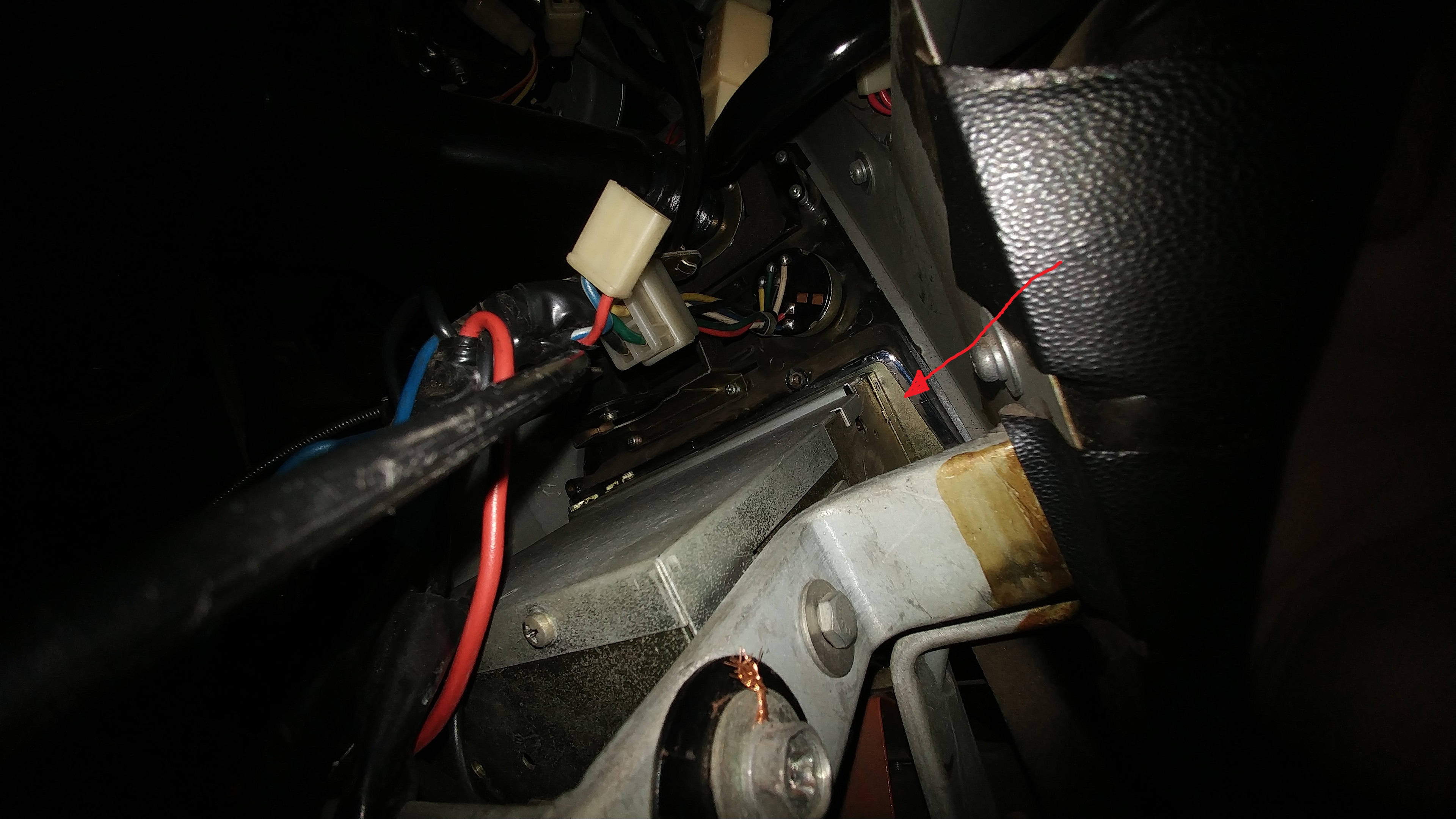

I went out and had a closer look from behind the dash and I think that plate is actually installed on mine, on the inside. Here is a picture where I have marked what I think is the metal plate you are talking about.

When i expanded that picture it looked to me that i was looking thru the dash benzel and the metal plate was in front of the benzel next to the faceplate.

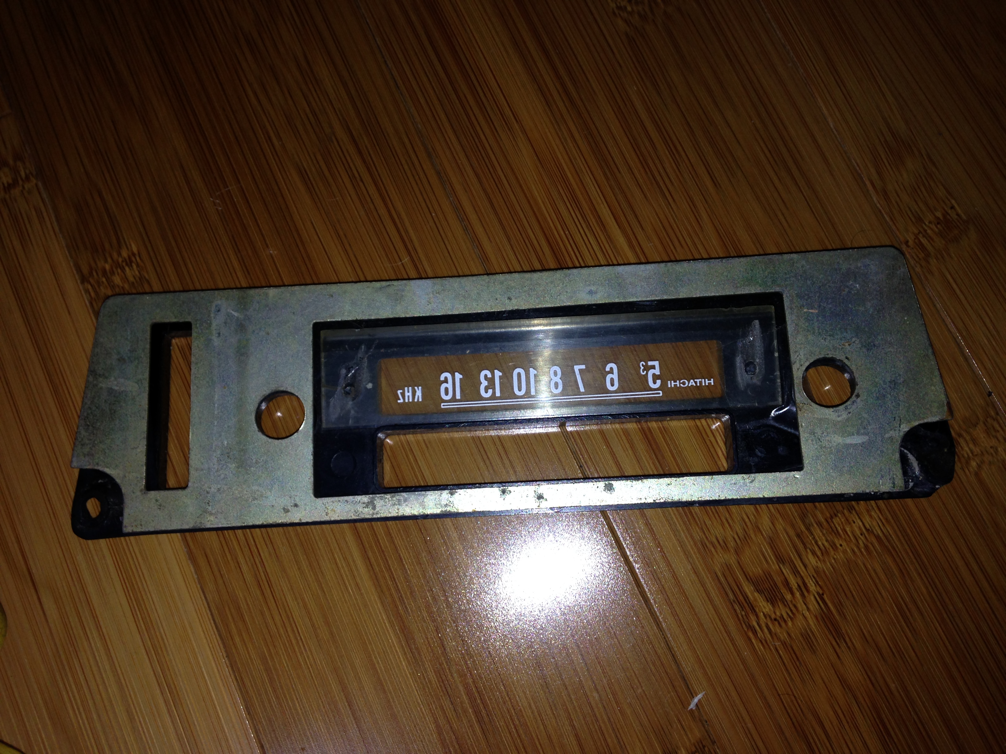

Why would they make the cut-outs for the screws if it was installed on the back side? Do you have a metal backing plate like this or do I have the wrong one?

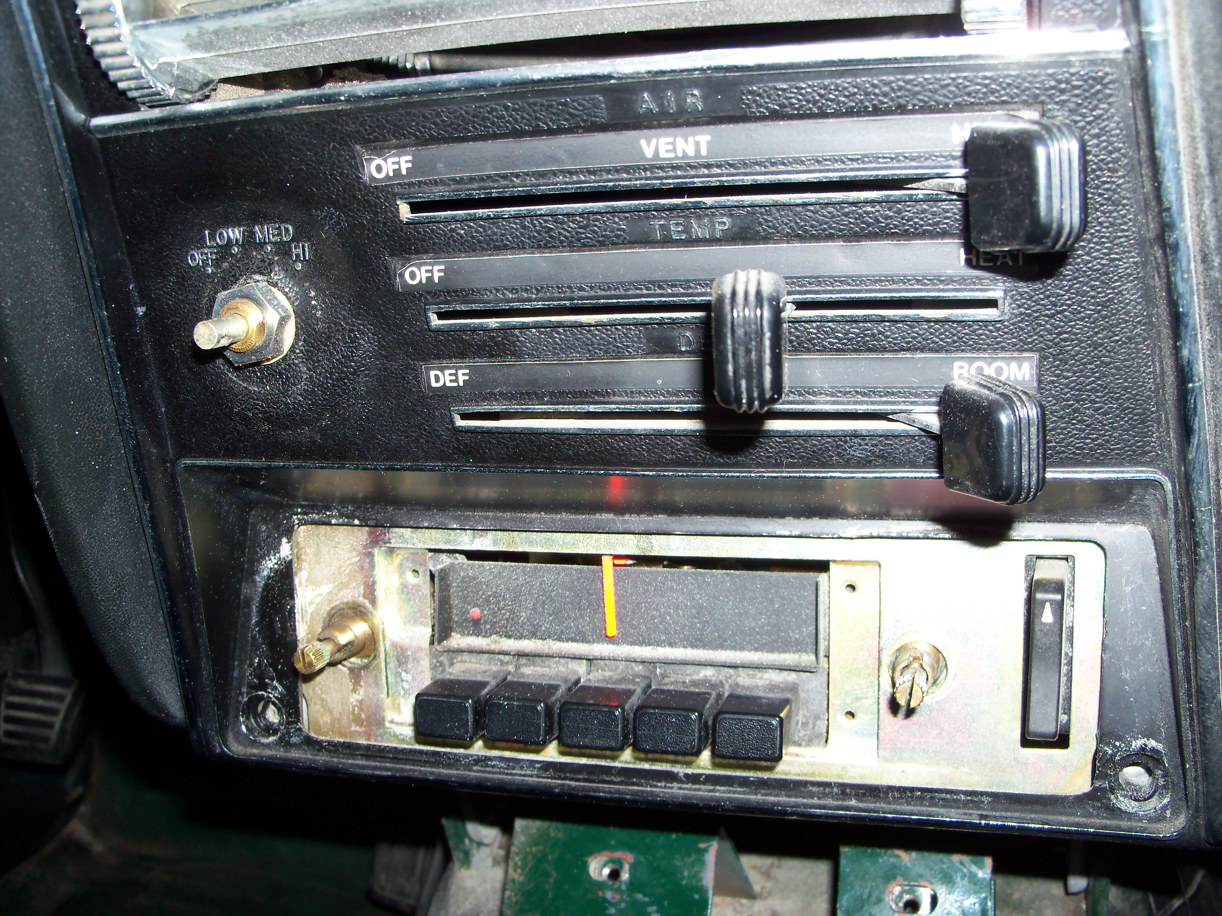

Thanks, photo archived in my library. I see now that the screws go in deep so the plate needs those bottom corners notched.  Not good news for Hardway though. He's gotta pull it all out again.
Galaxybj, you could probably make one of of a thick(ish) plastic piece. These metal plates are very thin metal.

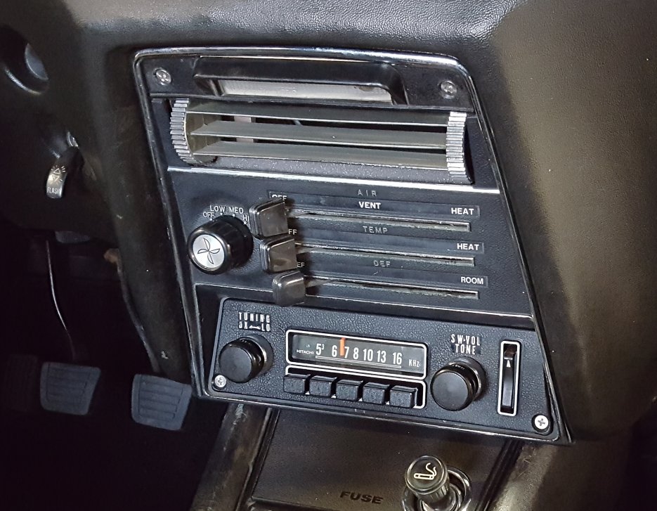

I actually got lucky and was able to pull the panel out a little bit and very carefully maneuver the plate in to position.  Everything looks and functions as it should except the small light in the radio is not coming on now.  When I bench tested it the light worked but now it doesn't.  Oh well, if I pull it again I will replace it.  Here is a picture of what success looks like!  Thank you again for everyone's help.

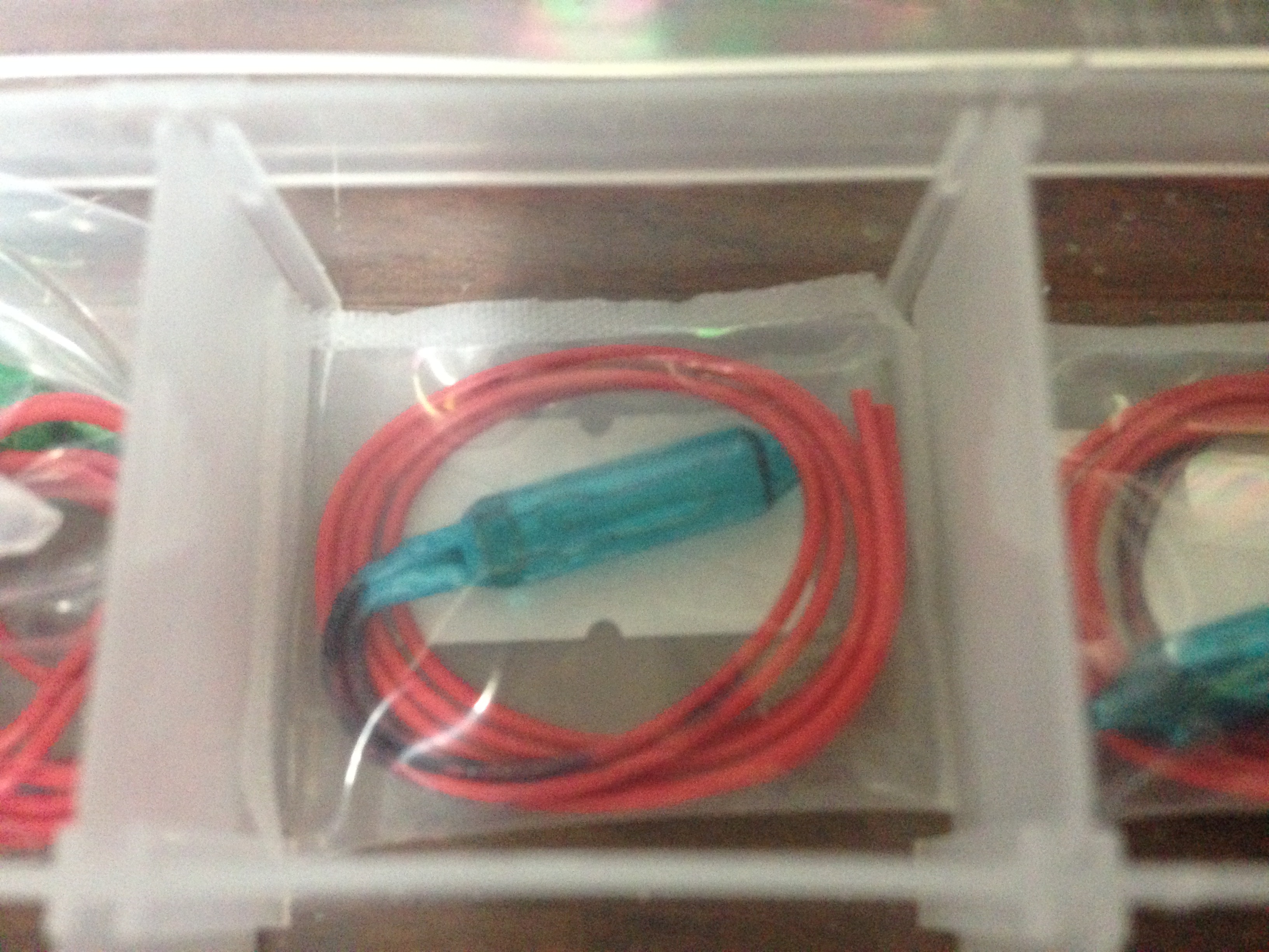

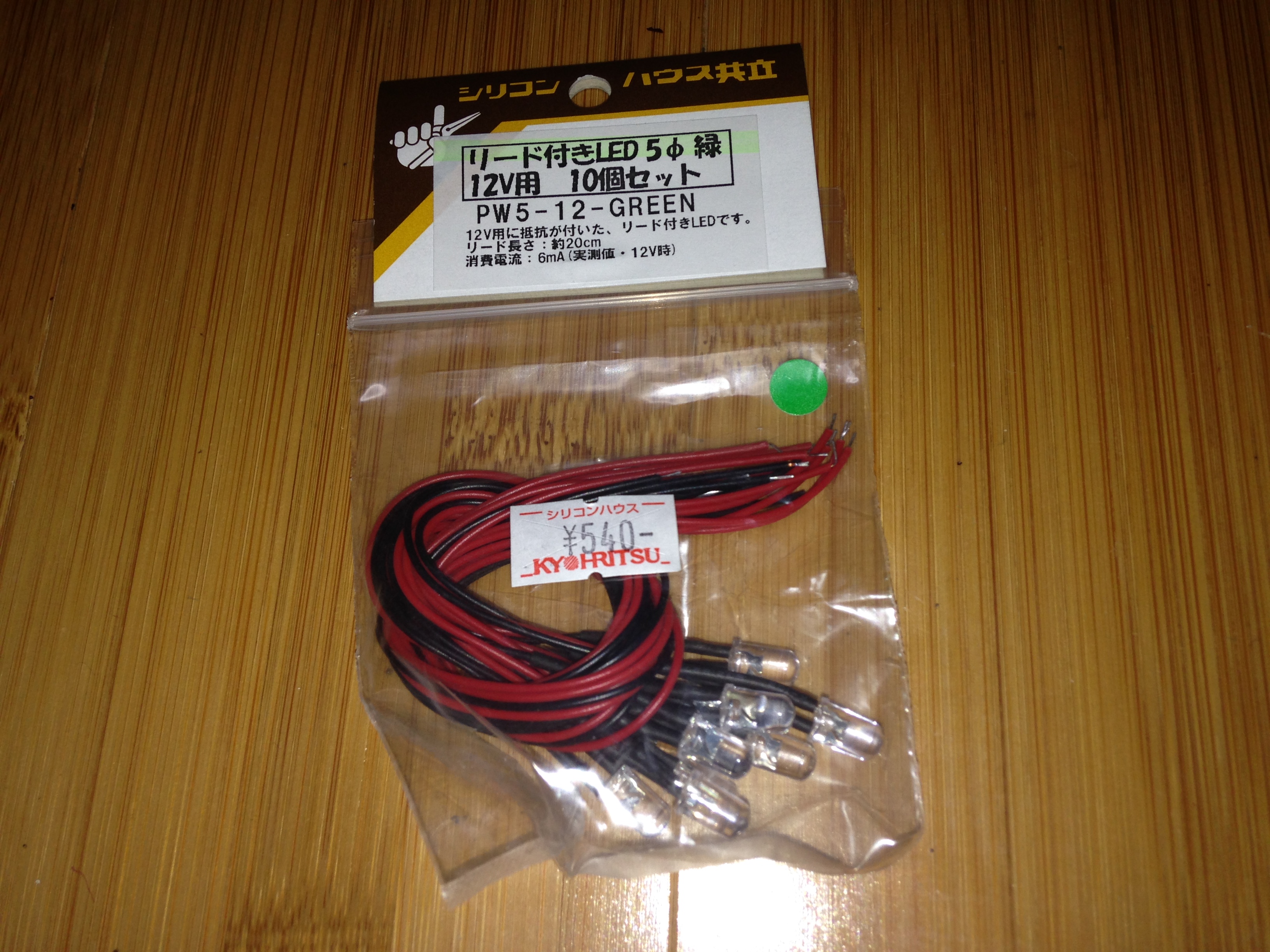

I was able to find the old style illumination bulbs that hitachi used and for the green light, these type of led's work great.
If you can't find that style bulb, you might have to retrofit it for another bulb or LED.
You just hot glue the led into the little tube where the bulb went. Hardest part is getting the right sized led that fits inside the tube.
