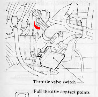

The throttle switch is the three prong switch on a 280z throttle body that adjusts the throttle as you depress the gas pedal.  The car runs lean until a certain contact point and under full throttle application it puts the car under full enrichment for acceleration.
Thanks I appreciate the answer.  I just wanted to know if it controlled airflow in some way.  The fact that it does would affect the throttle switch's operation.  This explains why every mechanic I've had has told me not to open that idle screw too much.  It does effect performance.

When the car is cold in the morning the air regulator is obviously open.  That little plug that's in the front of it sends a signal to the throttle valve switch that basically disables it.  When the air regulator opens, Then the throttle valve switch is active.  It has 3 prongs inside it, as you press the gas pedal they come closer together and eventually if you press enough ground out, which puts the car into what's called full enrichment.  Upon normal gas pedal operation i.e. driving at 40mph or whatever it's not under full enrichment.  The throttle switch is effected by the idle screw in that the further open the idle screw is the further you have to push the pedal to get it to kick in to give you acceleration.  So there is a correlation,
