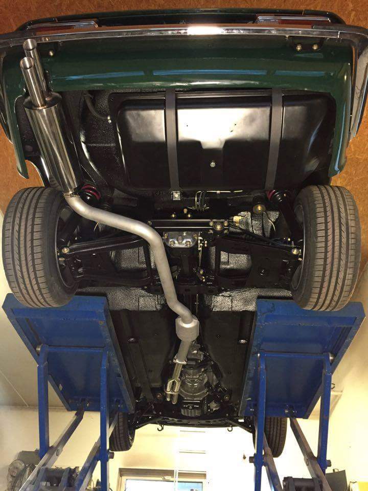

Hi Sean, I ended up ordering a jdm muffler from you! Had it put on 2 months ago and love it. I'm running a 2.5" pipe to it, no additional mufflers or resonators and it's loud as sh@#*t but amazing sounding. Most comparable to a pack of 12 grizzly bears and 13 lions sent up from the depths of hell. IMG_20161129_180347.thumb.jpg.8d9118898e
I think I bought the first Jdm muffler Sean sold so it's been on my car for some time now.
Its louder then it was with the muffler I had on before (msa exhaust package), But not to loud on the lower rpms but when you open the throttle it has a very racecar like sound and then it's loud.
I have no drone issues at all cruising or on the highway. At 120km/h I think my rpms are at around 3000.
