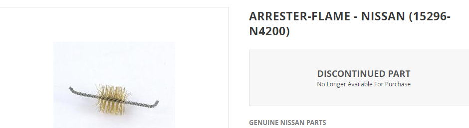

It's essentially just a piece of steel wool, but more prickly and stiff.  I replaced my PCV hose with a piece of water hose 60,000 miles ago.  No arrestor and the hose is fine. I like to live on the edge though.
 I still have the old hose, hard as wood, with the arrestor inside it.
Almost forgot that I had gone through your search before, myself.  Part #12.  I was wrong above, it's not steel wool, it's more like a piece of gun barrel brush.  Discontinued at Courtesy.  Spelled with an "e" also.
http://www.carpartsmanual.com/datsun/Z-1969-1978/engine-280z/emission-control-device/12
http://www.courtesyparts.com/oe-nissan/15296n4200
