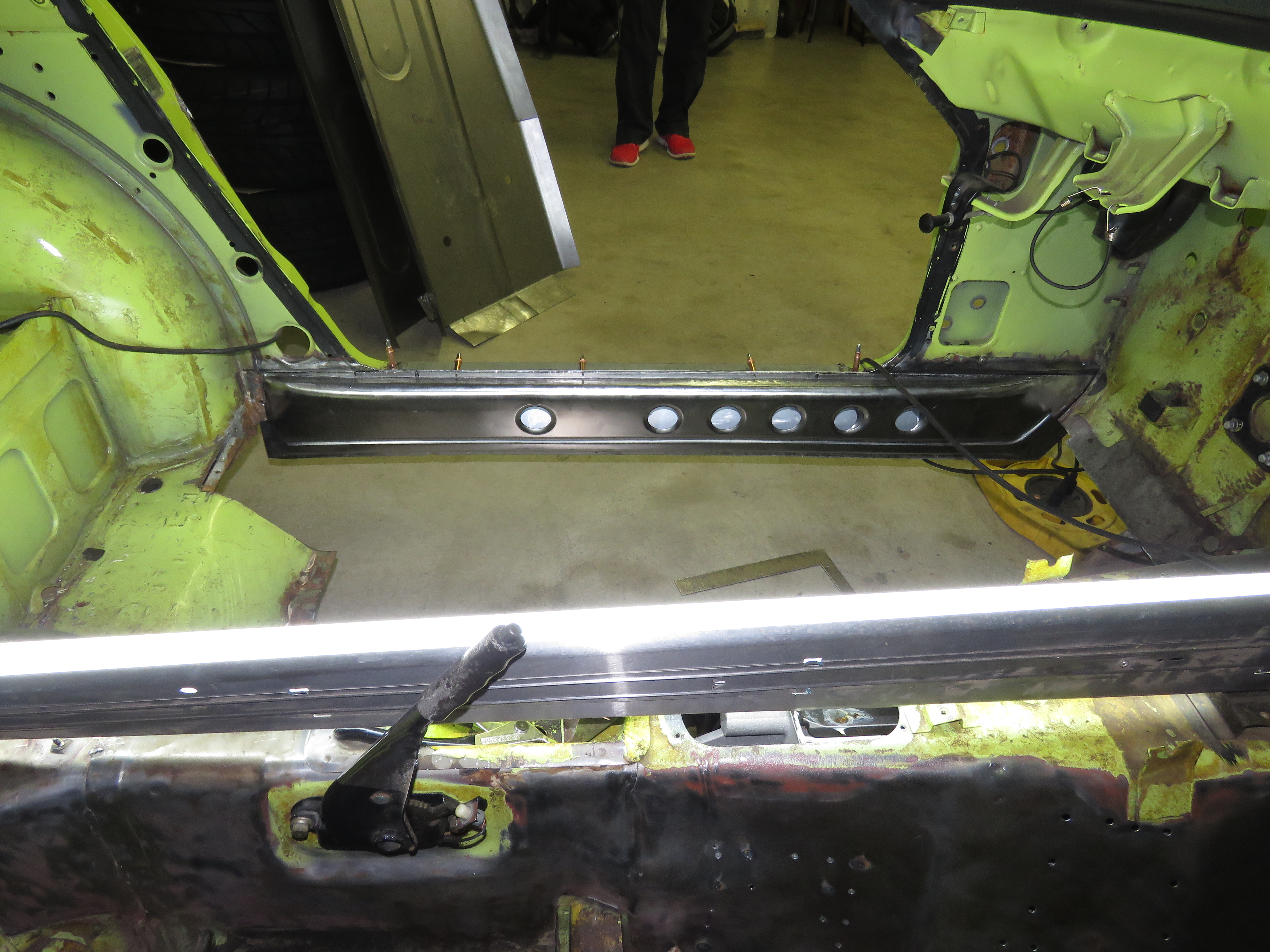

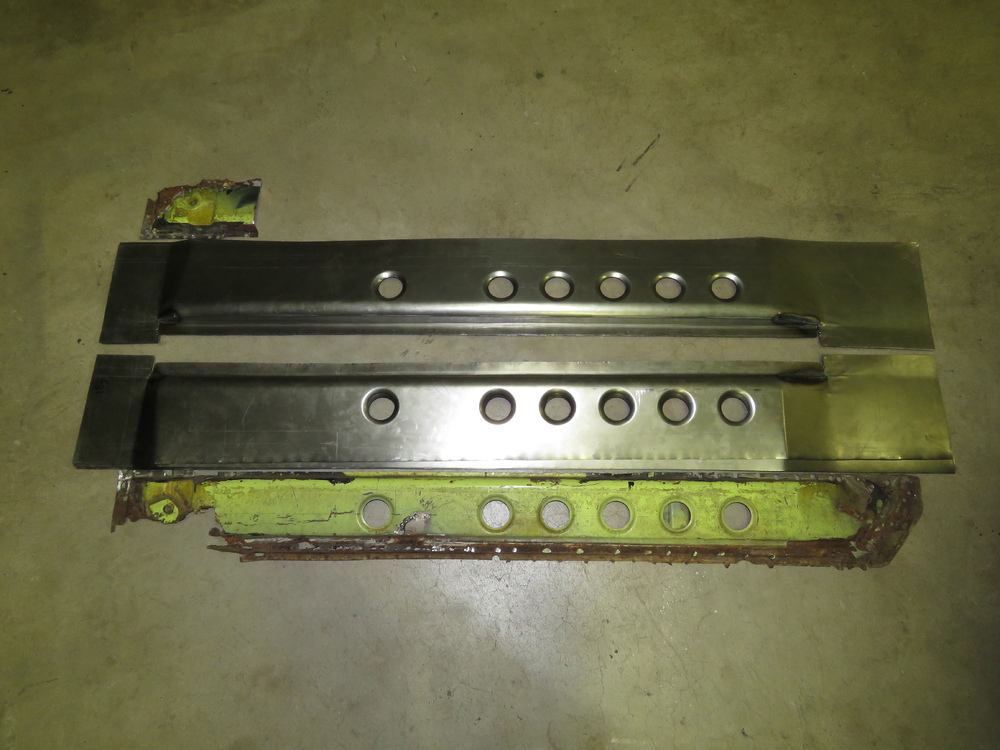

Thought I would post because I had some interest from some people asking if I would make these.  Due to the amount of time and labor involved, it wasnt worth my while to make these for a those that asked. After all I have a project to work on of my own and other things I could be doing besides work ^_^.

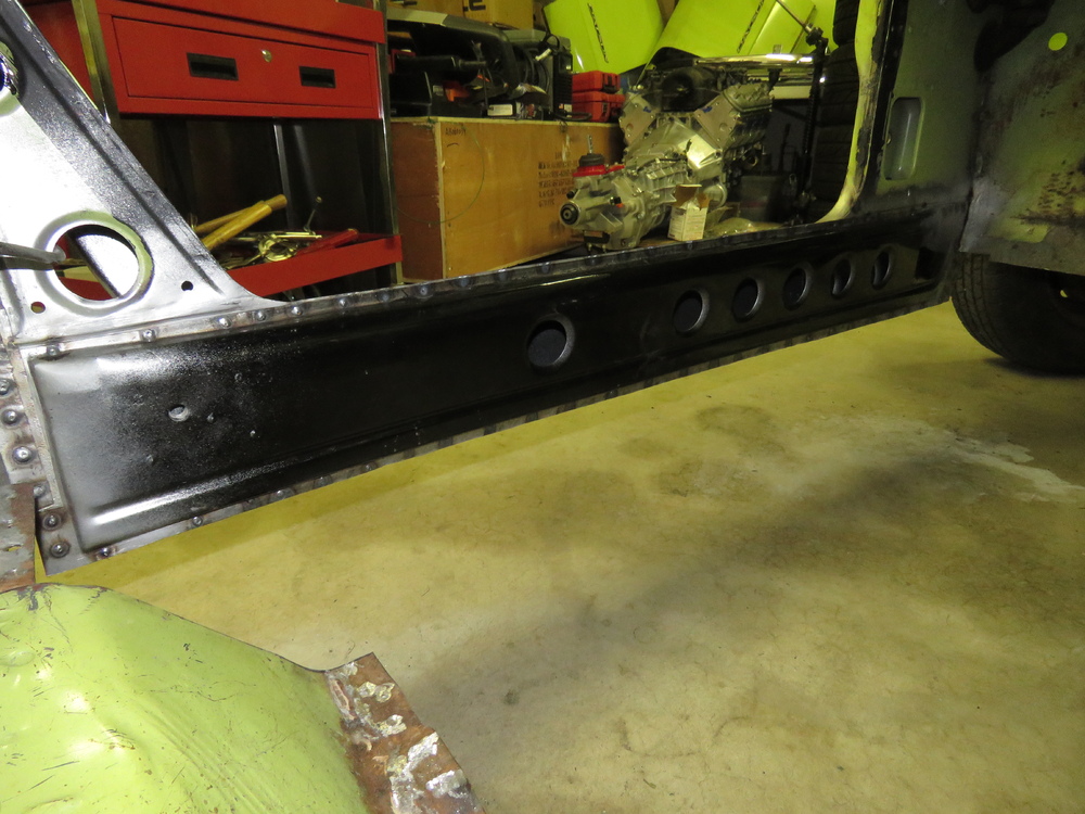

These inner rocker panels are replacements for a 240z as the pictures attached are those of my car.  I am unsure about the 260z and 280z whether these would fit them or not. Please chime in if your certain to let others know.
If enough people are seriously interested in getting these from me then please post up or send me a PM, if not then I guess this thread will be closed down.

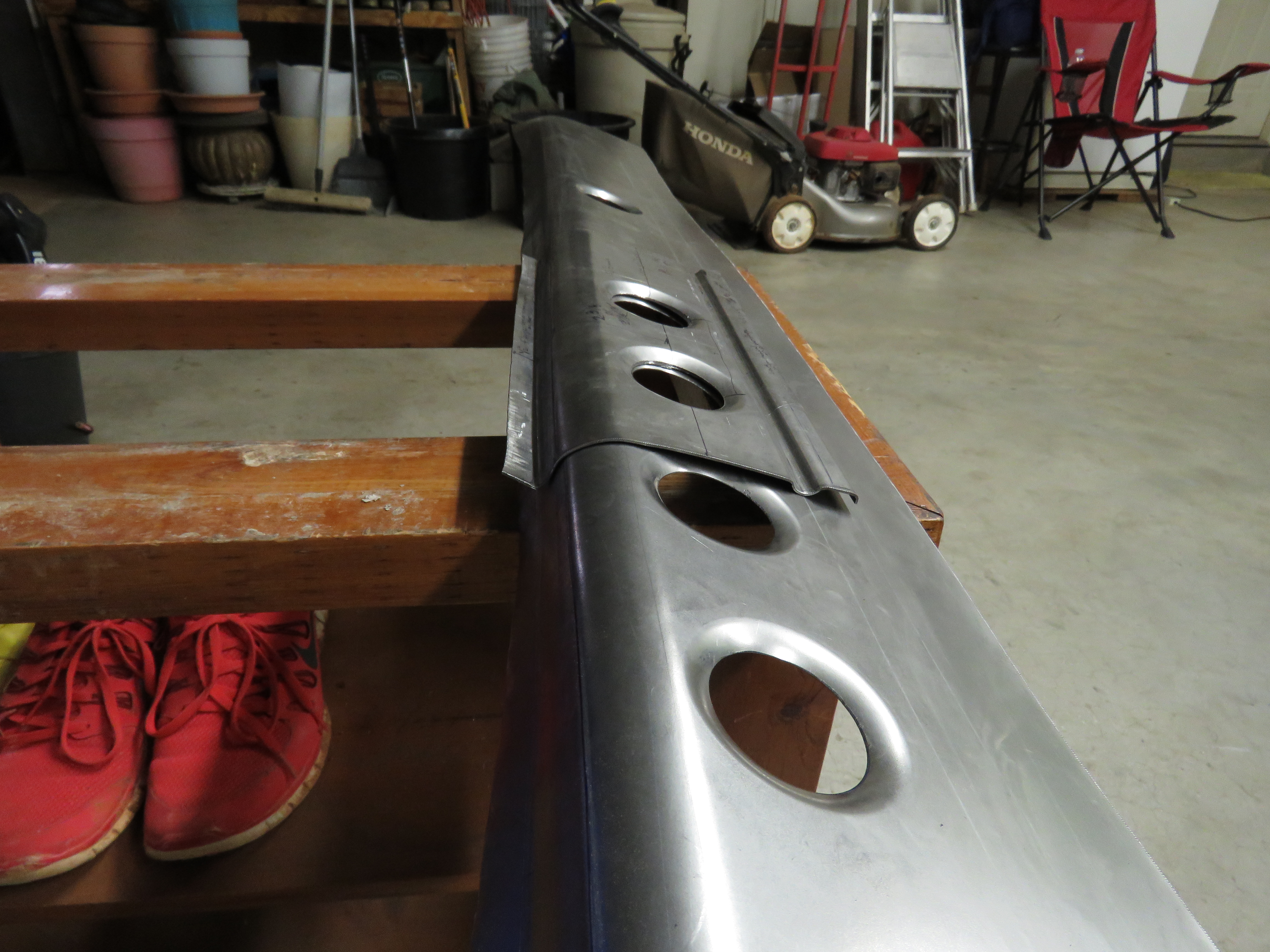

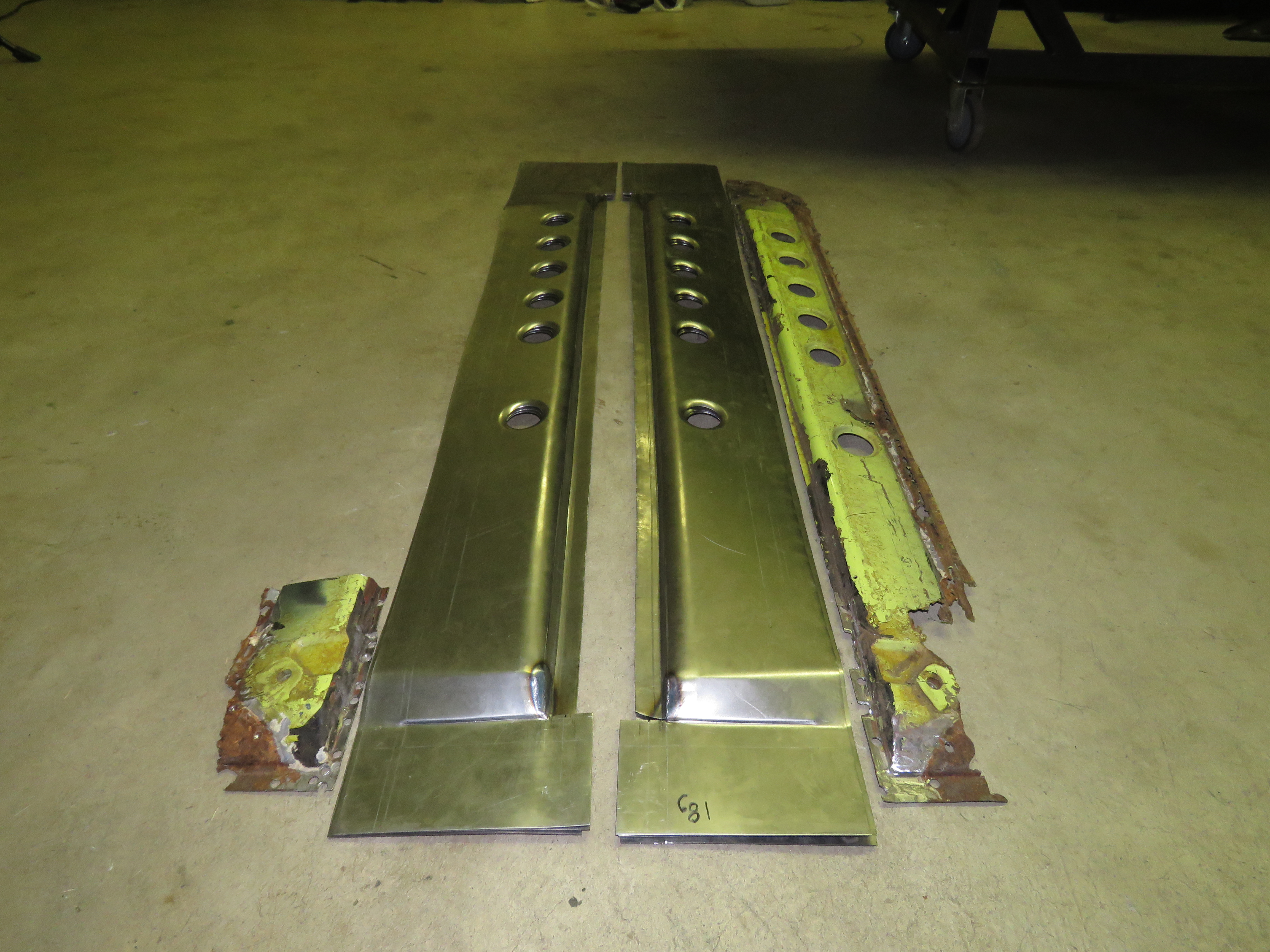

The inner rocker panels are constructed from 18g cold rolled sheet (CRS) metal which is just a tad thicker than the factory material (at least on my 240z).  I use cold rolled as it is supposed to be a bit stronger than hot rolled and cold rolled has a smoother finish.  These are not an exact match to the factory panels but close enough. The seat belt mounting plate is made from 1/8" (CRS) and the nut for the seat belt bolt is a harden Nut.

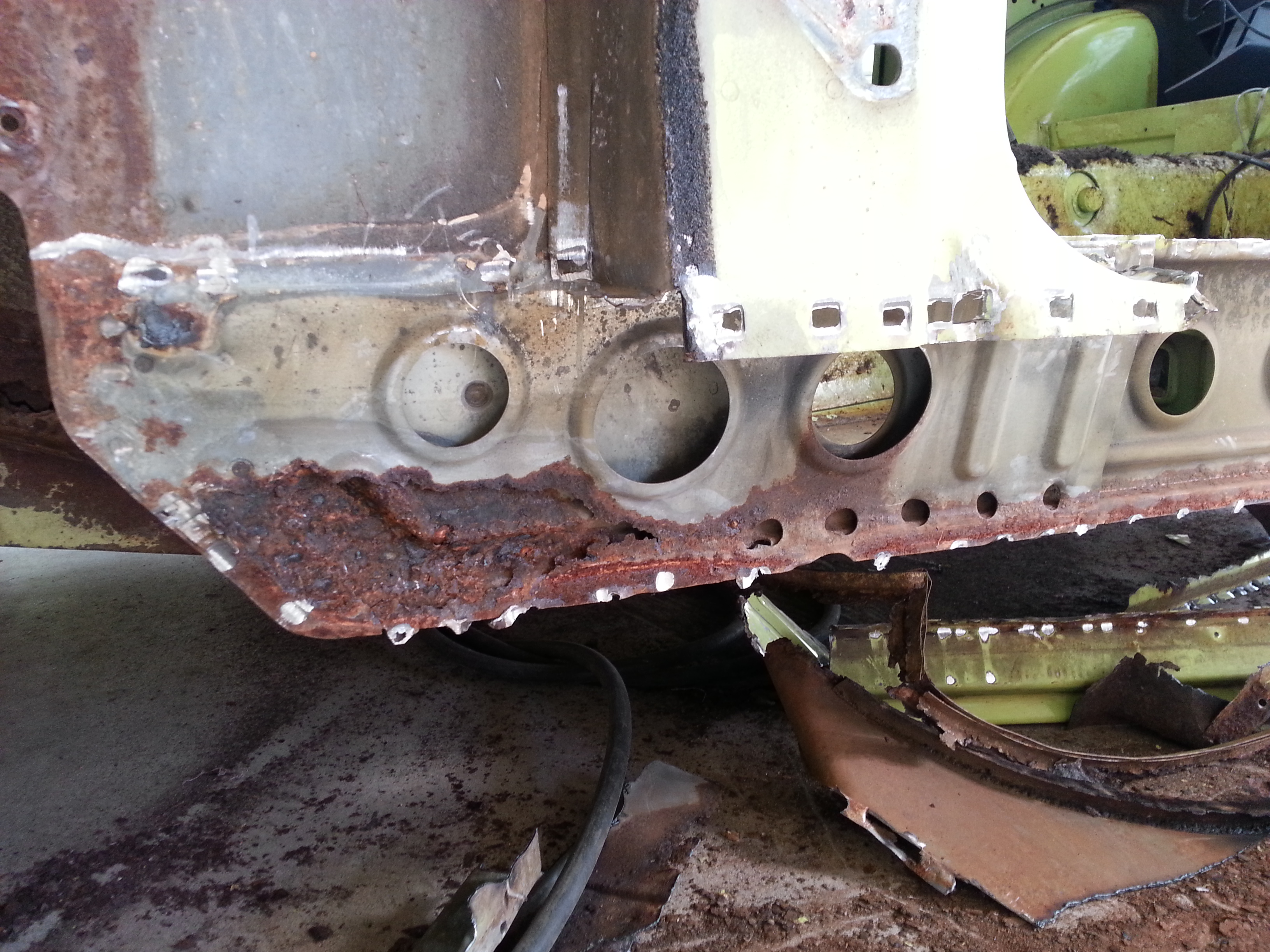

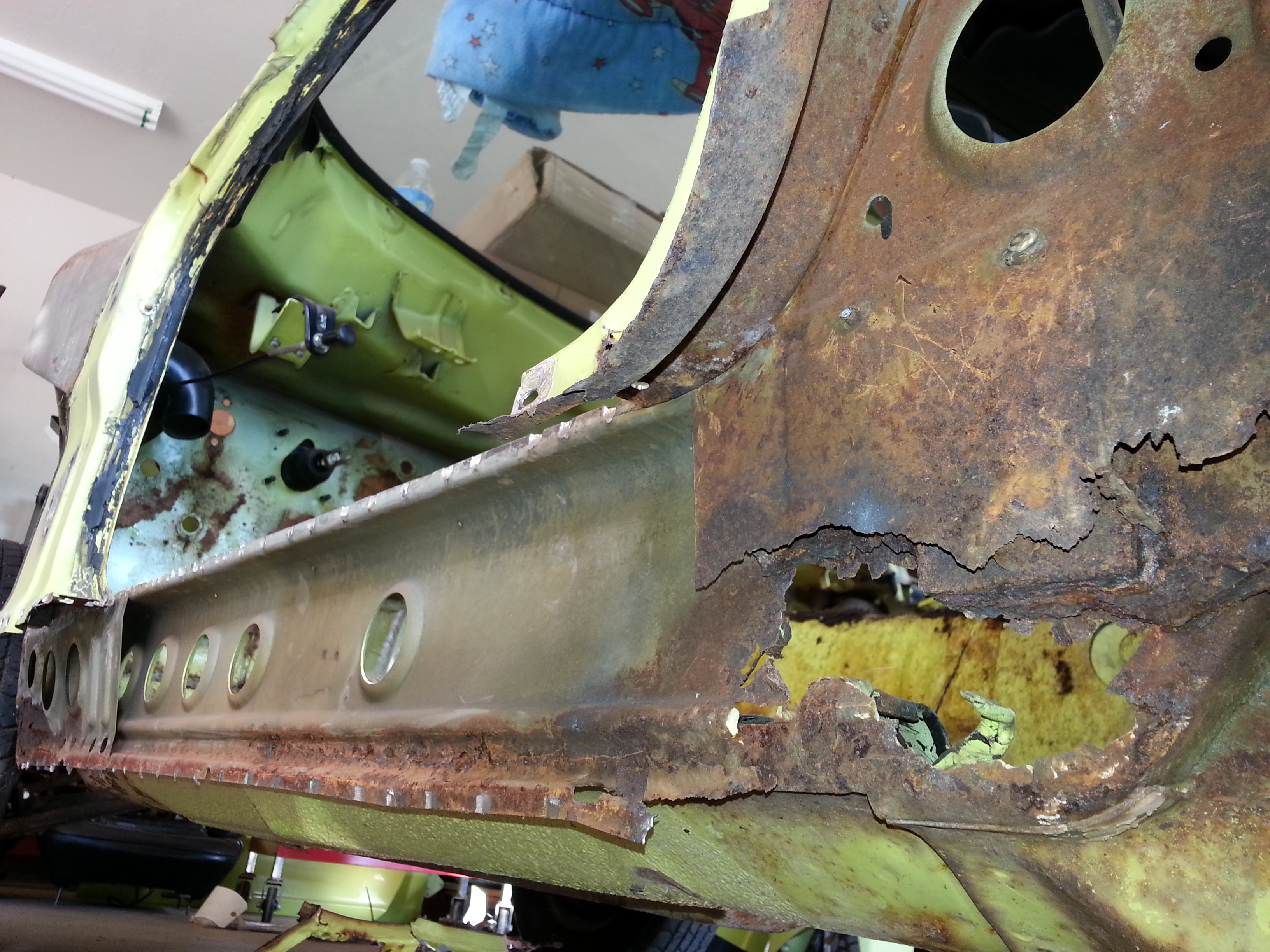

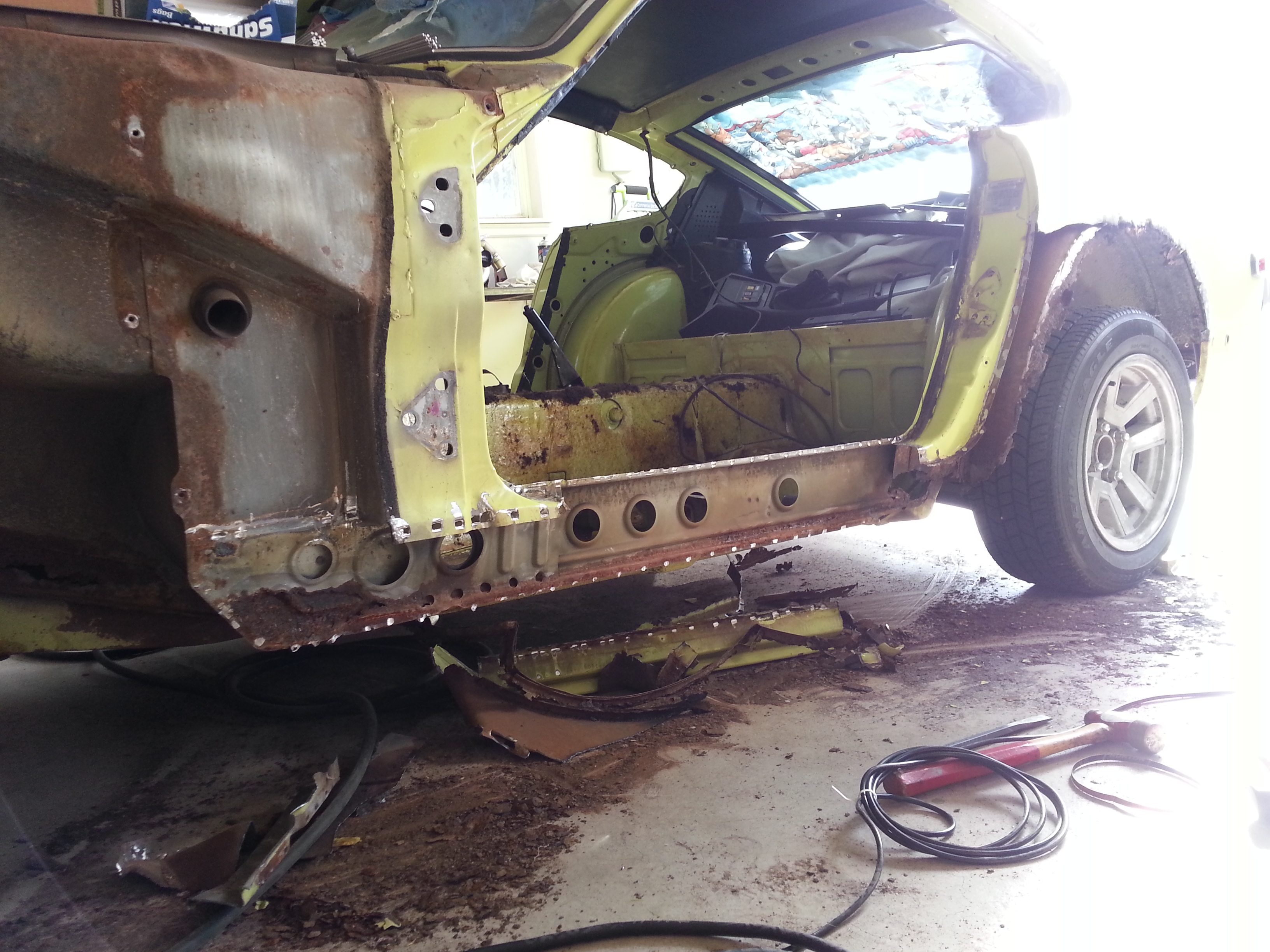

If your Z suffers from rotted out rusted inner rockers then these panels would be great, save you the hassle of trying to do a questionable patch job...
Price wise as of now looking at $380.00 shipped anywhere in the USA (out of Country may be subject to higher shipping rate) mainly because shipping a long box (60") like this is a bit pricey, but this is based on estimated shipping cost with Fedex, actual cost may differ which means if its lower then I can knock the price down. boxes and packaging material will be at my expense to ensure the panels arrive safely.
Please note I do not have any already made except the ones pictured which are for my car.
Let me know what you think and feel free to ask questions.
I will keep this updated when it comes time to submit an order, if it gets this far.
Thanks for Look!

Very impressive metal-forming work, esp. considering the gauge and CR material.  Price seems more than reasonable, considering the hours I expect you put into fabricating a pair.  For a Z with rot in the dogleg area, the chance to put fresh, heavy-gauge sheet metal into the area where the safety belt mounts might be worth the price of admission all on its own.

Thanks Namerow
Yeah working with 18G and CR is definitely a bit tougher than HR, but after a while get used to it, though it does take more time to shape depending on what your doing.

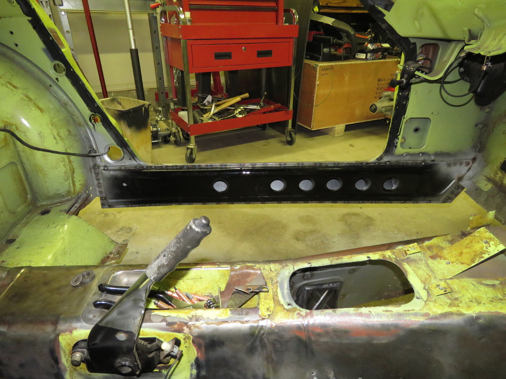

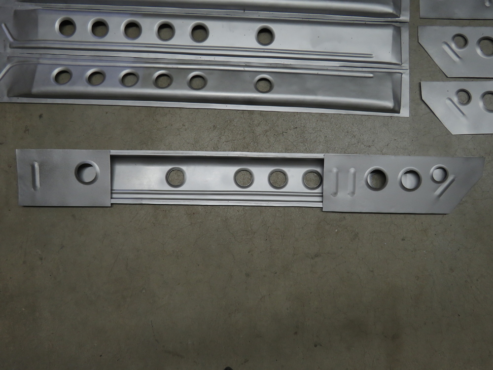

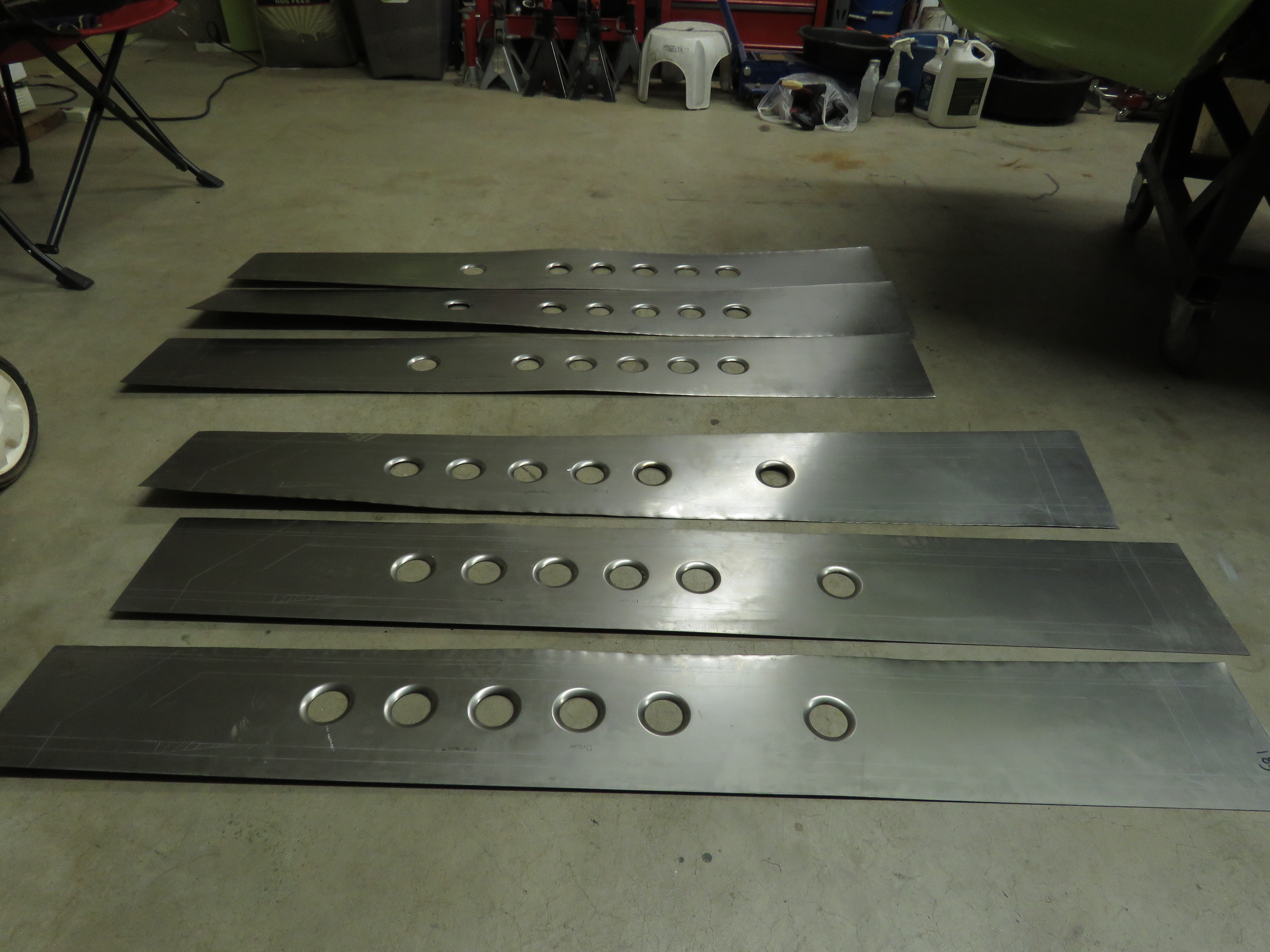

made two sets for two customers, decided to make an extra, below are pictures of the general process that goes into making these. The parts at the end get coated with Bloxide rust preventative weldable primer to keep from rusting during shipping and before installation.

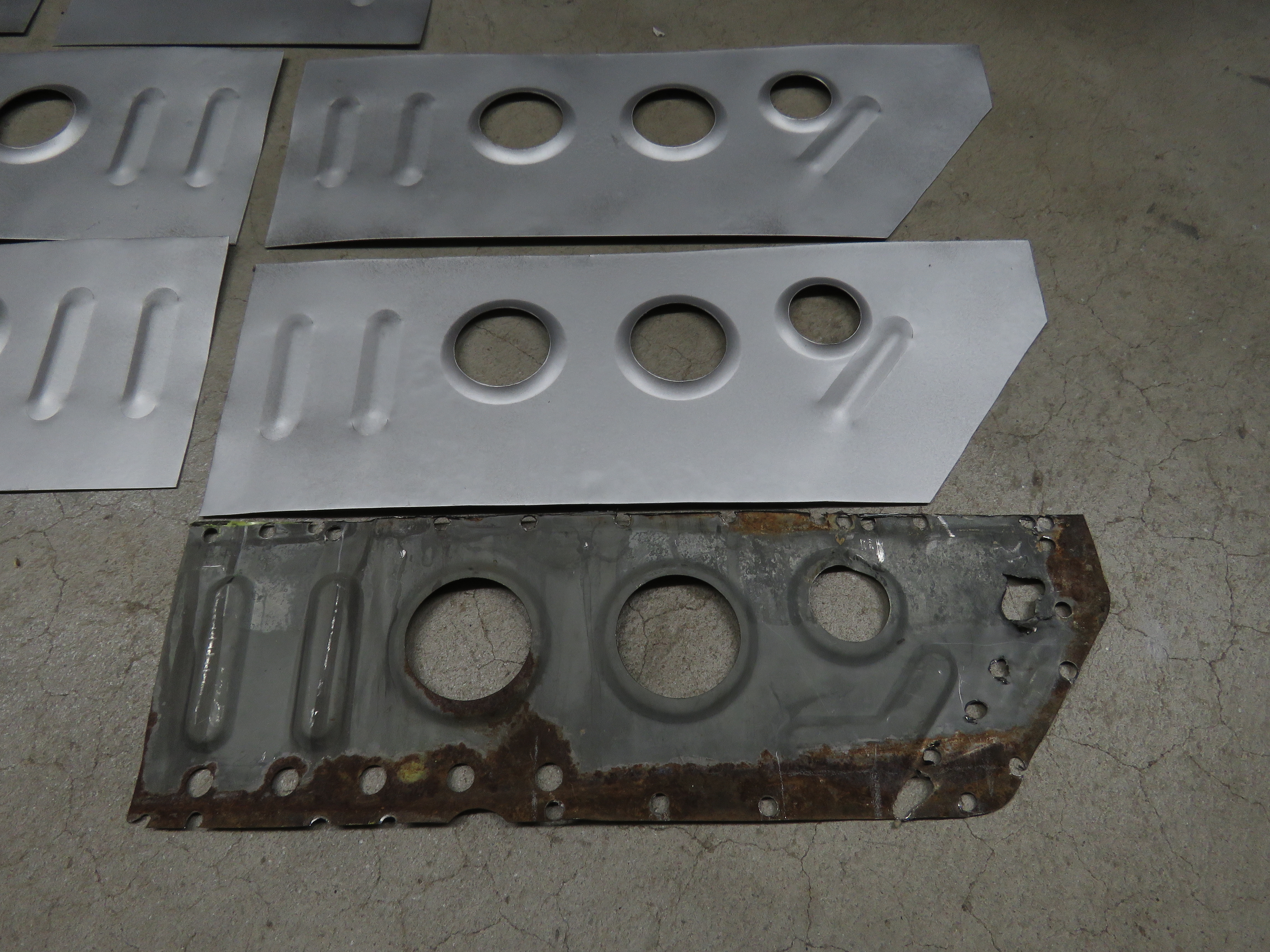

You have the option to purchase the panels with what I call tie in plates/support plates. There is a front end plate and a rear end plate on each passenger and driver side.  The front plates I am selling for $25 each and the rear plates for $10 each, so a total of $70 for all four corners. The fronts are more pricey due to it being larger and containing more dimple holes and beads.  These are what the outer and inner rocker panels mostly weld on to. I Do not have any pictures to show of it, but will post some up later of what they look like. chances are that if your replacing your rocker panels, the tie in plates will be rotter as well, great chance to weld in some new ones.

UPDATE: unable to update my main post so this post is the most up to date information regarding pricing and purchasing.
Attached are pictures of the tie in/support plates I was talking about previously.  They show what they look like and where they go on the car.  These plates are what the rockers mainly weld onto so it is important that these are in good shape when you are doing a repair of the rockers.
These plates are made from 20g CRS and is similar in thickness to the factory material.
