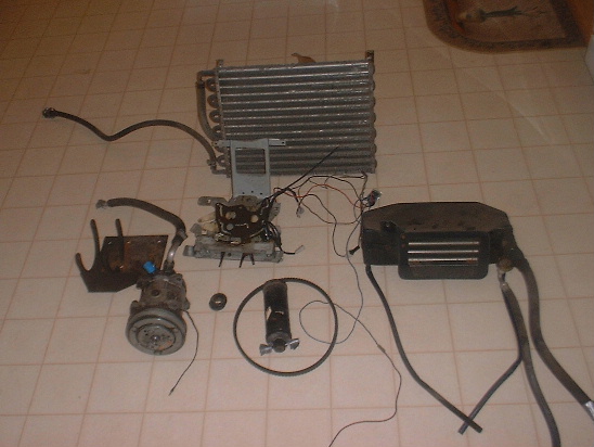

Yes aftermarket evap for sure. Hoses go thru the firewall. They put the evap in about the same location as stock was because i remember looking thru the vents and seeing
the fins. . It's been 10 years since i pulled mine out but I do remember it being bigger than the factory evap which is a plus. This is my whole system after I pulled it out.

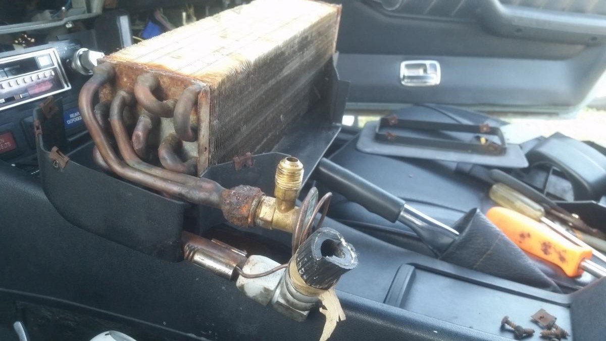

2nd photo is a close up i found on the web.
The hoses connect to the evap on the passenger side so i'm thinking it would be feesible to change the hoses out without pulling the dash.
