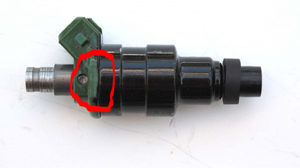

Nissan used tan and light green for it's NA injectors, and purplish brown for turbo.  Black is aftermarket.  The codes will be hard to see, molded or stamped in to the plastic plug portion.  FJ707, A11...., 280 150... are examples.
