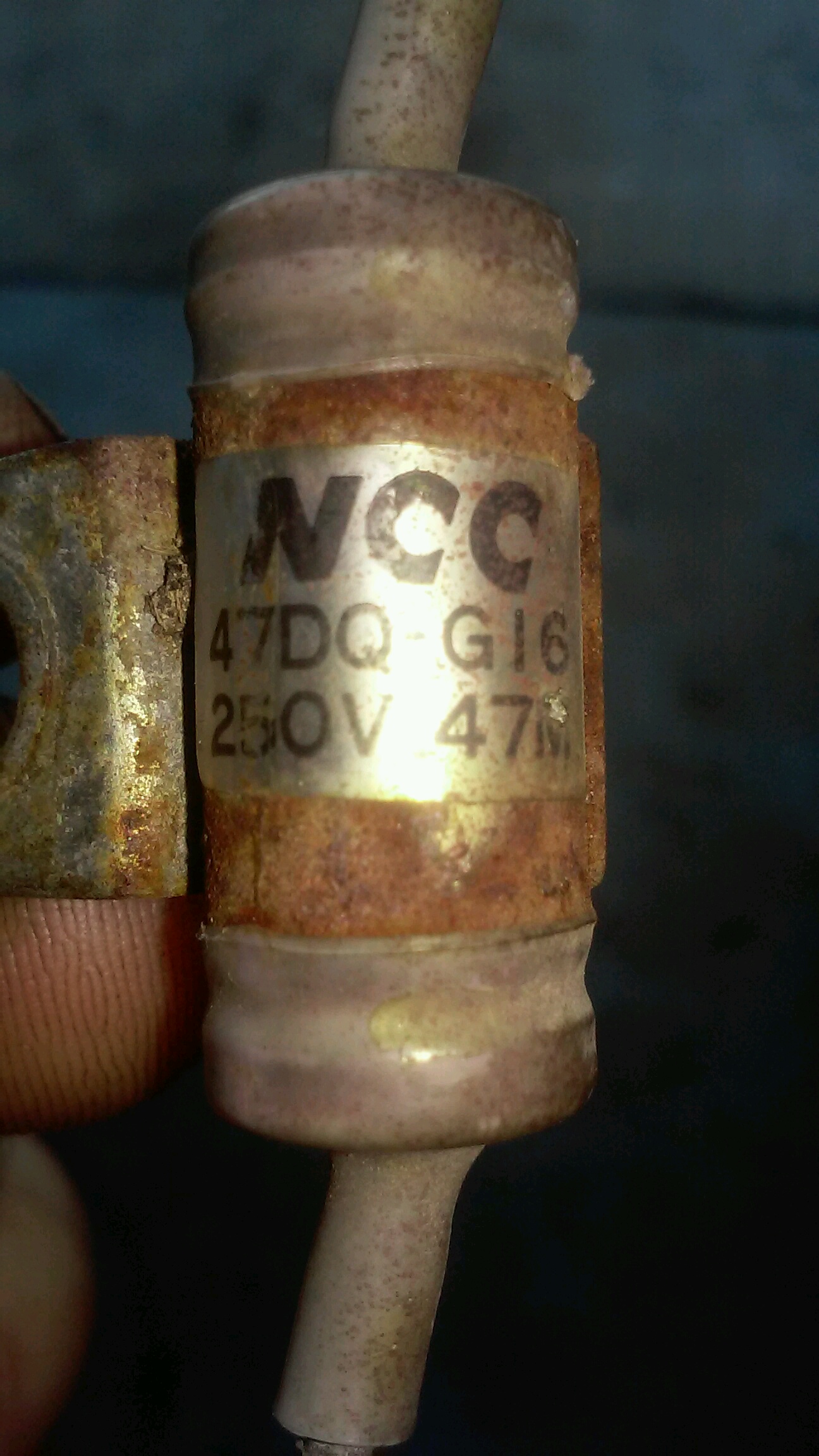

Posted May 28, 20169 yr comment_495854 My son purchased a 1978 280z. He is 17 and not a mechanic. Of course we have a mechanic; however, he is younger than the car. The Z was sold to my son. It was in a barn for approximately 10 years. My mechanic is honest; however, this vehicle is challenging. At this point and time, the vehicle starts and shuts off after minutes. The cold start valve has been replaced among other things. At this point we are working on the ignition coil and a part that cannot be identified, I read post and yet have not located this part to purchase. Please let me know if you know what it is. I have heard distributor condenser, ignition capacitor...at this time it cannot be found. The capacitor I purchased had one wire. This part has two. Please help.  No I am not a mechanic but I am intelligent enough to understand parts on a vehicle. So please help and not belittle. Link to comment https://www.classiczcars.com/forums/topic/55531-1978-280z-barn-find-sons-dream-car-wont-stay-running/ Share on other sites More sharing options...
May 29, 20169 yr comment_495859 That part is a capacitor, AKA condenser.  The one wire units ground through the case and mount, the two wire units have a separate ground wire, as yours does.  But they both do the same thing.  If the engine starts that's not likely to be your problem.  If it was shorted, you'd know it because it would short whatever it's connected to.  I wouldn't worry about unless you've measured continuity and know that it's shorted. If the car sat for ten years, you'll need to give many many more details on what's been done to it before you tried to start it.  The gas tanks on these cars aren't well sealed and tend to get rusty after just a few years, let alone ten.  The fuel pumps get rusty, the injectors get clogged, the filter could be full of water.  Who knows. But since it does start and run for a short while, describe what happens as it dies.  Does it just shut off quickly, or does it slowly lose idle speed and die?  Will it restart immediately or do you have to wait?  If ti won't restart, does it not have spark or not have fuel? The more detail the better.  You can't just replace parts one at a time on these cars, you need to do lots of testing.  Check the forum's Download section and get the 1978 Service Manual and the 1980 Fuel Injection Guide. Link to comment https://www.classiczcars.com/forums/topic/55531-1978-280z-barn-find-sons-dream-car-wont-stay-running/#findComment-495859 Share on other sites More sharing options...

June 4, 20169 yr Author comment_496274 At this point, I have no thoughts of being a mechanic; however, I told my son he should definitely give it a whirl. He is 17 and chose a non running "dream" vehicle as his first. Everything being done is his $. Our mechanic is trustworthy and all techs for datsun's ask for 300 just to look at it.  I am the researcher. Info that you asked about, it just dies. The longest it ran was five minutes. Fuel filter, pump, afm and hoses, cold start valve, just bought ignition coil and a part that I thought was the one pictured but it only has one wire and a larger cylinder. As for gas tank being an issue, my mechanic did bypass the gas tank and results were the same. Being that it sat for a long time, we have been using premium gas during trial and error. I will say we have a mechanic younger than vehicle. With that being said, his father is a mechanic as well and enjoys working on it.  Link to comment https://www.classiczcars.com/forums/topic/55531-1978-280z-barn-find-sons-dream-car-wont-stay-running/#findComment-496274 Share on other sites More sharing options...
