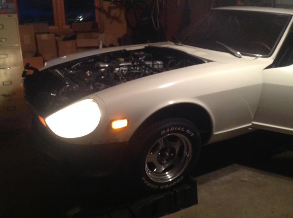

i connected the white wire and I have lights and the starter turns over, Bonnie lives, BUT.......
the headlights are dim, and the starter only barely cranks over, even with a jump?

Check the battery cables at the starter. Make sure the alternator belt is good and tight then put a volt meter on the battery while it's running, should read around 14 volts.
It's not good for an alternator to use your alternator to charge a dead battery.  You should charge the battery before trying to start the car.  One dead battery + one charged battery = one partially-charged battery.
Siteunseen, I somehow snipped it off when I pulled the engine, but I did get the wires in the correct place, I suppose I should order, or find a replacement, good point.
i did replace the battery, and it cranks over as it should.  Someone asked if I added any parts in the rebuild.  Yes, I upgraded the coil, tonight I'm going to make sure it is correctly installed, hoping to get Bonnie started!
