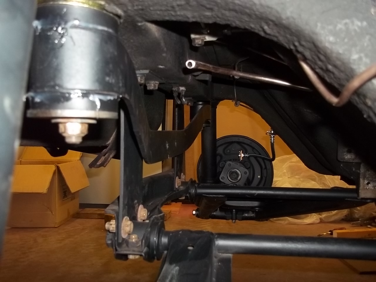

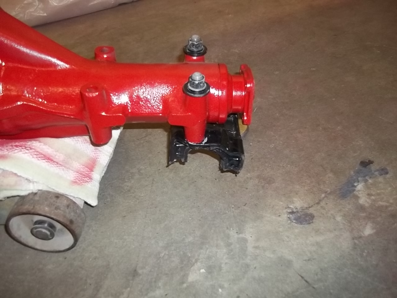

Posted April 30, 20169 yr comment_493926 what is backwards here? if i put the front mount on 1 way its too far from the m bar, if i put it on the other way, its too close. do i have the m bar on backwards? Link to comment https://www.classiczcars.com/forums/topic/55367-differential-wont-go-in/ Share on other sites More sharing options...
April 30, 20169 yr comment_493932 Depends on R180 or R200. Illustrations in the Suspension chapter. Link to comment https://www.classiczcars.com/forums/topic/55367-differential-wont-go-in/#findComment-493932 Share on other sites More sharing options...
April 30, 20169 yr comment_493938 Looks like that mount on front of differential needs to flip around, long portion in back. Link to comment https://www.classiczcars.com/forums/topic/55367-differential-wont-go-in/#findComment-493938 Share on other sites More sharing options...

May 1, 20169 yr comment_493980 I have in my notes a caution that it's possible to accidentally install the front transverse crossmember backwards (I'm talking about the big, stamped-metal piece that bolts to the underside of the vehicle and provides the mounting point for the rubber isolator block). If you do this, it shifts the position of the mounting holes for the rubber isolator block. Perhaps that's what you've done. My notes apply to the crossmember for a Series 1 and they say that a flipped front crossmember will shift the fore/aft location of the isolator block by 3/4". The crossmember design changed for the later cars, but I wouldn't be surprised if that asymmetry is still there. Link to comment https://www.classiczcars.com/forums/topic/55367-differential-wont-go-in/#findComment-493980 Share on other sites More sharing options...
May 1, 20169 yr comment_493983 The cross member can be installed either way, but the correct way puts the larger exhaust semi-circular cutout on the left side where the exhaust runs. Motorman7's picture shows the correct orientation Link to comment https://www.classiczcars.com/forums/topic/55367-differential-wont-go-in/#findComment-493983 Share on other sites More sharing options...
May 1, 20169 yr comment_493987 29 minutes ago, zKars said: The cross member can be installed either way, but the correct way puts the larger exhaust semi-circular cutout on the left side where the exhaust runs. Motorman7's picture shows the correct orientation OK. And the moustache bar is installed correctly, too (oriented so that the mounting 'eyes' sit on the trailing side of the bar)... so that seems to confirm that incorrect orientation of the rubber isolator block is the culprit. Link to comment https://www.classiczcars.com/forums/topic/55367-differential-wont-go-in/#findComment-493987 Share on other sites More sharing options...

May 1, 20169 yr Author comment_493995 well i flipped the m bar around but then realized that i need to install the parking brake cables first. So, i havent tried installing the diff again. I found a good cable that i pick up this am. will try the diff again this afternoon thanks all for the help Edited May 1, 20169 yr by sweatybetty Link to comment https://www.classiczcars.com/forums/topic/55367-differential-wont-go-in/#findComment-493995 Share on other sites More sharing options...
May 1, 20169 yr Author comment_493996 19 hours ago, motorman7 said: Looks like that mount on front of differential needs to flip around, long portion in back. which way is your m bar? Link to comment https://www.classiczcars.com/forums/topic/55367-differential-wont-go-in/#findComment-493996 Share on other sites More sharing options...
May 1, 20169 yr comment_493997 you posted a picture of how it came out of the car in your own build thread. could be the body is not quite right. you could take a measurement. maybe someone will take the same to compare. Link to comment https://www.classiczcars.com/forums/topic/55367-differential-wont-go-in/#findComment-493997 Share on other sites More sharing options...
