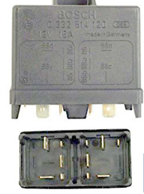

May 4, 20178 yr comment_519903 17 minutes ago, SteveJ said: What year 280Z? I just replied to a PM from utah. The images on Amazon look almost identical pin-wise, to the Nissan part. But the web sites all say it's for Volkswagen, and some say it won't work for a 280Z. https://www.amazon.com/Beck-Arnley-203-0053-Relay/dp/B000CB0DK4 Anybody want to compare pins? Trying to attach an image but I'm having CZCC web site problems. This is from Amazon. It's all that shows, CZCC says it's done loading. Maybe someone else can get it loaded. Edited May 4, 20178 yr by Zed Head Link to comment https://www.classiczcars.com/forums/topic/55289-fuel-pump-mystery/?&page=2#findComment-519903 Share on other sites More sharing options...

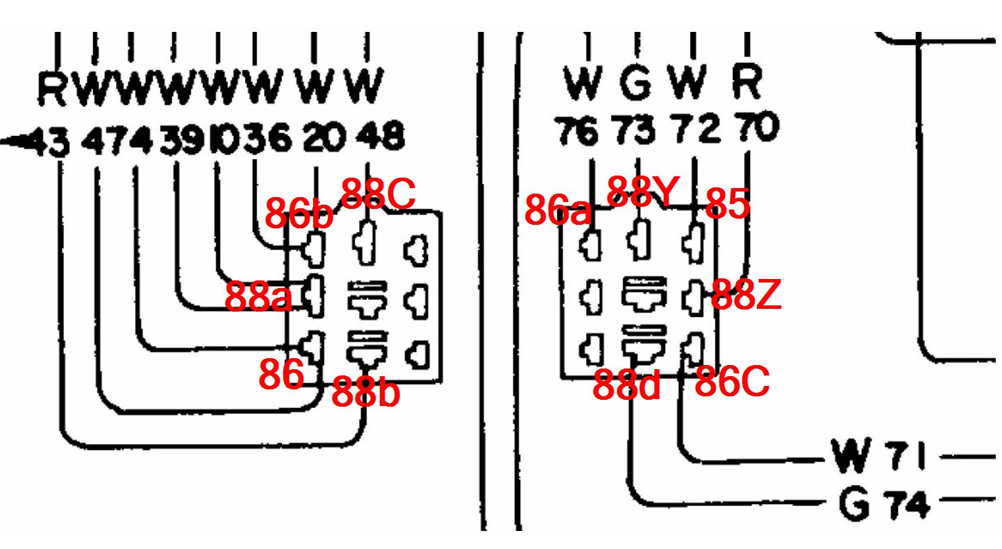

May 4, 20178 yr comment_519907 The terminal designations are all the same. Nissan licensed the Bosch fuel injection system that was used in VWs, etc. The terminals for each half line up, but the wiring diagram shows the halves swapped. The EF section of the FSM shows the correct orientation with several figures starting at EF-54. It will most likely work. Link to comment https://www.classiczcars.com/forums/topic/55289-fuel-pump-mystery/?&page=2#findComment-519907 Share on other sites More sharing options...
May 4, 20178 yr comment_519908 1 hour ago, Zed Head said: I just replied to a PM from utah. The images on Amazon look almost identical pin-wise, to the Nissan part. But the web sites all say it's for Volkswagen, and some say it won't work for a 280Z. https://www.amazon.com/Beck-Arnley-203-0053-Relay/dp/B000CB0DK4 Anybody want to compare pins? Trying to attach an image but I'm having CZCC web site problems. This is from Amazon. It's all that shows, CZCC says it's done loading. Maybe someone else can get it loaded. I copy and pasted these from your link above without any trouble. Edited May 4, 20178 yr by siteunseen Link to comment https://www.classiczcars.com/forums/topic/55289-fuel-pump-mystery/?&page=2#findComment-519908 Share on other sites More sharing options...
May 4, 20178 yr comment_519909 It showed up properly when I got back in to CZCC. It didn't show the whole picture before though. I'm having some weird issues with the site. I signed in from a phone just now and I can't figure out how to sign out. I'm permanently signed in, apparently. This post is from my computer though, because there's no cut and paste option on Android, as far as I can tell. The super phones aren't that super. I had to write in Notepad here while I waited to be able to sign in. Gotta be the NSA. On the double relay - Wouldn't be surprised if those plastic pillars on the side get in the way of the Nissan plugs. Could be why it won't "work". Cut them off and it should. That might be a significant find for future relay seekers. We've overlooked the basic question we usually ask though - are you sure it's the relay that's the problem? Might be spending on the wrong part. Link to comment https://www.classiczcars.com/forums/topic/55289-fuel-pump-mystery/?&page=2#findComment-519909 Share on other sites More sharing options...
