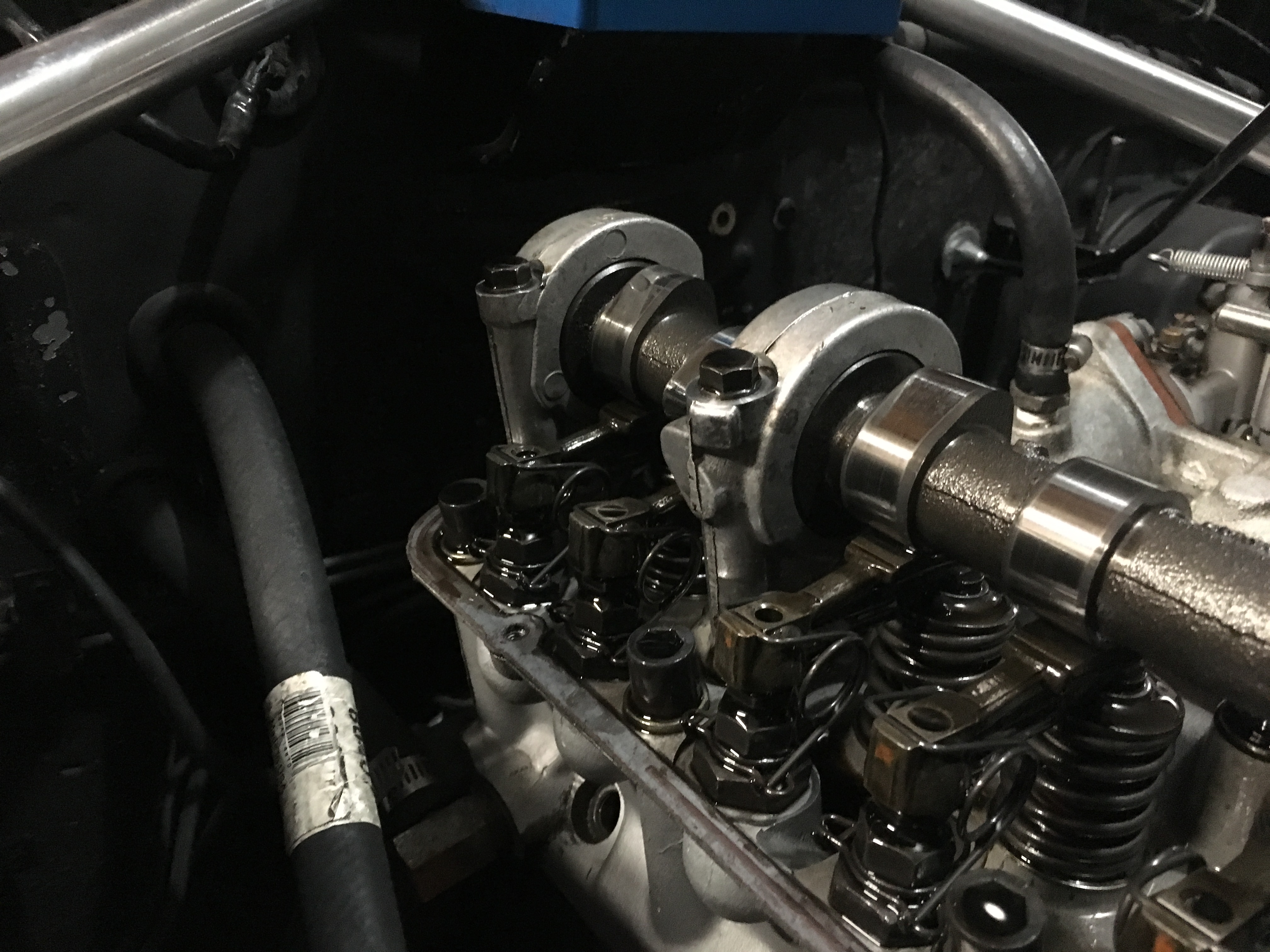

April 10, 20169 yr Author comment_492203 Ok so I have the valve cover off. Went to turn the cam and it doesn't move. At all. All of the plugs are removed. It just feels locked up. I used as much strength as I could and it did not move. Am I supposed to loosen something else to be able to turn it?? I'm watching 2 YouTube videos on valve adjustments on L series motors and they don't mention loosening anything. Luckily the heel of the exhaust lobe on the cam on 6 is pointed up, where it should be to check correct? I don't expect a reply cause it's 250 am and you are all sleeping! Damn night shift! Â from what I've read after posting this is either a broken valve or rod or perhaps there is a piece of the ring in the cylinder that is preventing the piston to move? But how is this possible if the car ran fine?? Edited April 10, 20169 yr by zmanoside Link to comment https://www.classiczcars.com/forums/topic/55222-blowby-too-much-smoke/?&page=3#findComment-492203 Share on other sites More sharing options...
April 10, 20169 yr comment_492205 Make sure the tranny is in neutral, turn the engine clockwise from the main crankshaft bolt not the camshaft. That's clockwise from the front of the car looking back to the rear end. Link to comment https://www.classiczcars.com/forums/topic/55222-blowby-too-much-smoke/?&page=3#findComment-492205 Share on other sites More sharing options...
April 10, 20169 yr Author comment_492207 That's exactly what I did my friend. Tranny in neutral, all plugs out using the main bolt on the camshaft that has the timing chain directly on top of it turning clockwise if you are looking to the rear of the car. Won't turn. I just tried again and almost pulled a hammy. Won't turn one bit. Link to comment https://www.classiczcars.com/forums/topic/55222-blowby-too-much-smoke/?&page=3#findComment-492207 Share on other sites More sharing options...
April 10, 20169 yr comment_492210 Crankshaft bolt not camshaft Link to comment https://www.classiczcars.com/forums/topic/55222-blowby-too-much-smoke/?&page=3#findComment-492210 Share on other sites More sharing options...
