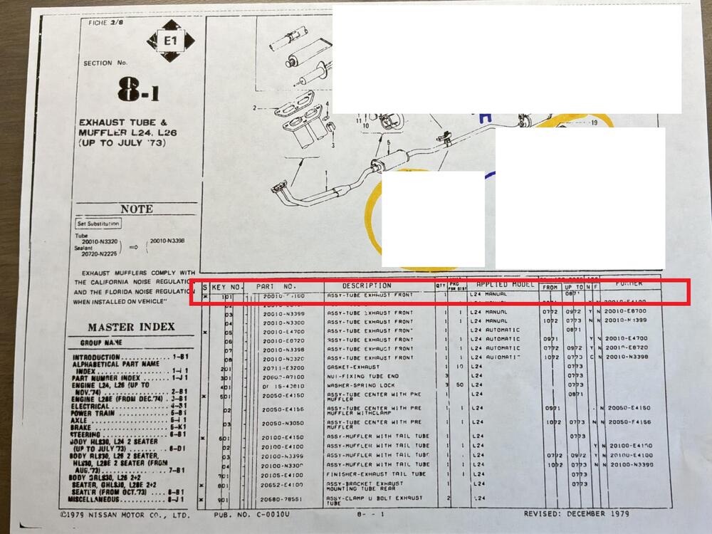

Does anyone have a photo of the downpipe Item 1-01 identified in red box?
Thanks,
Keith
I have the complete pipe shown in that diagram from a 3/70 car.
What do you need for pictures?
I have seen three (3) style downpipes purported to be early 240Z:
Type 1
Type 2 (upper) below
Type 3 (lower) below
Which is correct for a January 1970 production 240Z?
Thanks,
Keith
I cannot confirm 100% as the pipe came to me second hand.
It looks like the 3/70 is like #3
I have a still in the car pipe from 1/70 that also looks like #3 (hard to see it all)
Hope that helps.
