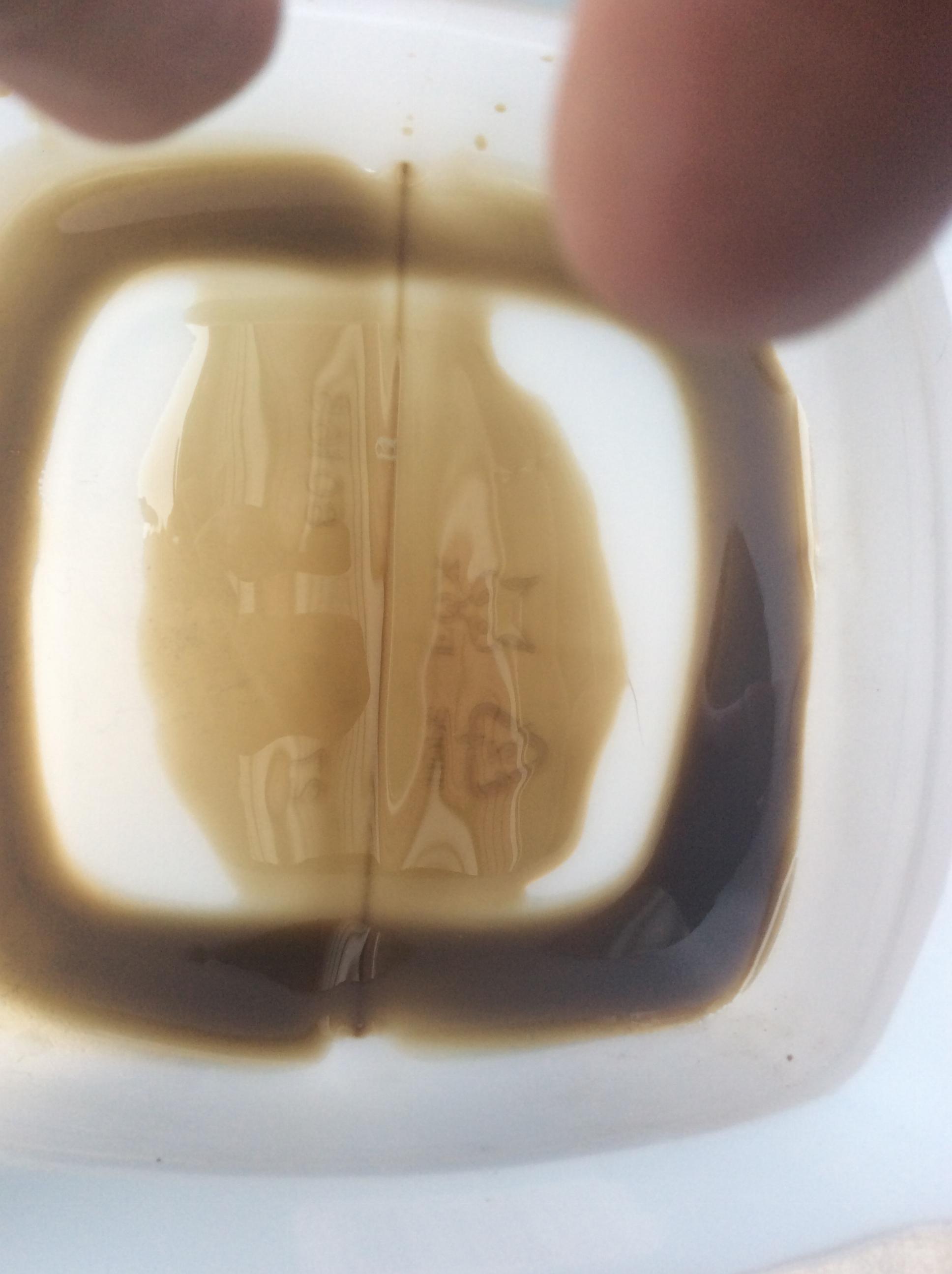

1 hour ago, SeKcGamer said:
You've gone 1/2 circle, from not enough pictures to not enough words.  If you're trying to indicate that there's definitely water in the oil, then...bummer.
Check the cylinders for head-related problems.  Spin the engine with no spark plugs.  If any water droplets at all show up, you'll need to pull the head.  If the PO replaced a head gasket because of overheating he should have had the head checked for warpage.  You might have bought a problem engine.
 Old school method to find water in the oil was to put a drop onto a hot exhaust manifold. Pure oil will just smoke, no noise. Any water in it will sizzle and steam.
Maybe he already has the head off and is measuring for warpage, and looking for cracks.  Could be.  51 degrees in Nampa, good car work weather.
