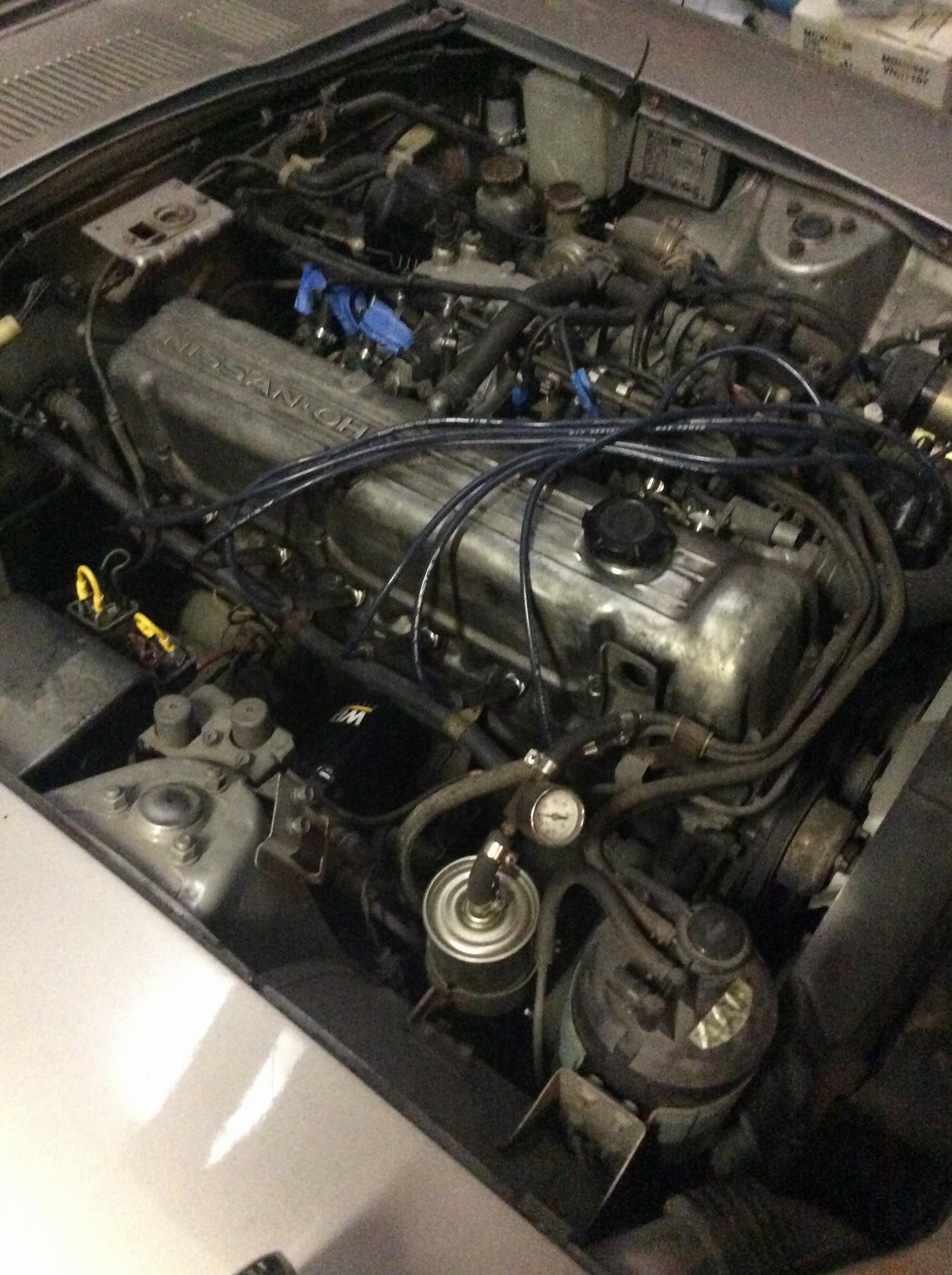

Since it's your first car,and first Z, the best thing that you can do is to read through the Service Manual.  Engine Fuel chapter.  See the link below.  Your fuel pressure is too high, for starters, but there's much more in there.

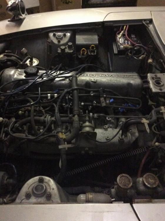

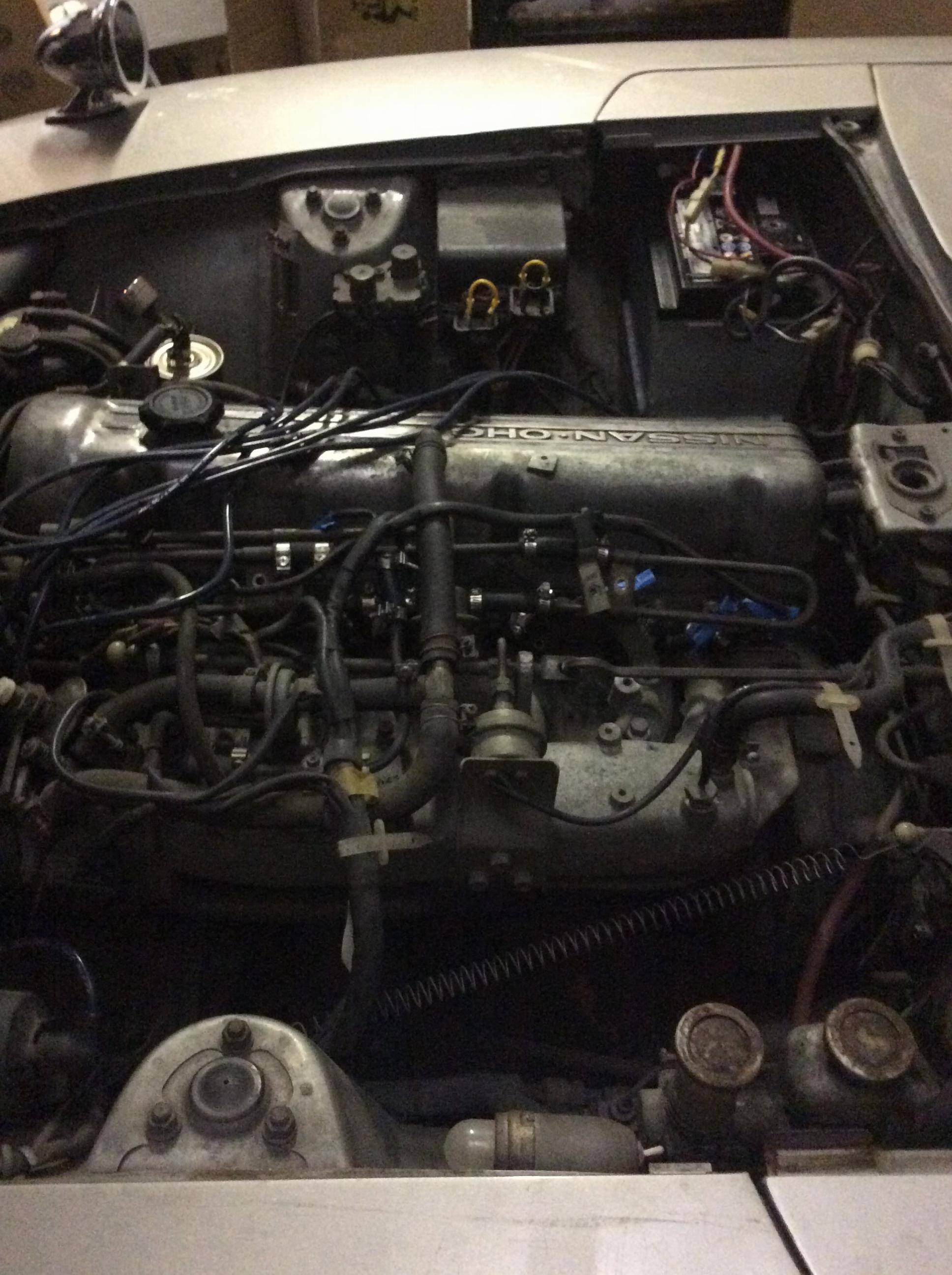

On the pictures, I really wanted to see the " chocolatey color, which means water."  Dark chocolate would be okay, milk chocolate would be iffy.  White chocolate would be bad.  Could be that you've assumed the wrong problem though, there are several things that you can do to confirm.  Since you put new spark plugs in, the old ones should be available for pictures.  Where's the tub full of oil that you drained?  If you give more information, you'll get some good ideas from out here.

I meant when we drove the car it ran perfectly fine. Alright will take some more pictures

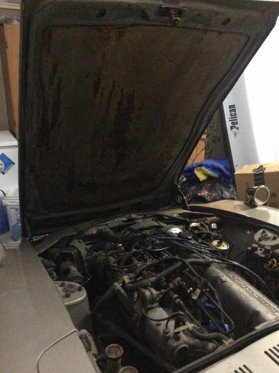

'78s had vents in the hood. The hood has been changed or its not a seventy eight. Could have been in an accident, pretty good one to for a different hood. Fyi
