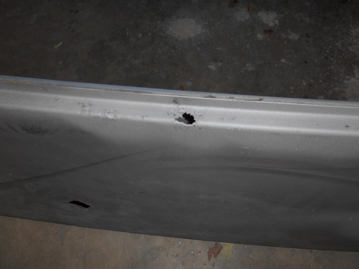

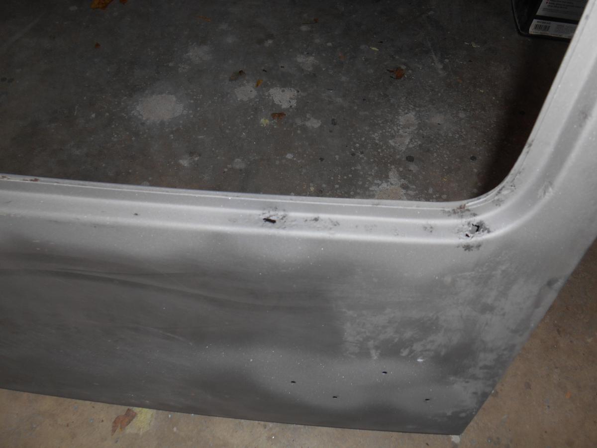

I'm stripping my rear hatch and have some rust issues to repair.  There are a few holes that were under the window rubber.  I'm not sure yet how I'm going to repair them.  Cosmetics isn't too much of an issue since they're under the rubber.  The options I batting around are:
1). Cut out the rust and weld in new metal.  I'm a little concerned about my ability to effect a good repair since  I'll have to fab the patch and the locations a little challenging.  Also I will need to cut out enough metal that the repaired area won't all be under the rubber so I'll have to take care to blend everything and make it pretty.
2). Skip the patch and just try to build up metal with my MIG welder.  This will probably be a little ugly and lead to a lot of grinding in places my 4 1/2 grinder doesn't fit to well.  A dremel would fit but would take forever.  The grinding problem probably applies to #1 too.
3). Fill the holes with fiberglass.  This is probably the most half assed approach, but since the repair will never see the light of day is viable.
Anybody had take make similar repairs?  How did you do it?

I would probably try to MIG them closed. Then use a die grinder with a cut off wheel to knock the welds down. then use a 90 degree die grinder with a  2" 36 grit rowlock to clean the last up. If you have a piece of 1/2" copper pipe, flatten one end so you can hold it up behind the hole. Weld against the copper backer but remember it will get hot fast. My second choice would be small metal patches and dress them the same way...
A weld will always be more permanent and if you have the skills, then complete rust removal is preferred.

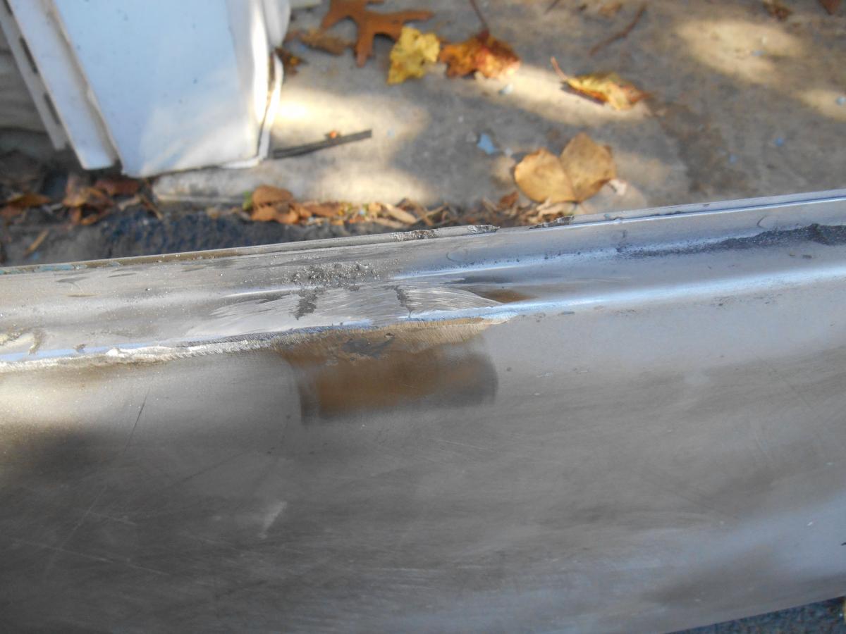

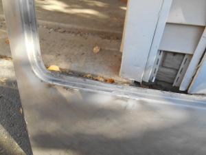

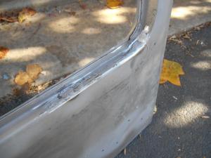

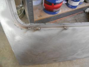

I MIG'd them closed today.  I had already removed all the rust by blasting it yesterday.  It was hard finding good metal.  It kept blowing through which wasn't a surprise.  I finally got it and the results are good enough for my purposes.

Very nice looking repair job. Did you use the copper pipe trick on the backside? I have read about that procedure before but have never tried it for myself. Your work in progress keeps me motivated on my resurrection piece. Keep up the good work, John-Lugoff, SC
I have several different copy pipes beaten into different shapes. Most are 3/4" with a short piece of wood in the uncrushed end. The wood keeps from having to hold onto the 500dF copper pipe after it warms up. Eastwood sells some premade but they are very easy to DIY
 I bought a welding spoon at H.F. $8.99  Nice tool. It has a slight radius to it. I was able to clamp it behind a short section of seam that suffered from "gaposis". It made that section soooo much easier to fill.
No I didn't!  I wish I had remembered that trick.  Probably would've made things easier.
