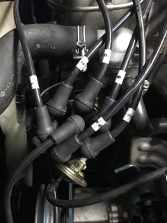

photos are of the distributor with the car running.
I appreciate any help with this, losing my hair at this point.

No timing light?  I don't see any measurements.  The engineers put those degree marks on for an important reason.  It's important.  If you've confirmed where zero is, with your screwdriver method, then you can set ignition timing to its correct spot.  If you set and measure spark at the correct spot then you don't have a timing issue anymore.  When you have that locked down then you'll know that your problems are somewhere else.  Best not to solve two problems at the same time.
You're lucky in that you have an engine that runs.  From here it's a matter of confirming what's right, and making the stuff that isn't, is.

I do have a timing light, but I didn't use it. I was under the assumption that if everything was at zero and aligned the car would atleast idle on it's own(granted the carbs are all set) and then I can use the timing light on it. But even then the engine won't stay on within the lock nut range.
10 degrees is a good starting point.  Zero is not the best.
Sounds like you have the right idea though.  Get the ignition timing right, then focus on the carbs.  But even there, if once carb doesn't have fuel, that's kind of a "needs to be fixed" thing right off the bat.
I'd focus on getting the carb to function properly (gas in the bowl), and setting the timing to 10 degrees.  That's a "should idle" point, then build off of that.
As far as setting timing, even if you have to squirt starting fluid and rev the engine up and down, you should be able to see where the low point is.  Set it to 10 and assume that it's right.  Sometimes you have to make an assumption and work with it for a while.

Ok thanks that makes sense. So this would be the third mark on the crank pulley? And then center the distributor in the lock range? I am sorry i'm asking a lot of questions, new to classic cars.
I hope changing the front float will fix the no gas issue, it always stops working when I insert the float into the bowl. The float might not be aligned.
I wouldn't worry too much about where the distributor adjustments are, if the timing light shows you're right.  All you care about is when the spark happens, not where the nuts and bolts are.  Each mark is 5 degrees so the third should be 10.  10 degrees of advance will give you a faster stronger idle than zero.  Get that set and see if you can get it to idle on its own.  Then you can tweak and tune to make it work better.
