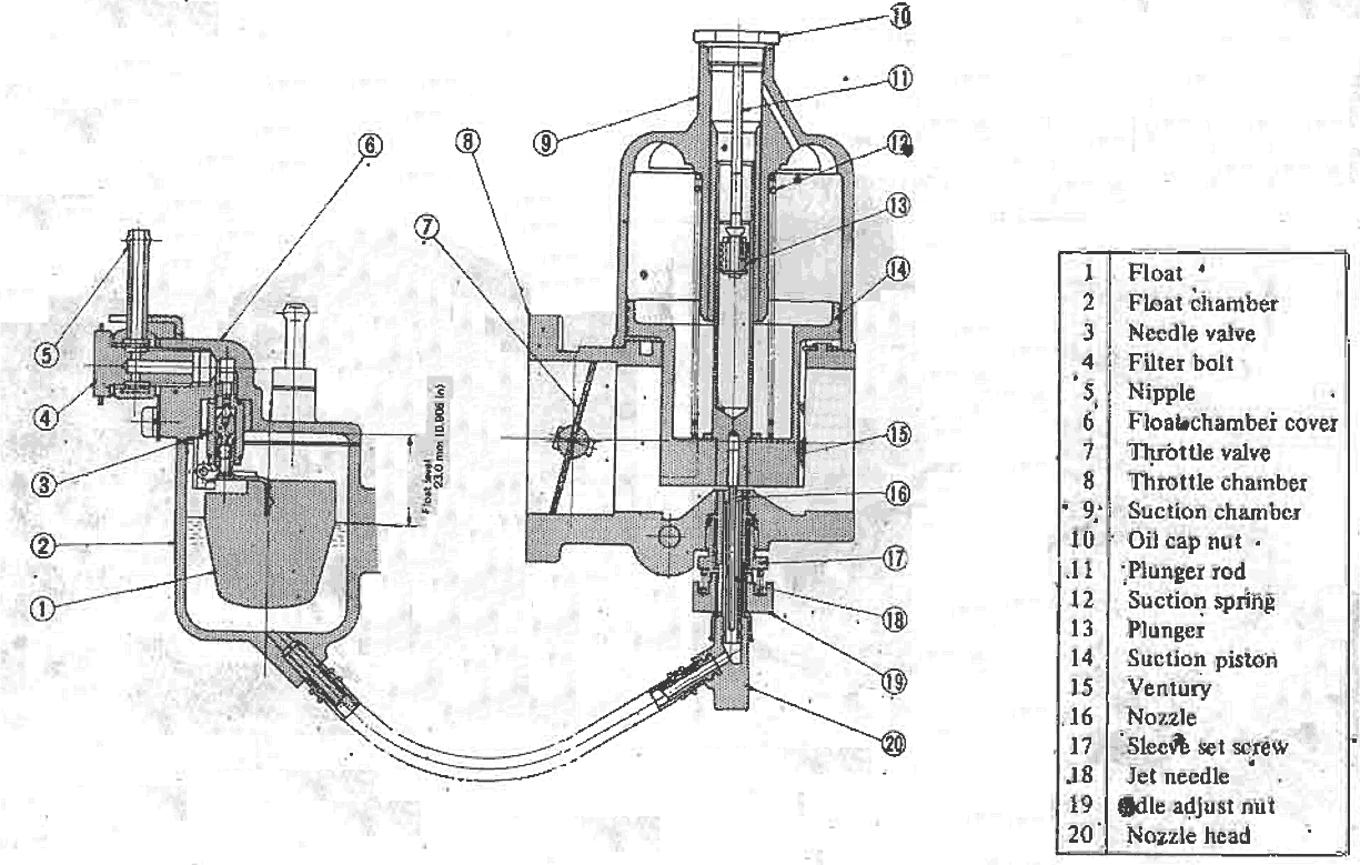

The nozzles maybe too high. Turn the adjustment knob counter clockwise 2.5 turns from the top. They could be stuck, do the nozzles move down when you pull the choke?
They're under the carbs. The hose from the bottom of the float chamber connects to the nozzles on the bottom of the carb bodies.

Front carb.  #19 is what I'm talking about.  Tighten it all the way up, then go counter clockwise 2.5 turns for a general setting.  There's TONs of stuff on here about these carburetor.  I think it may have it's own sub-forum?  It does, http://www.classiczcars.com/forum/71-carburetor-central/

Thanks! My buddy tried to remove the float plate, but looks like it won't come off due the main carb having a tab over it? Do I have to remove the carbs off the manifold to get access to the float chamber?
Nope The float chamber is alongside the carb body. The fuel enters into the top of the float bowl. 3 or 4 screws & probably a new gasket.
I think you are talking about the metal "bracket" (used for lack of the correct word) that has to be bent down around the fuel inlet on top.  You can take the screws out like Mark says and that bracket will be loose, lay it off to the side and gently pry the lids off, probably still tearing the one use gaskets.  :(
Here's a picture of what I'm talking about, it's called a brace.  The big bolt with the internal fuel filter goes through it.  Bottom right corner of this picture is the thing that has to be bent to loosen the banjo bolt.  Probably confusing you more as I'm no good at explaining, sorry.

Ok the plot thickens, I have or(had) gas coming out of the float tube going to the nozzle. This is exactly where the fuel stops. No fuel comes out of the nozzle under the dampers, bone dry. Took apart the front carb, looked decent and set the float. I followed the service manual and back out the fast idle screw and balance screws and then tightened and turned back the nozzle adjusting screw by 3 turns based on ambient temps, I also then put 2 more gallons of gas, I have at minium 4 gallons of gas.
Next step, used carb cleaner to the nozzles, there was no blockage.

Those little hoses have to be just right or they'll kink and you'll have no flow between the float chamber and the carb.  My red 240 had some rock hard 1/4"? fuel line on those carbs that wouldn't let the nozzles move down.  Hard to start.
