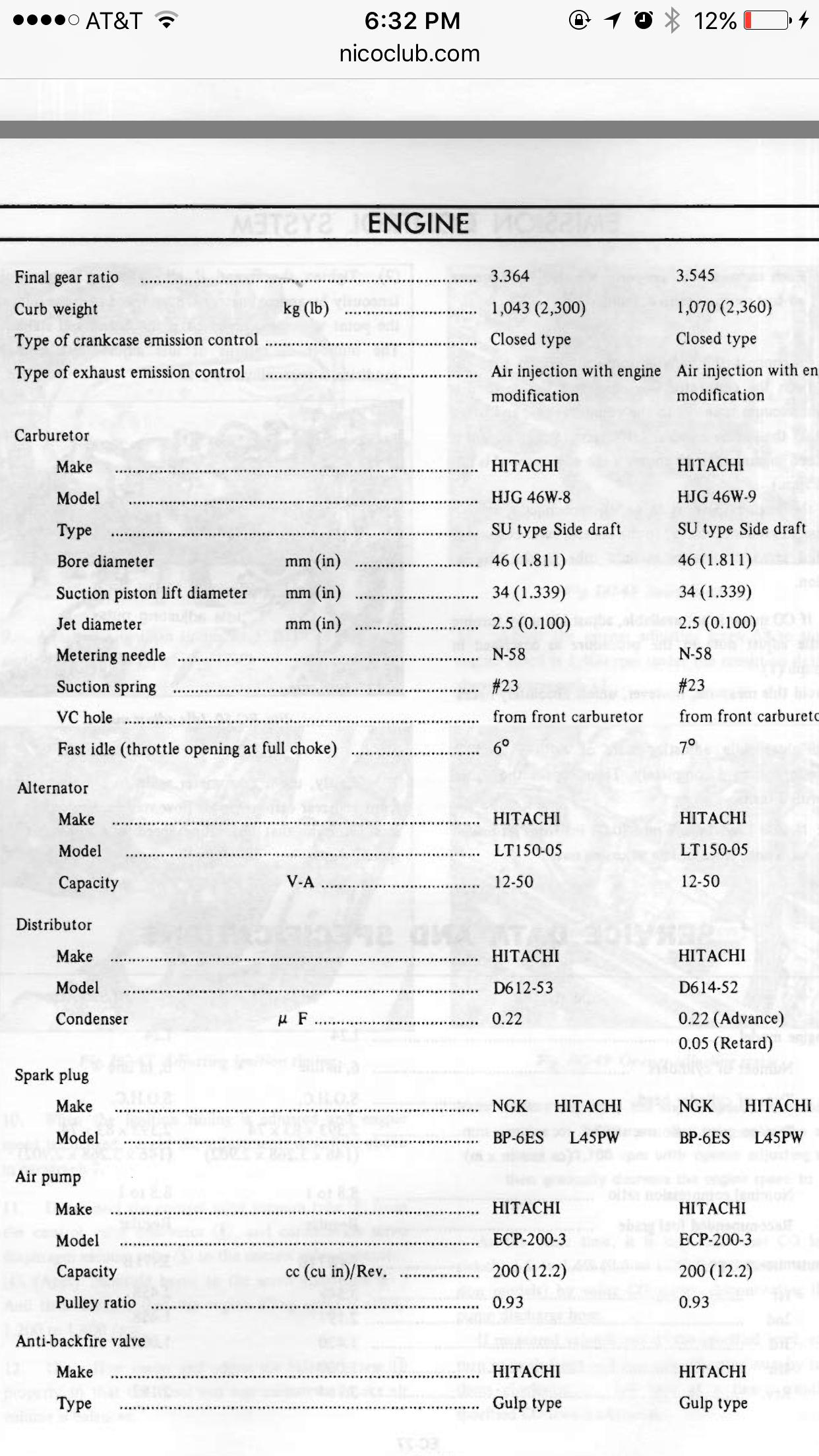

January 1, 20178 yr comment_509393 This picture is from the 1973 FSM. Yours is close. Here's a good old thread with more numbers. But yours isn't there. Mike, Walter's thread would be a good one for the knowledge Base. @Mike Link to comment https://www.classiczcars.com/forums/topic/52647-engine-only-runs-with-starter-fluid/?&page=12#findComment-509393 Share on other sites More sharing options...
January 1, 20178 yr Author comment_509394 I'm thinking it's a euro dist. Edited January 1, 20178 yr by hatepotholez Link to comment https://www.classiczcars.com/forums/topic/52647-engine-only-runs-with-starter-fluid/?&page=12#findComment-509394 Share on other sites More sharing options...
January 1, 20178 yr comment_509397 Do you have a plain old timing light? Just to get your initial timing right. You're spending a lot of time on a simple thing. Or just set it to zero, where it flashes intensely, and use the third mark on the pulley. Link to comment https://www.classiczcars.com/forums/topic/52647-engine-only-runs-with-starter-fluid/?&page=12#findComment-509397 Share on other sites More sharing options...
January 1, 20178 yr Author comment_509399 42 minutes ago, Zed Head said: Do you have a plain old timing light? Just to get your initial timing right. You're spending a lot of time on a simple thing. Or just set it to zero, where it flashes intensely, and use the third mark on the pulley. Unfortunately no, but I will set it to 0 like you stated hopefully that'll work. I did find a reference from @Stanley where the emissions section of the fsm has the d612-53 model number. Link to comment https://www.classiczcars.com/forums/topic/52647-engine-only-runs-with-starter-fluid/?&page=12#findComment-509399 Share on other sites More sharing options...
