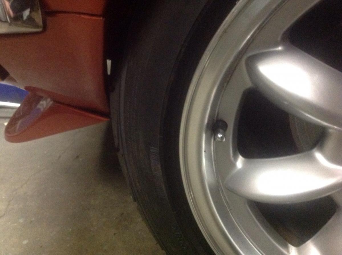

Then the fun began. As I backed it out of the garage in to the lane, I turned the wheel and what should I hear but the lovely sound of front tire rubbing furiously on the front valance! Crap! oh well, off I go to the show. No rubbing on the way, UNTIL I get there and have to crank the wheel to get into a parking spot. Gruncccchhhh... yikes!

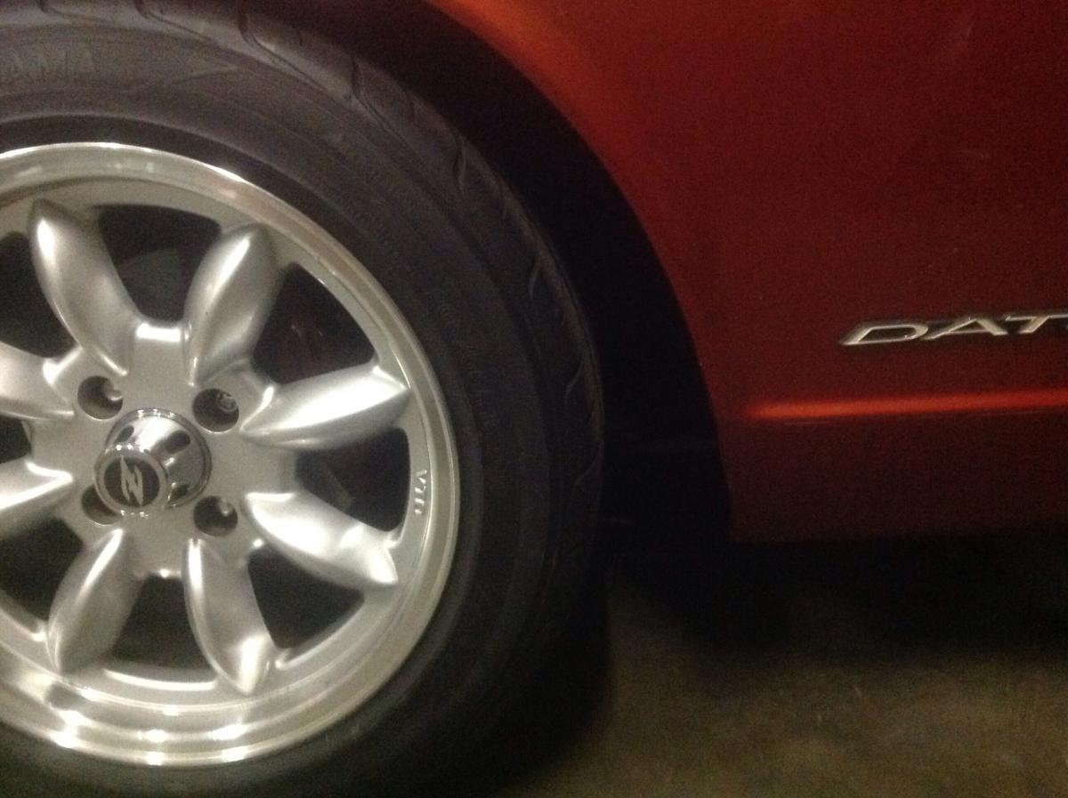

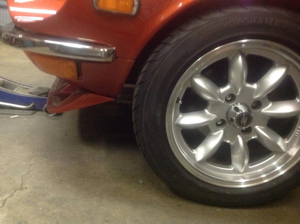

I get out and look (finally) and sure as h-e-double l, the wheels are way forward in the wheel well. Both side nice and even, but way wrong. Great caster setting, but incompatible with my 205-50-16 tires and my stock valence.
Now what the heck is going on? how can stock T/C rods cause this lovely surprise????? Pretty hard to get this wrong. Yes the control arms are on the right side (short side forward), T/C ends tightened all the way to spec. Any ideas gang?

with one turn right, contact!

You know the wheels aren't centered in the well right?  Compare the gap to the back wheels with the wheels straight.  They look fairly normal in your pictures.
I run a 205-70-14 which should be 25.3", with stock parts, and no rubbing, although there's barely a finger's width available when the wheels are turned.  But, your 205-50-16 should be 24.1".  So, there is something odd going on.  Are you sure you're not running a 60 series tire?  25.7".

Thanks for the input Zed. There is quite a difference front to rear to the fender, pictures may not convey well. I see it in the pictures, but then I know what I'm looking at! Barely 2 fingers in front, fully 4 behind. The wheels are not turned slightly, both sides are identical. Hadn't really considered that the normal position may not be visually centered though. Oh, and a correction, I actually have 205-55 16 yoko S-drive tires, 24.8" diameter.

How about rim offset?  Your wheel seems to extend outside the fender well.

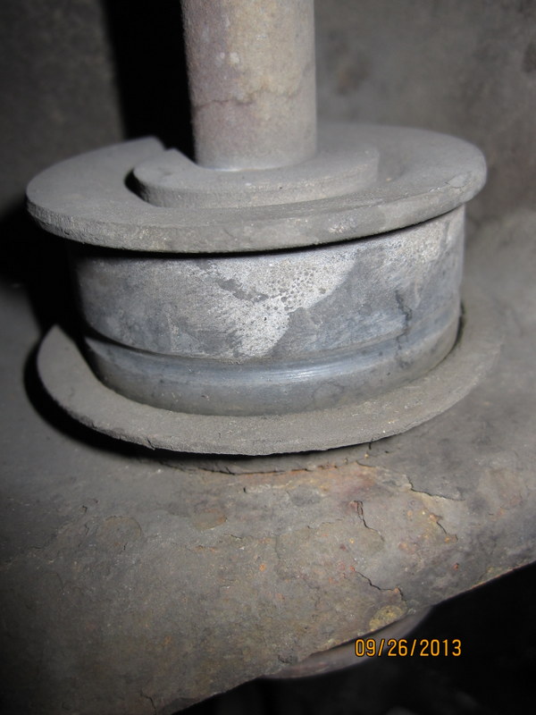

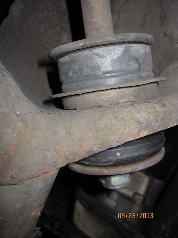

Here's some pictures I took a while ago.  Are your washers set up like these?  Rim offset, plus wide tires, plus a backward washer might push your wheel edge turning radius in to the fender.
Edit - in the picture, the nut at the end of the rod is a second, locking Nylock nut.  When I had poly on both sides the extra stress would loosen the single nut.  I've been paranoid ever since.

Thanks for the confirmation pictures, I'm now sure I have it assembled correctly.

Now when I look at your pics of the bushings with the second locknut, I see rubber bush in the back is not very compressed. This is very different from experience when I put my rubber in front/poly in back. The rubber went damn near flat before I reached lockup length.
I'm wondering if you don't have the unit compressed enough to lock the big washers against the center tube (lockup length, like the rear wheel bearings against the distance piece). That would contribute to the nut backoff problem you're having. Also don't re-use an old nylock or crimp nut.

After re-reading and staring at your pictures above, I realized I put the big washers on backwards.Convex toward the bushing faces, not away from. Duh!
I tore the T/C rods off and switched them. I also put poly bushing on the back (I know I know) to try to get a little less length due to the offset compression of the bushings.
Couple observations. The manor in which the bushings squish is quite different with the washers in the convex to bushing orientation. With the poly on the back, when tightened fully to inner tube contact, the front rubber bushing has squished less (more remaining thickness) then when its washer was concave toward it. Hadn't expected that, but it's true. Other than the rumors of pending T/C failure now, there is clearly ample rubber bushing in front to allow all the TC rod movement I'd ever want or need in any direction without binding or fear or causing undu stress on the rod if the suspension droops or compresses to maximum.
My wheel now sits about a 1/2 further back in the wheel well. Turning now does not rub. I also rolled the valence edge a bit further and trimmed the end of the BRE spoiler to give just a bit more room. One could also loosen the valence mounting bolts and slide it forward a bit to gain a wee bit more room. This idea came from some 'guy' in a PM on the topic, excellent advice I might add... ;)
