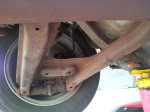

Just took my car to the mechanic on saturday and lifted it on the elevator. Mechanic noticed one of the bushings of the left rear control arm was not installed properly and looks as it is bitten.
Do i need to replace only the lower control arm bushing forward and rear?

Please advise as i do not want to purchase the wrong bushings! I have already replaced all the bushings contained in the Energy Suspension 7.18101R Hyperflex Master Kit for Datsun 240Z. Maybe the former mechanic istalled this one too tight!

I can't tell on the bushing. It looks fine in the picture to me but maybe I am missing something. As for blasting the control arm. Blast them and paint them black or powder coat them black.
It looks like the rubber in the picture is just a round washer-shaped seal at each end of the spindle pin , not a bushing.
You can remove the nuts to inspect and make sure.

I see the problem he has identified - it is the right side inner bushing that is damaged.  Pulling off the outer nut will not show anything.  The only way to be sure is to pull the spindle pin and separate the LCA from the upright.  The damage likely occurred at the time the bushings were replaced - when the LCA was being positioned around the upright.  With new bushings, this is a force fit requiring some lube and gentle working into place.

Isn't that really just a dirt and dust seal?  The actual bushing rubber is inside, between the bushing sleeve and the control arm.  And the bushing sleeve is pressed against the strut casting by the spindle pin nut.  The missing rubber will only allow a little bit of extra water and dirt in to an area that's probably already rusted.  Probably not worth fixing.
This is my  take on it as well. Not a big deal. If the bushing itself is bad there will be discernable play in the joint between the upright and the control arm.
So should i replace the seals or not???
That depends on how you approach the cleaning and painting operation. If you are going to clean and paint in place, I see no need to replace the seal. If you are going to take it all apart to clean and paint you might as well replace the seal while you have it apart.
Replacing the seal would require removing the spindle pins.  It could turn in to a big job for a very small, if any, benefit.  I'd say no, leave it as it is, it won't hurt anything.
