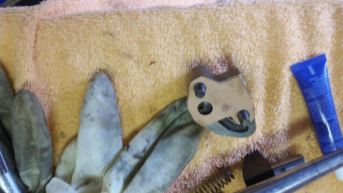

This gasket I have seems incomplete, so I don't want to use it.

I don't have 'em in any of my motors. No problem. Like you say..........the two machined surfaces seal tight. I certainly wouldn't use that gasket....... Doesn't look like it would seal.

I'm not going to sweat it. No gasket. I definetly don't want to use this half gasket in the kit. Don't know if it was meant to be that way or defective.

The Nissan service manual shows a gasket, so it should have one. Leaving it out probably won't cause any problem but if the fit-up is not very good the oil leak could degrade the tensioner performacne somewhat. I would make a gasket myself from a sheet of gasket paper as suggested by DJ. If you don't use a gasket at least make sure there are no burrs or gouges on the mating surfaces.
