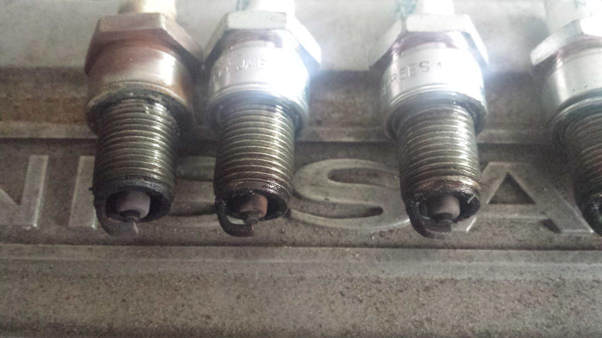

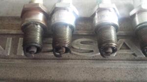

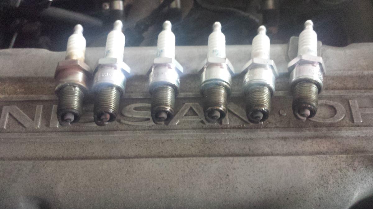

July 23, 201510 yr comment_474375 I visited Jai (pronounced "Jay") on the way back from Zcon15. I looked at her 240z and will make a thread later on that. On her 280z she had me pull the plugs and make pictures while I was there.   This is viewed from the spark plug side of the engine #6 is on the far left and #1 is on the right  Link to comment https://www.classiczcars.com/forums/topic/51762-to-dream-the-impossible-dream-redwings-z-cars/?&page=10#findComment-474375 Share on other sites More sharing options...

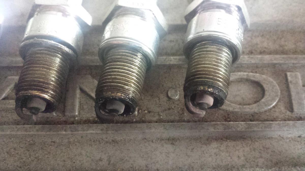

July 23, 201510 yr comment_474376 Closer view    Link to comment https://www.classiczcars.com/forums/topic/51762-to-dream-the-impossible-dream-redwings-z-cars/?&page=10#findComment-474376 Share on other sites More sharing options...

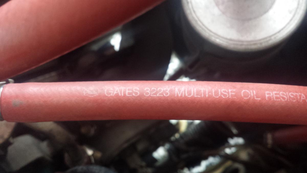

July 23, 201510 yr comment_474377 The red hoses on the fuel filter may be ok. They are Gates multi use but I haven't researched the part number yet. Â Â Â Link to comment https://www.classiczcars.com/forums/topic/51762-to-dream-the-impossible-dream-redwings-z-cars/?&page=10#findComment-474377 Share on other sites More sharing options...
July 23, 201510 yr comment_474379 Nice stuff Charles! Â They look a little rich. Link to comment https://www.classiczcars.com/forums/topic/51762-to-dream-the-impossible-dream-redwings-z-cars/?&page=10#findComment-474379 Share on other sites More sharing options...
July 24, 201510 yr Author comment_474417 The red hoses aren't what i had feared, but they still need replacement with fuel injection rated hoses -- at least the high pressure one from the filter to the fuel rail. And if there's also a red hose before the filter, that should be replaced too. The pictured hose should be fine for the fuel return line. With our systems running at only 36 psi, it's perhaps not an urgent matter, but it should be tended to. Link to comment https://www.classiczcars.com/forums/topic/51762-to-dream-the-impossible-dream-redwings-z-cars/?&page=10#findComment-474417 Share on other sites More sharing options...
July 24, 201510 yr comment_474438 I visited Jai (pronounced "Jay") on the way back from Zcon15. I looked at her 240z and will make a thread later on that. On her 280z she had me pull the plugs and make pictures while I was there.  20150719_155300.jpg  This is viewed from the spark plug side of the engine #6 is on the far left and #1 is on the right  What is the compression readings? Plugs look typical for a motor that could have 250000 miles on it. I am sure miles is unknown as usual . May have never been apart. That is how strong they are. But at some point..... Edited July 24, 201510 yr by lumens Link to comment https://www.classiczcars.com/forums/topic/51762-to-dream-the-impossible-dream-redwings-z-cars/?&page=10#findComment-474438 Share on other sites More sharing options...
