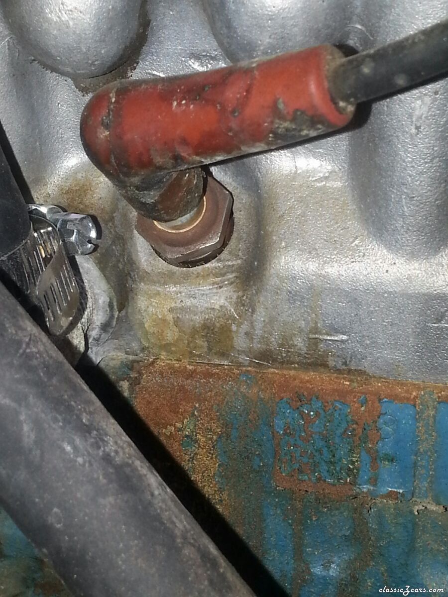

June 12, 201510 yr Author comment_471805 Looking at that plug wire boot, I'd guess it was leaking from that heater hose too. Nice and dry now. You could, most likely, use a new set of plugs. Have you taken one out yet? Maybe wire brush the ones you have. I think I see "BP", the right ones for our cars are BP6ES, gapped somewhere around .035. Edited June 12, 201510 yr by siteunseen Link to comment https://www.classiczcars.com/forums/topic/51639-redwing-nice-young-woman-needs-our-help/?&page=2#findComment-471805 Share on other sites More sharing options...

June 12, 201510 yr comment_471812 Looking at that plug wire boot, I'd guess it was leaking from that heater hose too. Nice and dry now. You could, most likely, use a new set of plugs. Have you taken one out yet? Maybe wire brush the ones you have. I think I see "BP", the right ones for our cars are BP6ES, gapped somewhere around .035. Cliff/Jai, Whose car is has that engine? I see a pretty good crack in that head, right above where the boot makes a right turn down. Link to comment https://www.classiczcars.com/forums/topic/51639-redwing-nice-young-woman-needs-our-help/?&page=2#findComment-471812 Share on other sites More sharing options...
June 12, 201510 yr Author comment_471813 Good eyes/catch Steve, I didn't even notice that. It's Jai's picture from her gallery. Link to comment https://www.classiczcars.com/forums/topic/51639-redwing-nice-young-woman-needs-our-help/?&page=2#findComment-471813 Share on other sites More sharing options...
June 12, 201510 yr comment_471817 That's the boss for the #6 exhaust rocker pivot. Probably unlikely to leak anything? I would think a good welder could touch that up, even without removing the head. It might not even be necessary if the crack is stable. The big question, though, is whether there's chocolate milk in the crankcase. The engine should definitely get a round of new plugs and wires. That's never a bad thing. Link to comment https://www.classiczcars.com/forums/topic/51639-redwing-nice-young-woman-needs-our-help/?&page=2#findComment-471817 Share on other sites More sharing options...
June 12, 201510 yr comment_471818 I think I see JB Weld on the fitting where it was leaking.I think I would pull that apart to see what's going on.And install new pipe fitting. Link to comment https://www.classiczcars.com/forums/topic/51639-redwing-nice-young-woman-needs-our-help/?&page=2#findComment-471818 Share on other sites More sharing options...
June 12, 201510 yr comment_471822 I don't think it's a crack. I think it's a shadow. Hard to say from the picture though. And I'm not sure if that's JB Weld either. It could be a liquid sealer used when the connector was threaded on. Both are worth a closer look. Chuck Link to comment https://www.classiczcars.com/forums/topic/51639-redwing-nice-young-woman-needs-our-help/?&page=2#findComment-471822 Share on other sites More sharing options...
