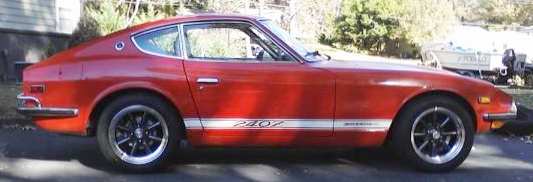

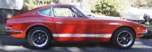

June 3, 201510 yr comment_471222 I have 16 x 7 Konig Rewind's on my car with Zero offset and 225/50x16 Conti Extreme DW's. The steering is a bit too heavy with the 225's.. 205/55x16's will fir perfect with that size rim ( 16 x 7 ) and will be a bit easier to steer. Easier to fit than 225's x 16's if car is lowered as well. 2003 was a long time ago. There are ton of wheels for these cars in 16" and 17" now. Original bolt pattern is 4 x 4.5" ( 114.3mm ) as noted. Edited June 3, 201510 yr by Chickenman Link to comment https://www.classiczcars.com/forums/topic/51608-wheelsrims-for-1977-280z/#findComment-471222 Share on other sites More sharing options...

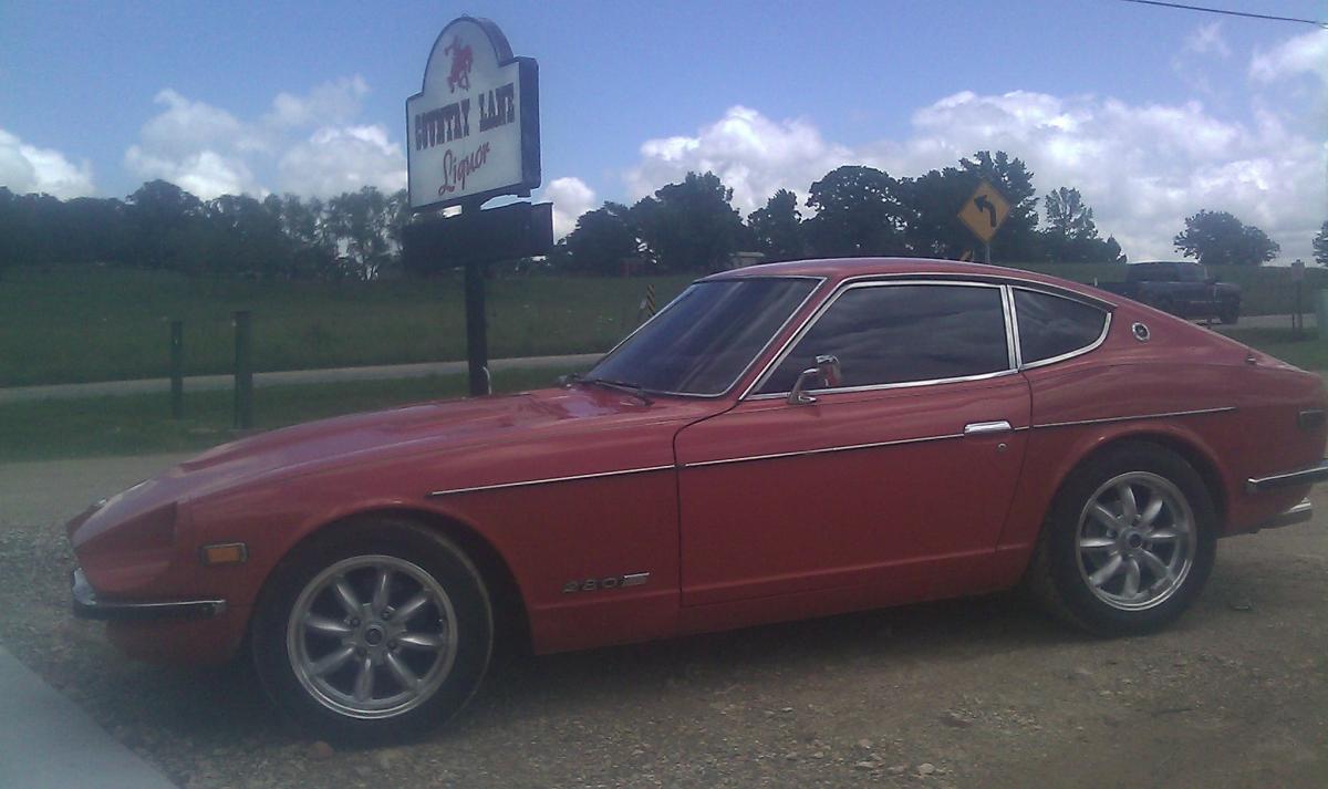

June 4, 201510 yr comment_471223 I agree with Chickenman. I have a lowered 77 with 16x7 Rota's & 205 55 16 Dunlops, Fit is perfect. Link to comment https://www.classiczcars.com/forums/topic/51608-wheelsrims-for-1977-280z/#findComment-471223 Share on other sites More sharing options...

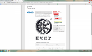

June 4, 201510 yr Author comment_471226 Thanks everyone! I was looking at a few of the Konig wheels for my Z, so this all sounds good! Link to comment https://www.classiczcars.com/forums/topic/51608-wheelsrims-for-1977-280z/#findComment-471226 Share on other sites More sharing options...
