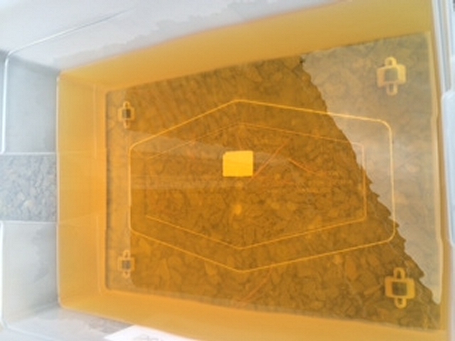

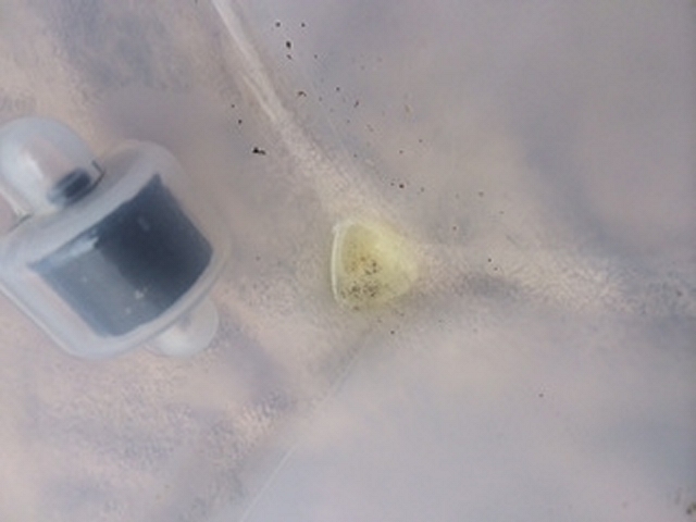

This is what came out of my friend's tank who suffered from debris causing his car to randomly die..... just a few flakes.
Try not to be deceived.
When your car dies, check immediately for spark and also check for fuel in the bowls.
