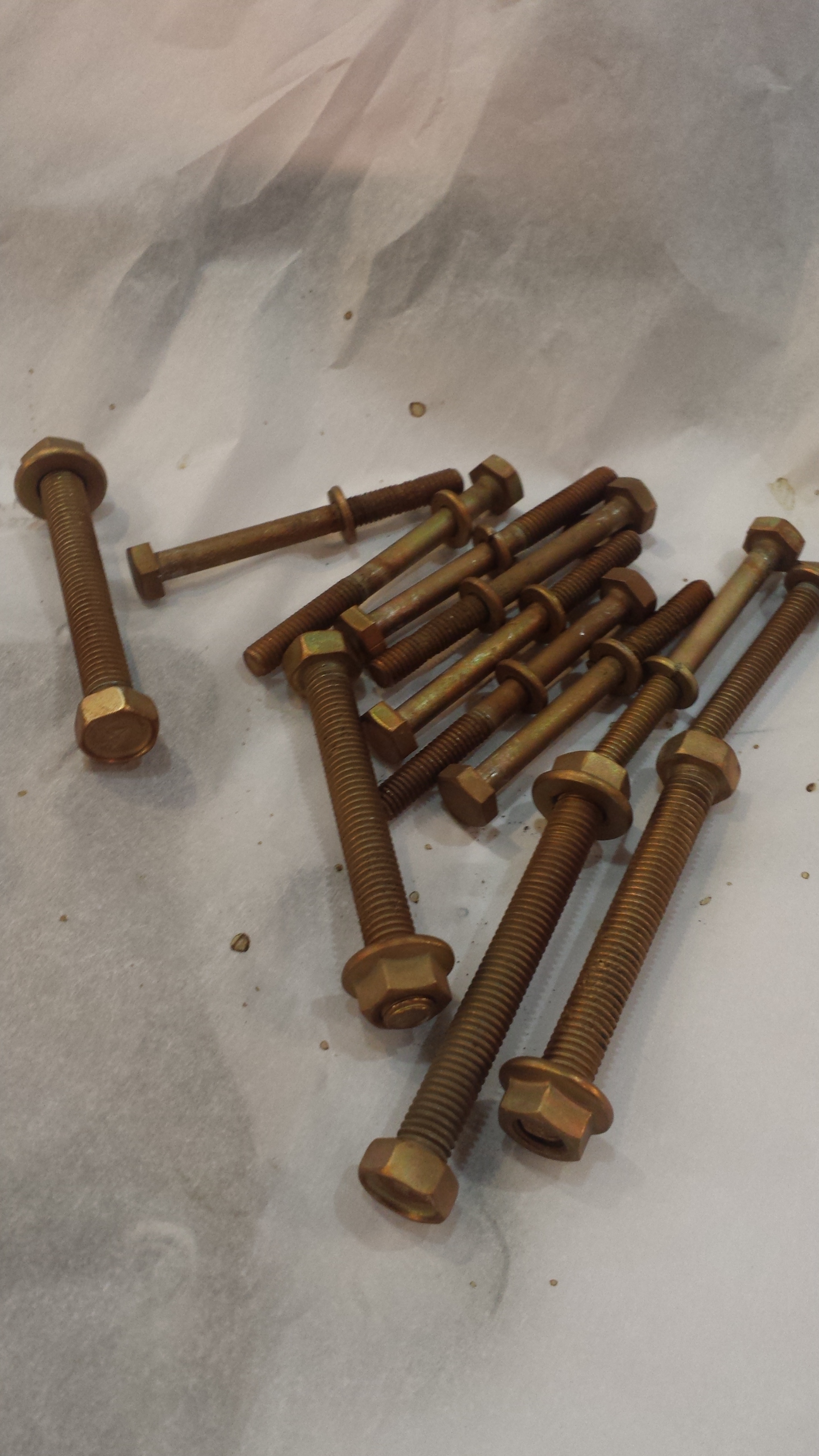

I did use all the blue chromate when I mixed it up. I hate it that Caswell doesn't send as much blue as the yellow. When I used the blue before the pieces brightened up almost immediately, After adding water, even after 2 minutes they don't brighten up like that...that's why I wanted to check Ph levels...
I ordered a Ph meter from amazon for $20...
As an aside I plated some hardware yesterday. The blue didn't brighten it the way it should but aside from that I baked this batch because it goes on the skid steer I'm rebuilding. The baking seems to darken them up even more and they seem to have a brown tone too...
I have never considered the blue chromate as a brightener.  The blue helps with the 'rainbow' effects and sets up a good base for the yellow.  Usually my bolts come out dark or brown when I leave them in the yellow for too long.  I have heard what Blue mentioned above, nitric acid as a brightener, but I have never used it.

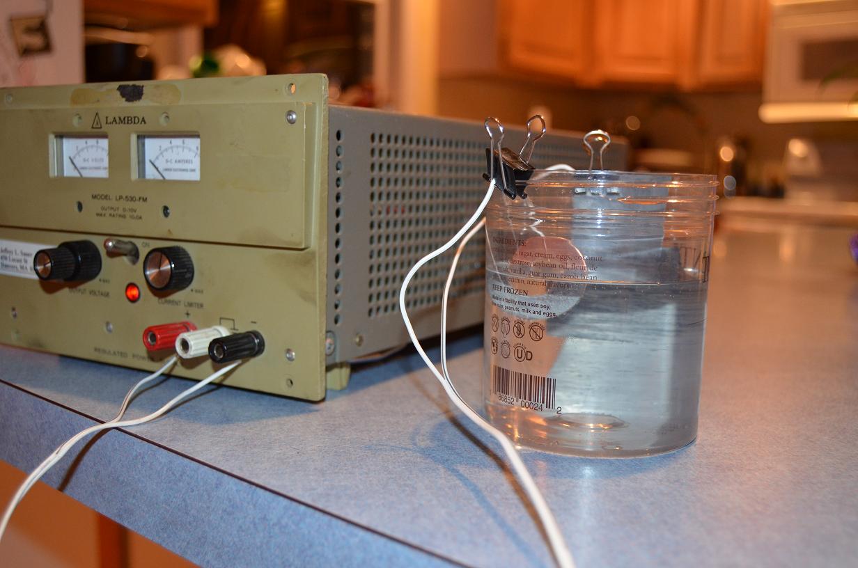

Battery charger or 6V power supply - one dry cell battery works just fine.
***Mix the sugar, salt and vinegar. Line a small plastic tub or pail with the zinc and make a triangular fold in the flat stock so that one end sticks up and over the side as the negative electrode connection point. I put a small piece of copper tubing across the top and bent up some copper (14g romex) wire S-hooks to hang my parts. The battery charger Positive (+)terminal goes to the zinc, and the Negative (-) goes to the copper bar or the part to be plated. When you hang the parts off the copper into the solution, it completes the circuit.
***Wire wheel all loose rust and scale and crud off the parts, clean with hot soapy water to degrease if necessary. Put part on copper hook. Dip part in acid (don't breathe it) to de-rust, then in baking soda and water to neutralize, then dry with paper towel and dip in acetone to completely degrease (denatured alcohol works too). Then let the acetone evaporate and place the part into the vinegar and salt bath by hanging on the copper bar.
