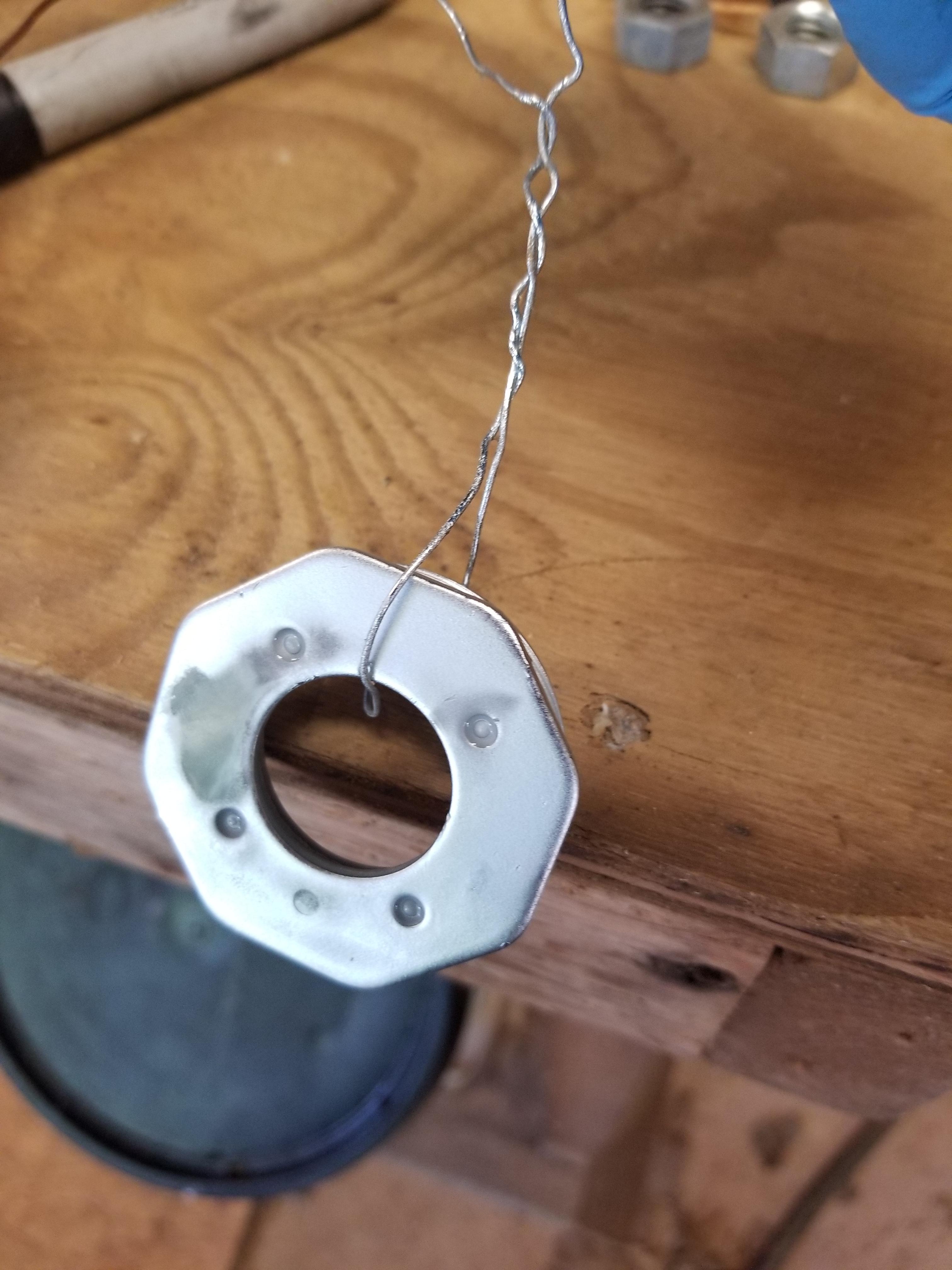

I didn't pickle the first part and I checked it for being clean with a water test. Plated it at 1.2A for about 30 minutes. Rotating it about every ten minutes. I also added a tablespoon of brightener to the tank as Caswell thought this was why the plate was dull.
Much better results except for one spot on the first part. I did them one at a time and I strung them on a loop of wire through the center. The mark is a dark stain almost like an oil spot but it was right under where the loop was contacting the part...
Even after I rotated the part away from the wire and plated it some more it didn't go away. I wrote this is off to the overly quick prep work

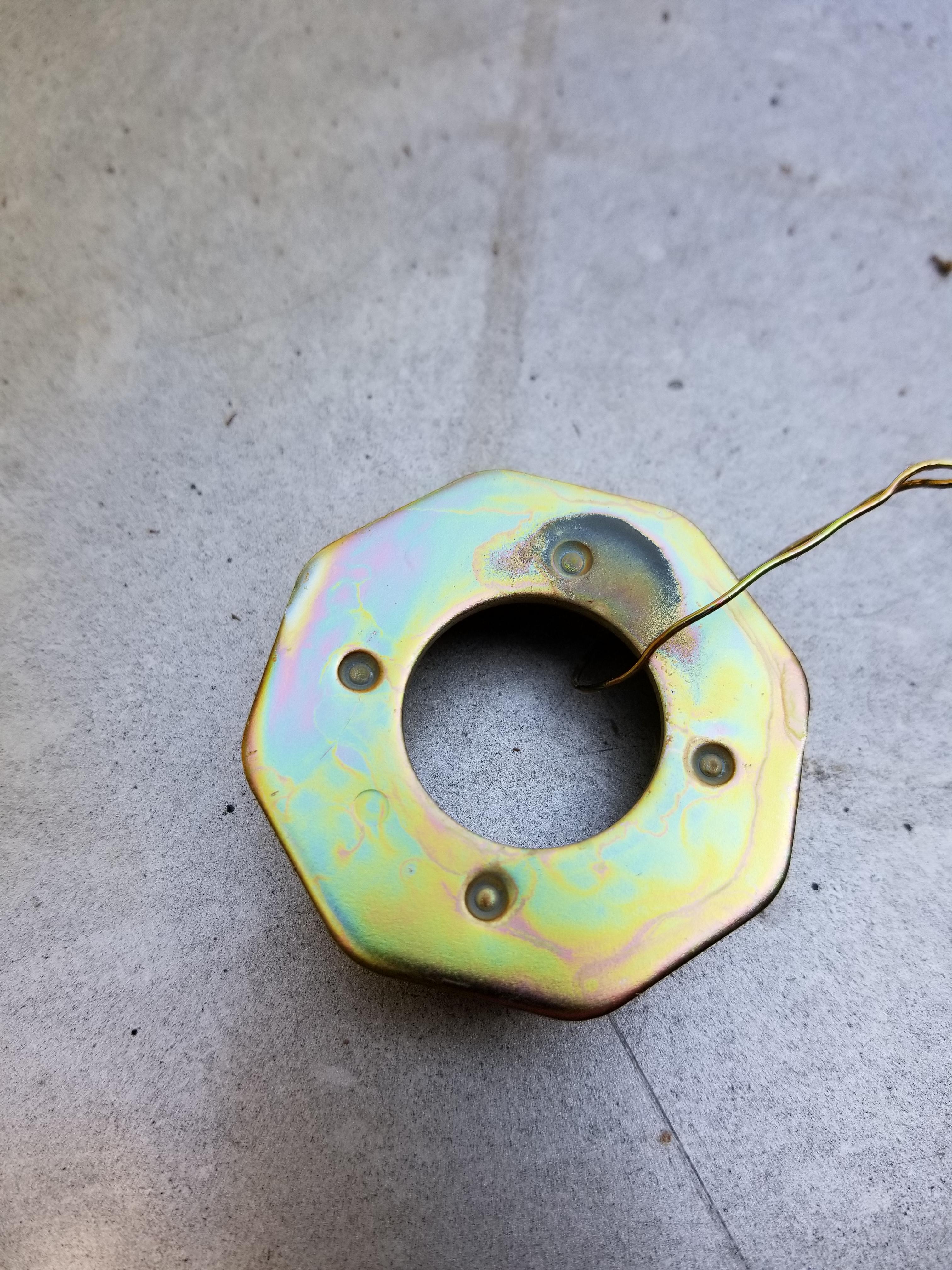

I did a 60 second blue dip and a 60 second yellow dip. Dried it on low with the heat gun. Did good overall except for the spot which didn't take any color...

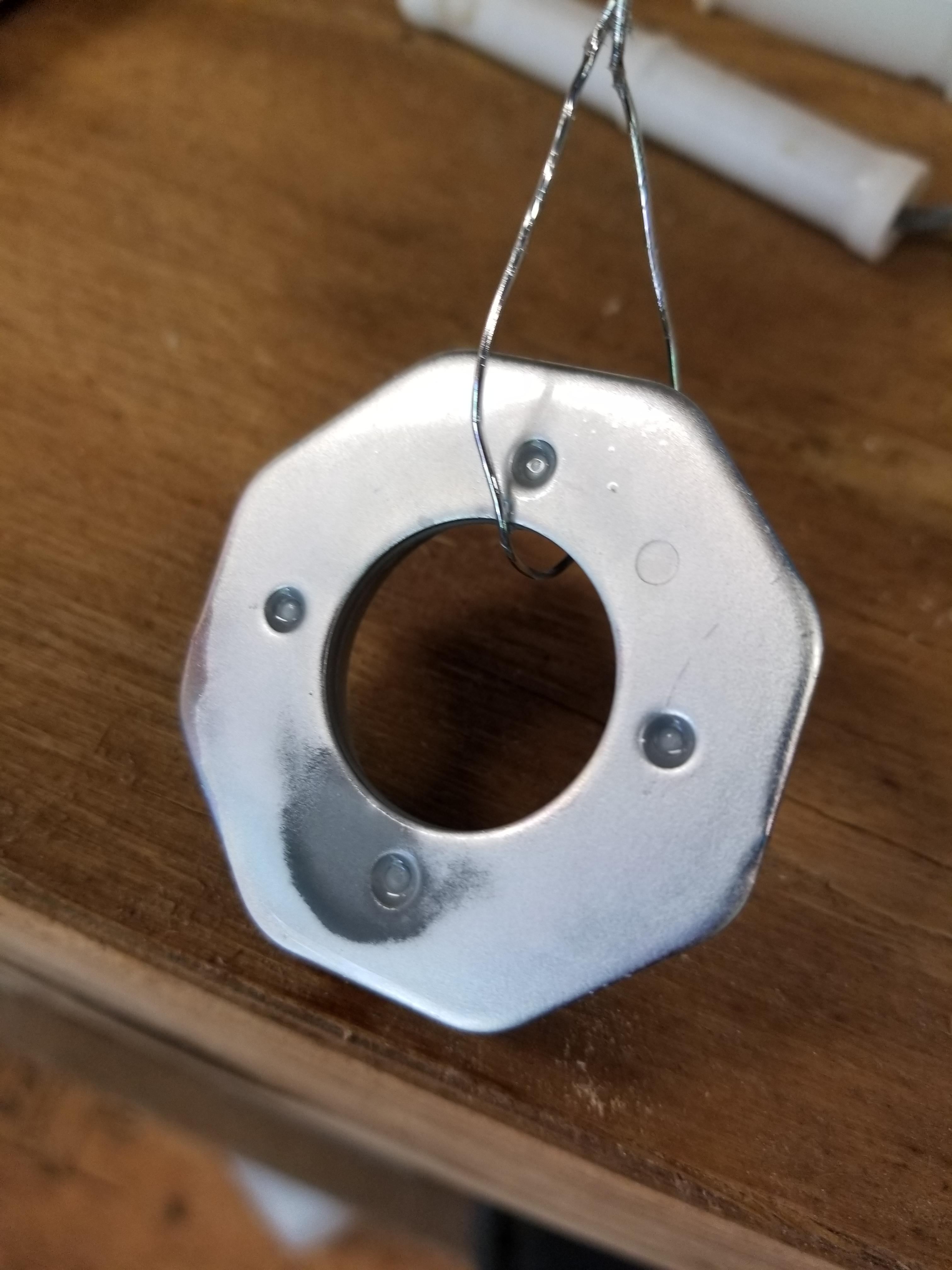

I ran the second part but I pickled it for a minute or too with no real bubbling. Then plated it the same way. I got a similar spot under where the wire was sitting on the part???? Has anyone seen this happen before ?? @motorman7 @Namerow

So Here are my guesses:
1. Contaminate on the wires I am using
2. Burned the part where the wire met it
3. Didn't plate where the wire met it
4. Contaminate on both parts and coincidentally lined up with both plating wires
5: Plating wire is too small for the amperage
My gut instinct is #1,2 or 4. It seemed like the wire made a secondary mark on the first part where the wire was hanging the second time (The dark stain at 2 O'clock by the weld in the first picture)
Anyone else have any thoughts or solutions?
I wonder if the wire is acting like an electromagnetic cage, so that it sets up some kind of adverse electrical field in the zone where you get the dull spot?  You'll probably say, 'Why don't I get the same effect when I plate a regular flat washer?'  My guess is that this particular part is 'deep' enough in section that it shows some of the plating characteristics of a hollow tube.  If you're still feeling 'experimental', try this:
Sandblast one of the two parts to take it back to bare metal (hopefully, this will get rid of any residual problems in the dull-plating zone).  Now try a centralized supporting system for the part when it's in the plating bath.  I'm thinking you could take a length of wire and wind it into a coil that's about 10% bigger than the ID of the centre hole in the strut cap.  The idea would be for the wire coil to be under enough compression when you put it in the hole so that it will grab the part.  This is just a WAG... but that's what drives scientific investigation sometimes.
(When you enter the world of DIY plating, I figure you deserve to call yourself a scientist.  It sounds a lot more confident that 'wizard' LOL )
