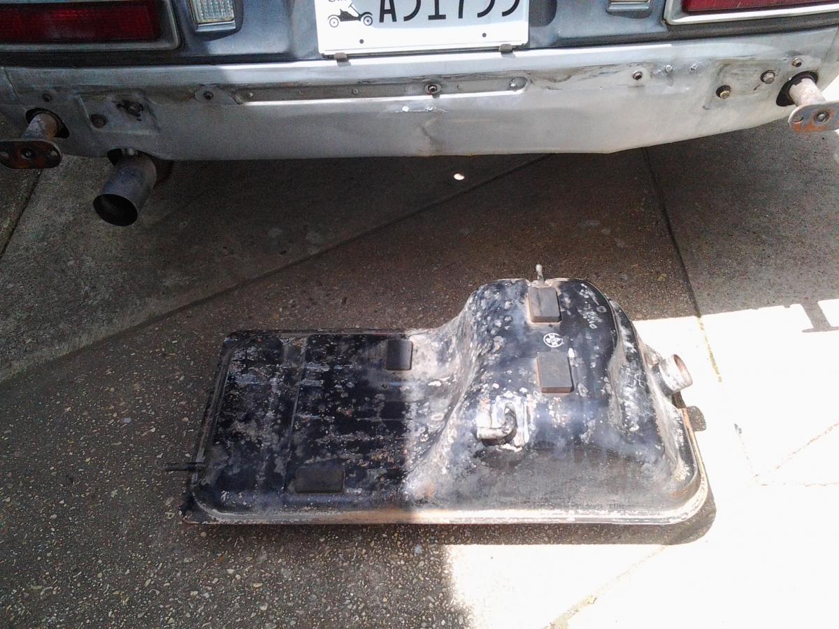

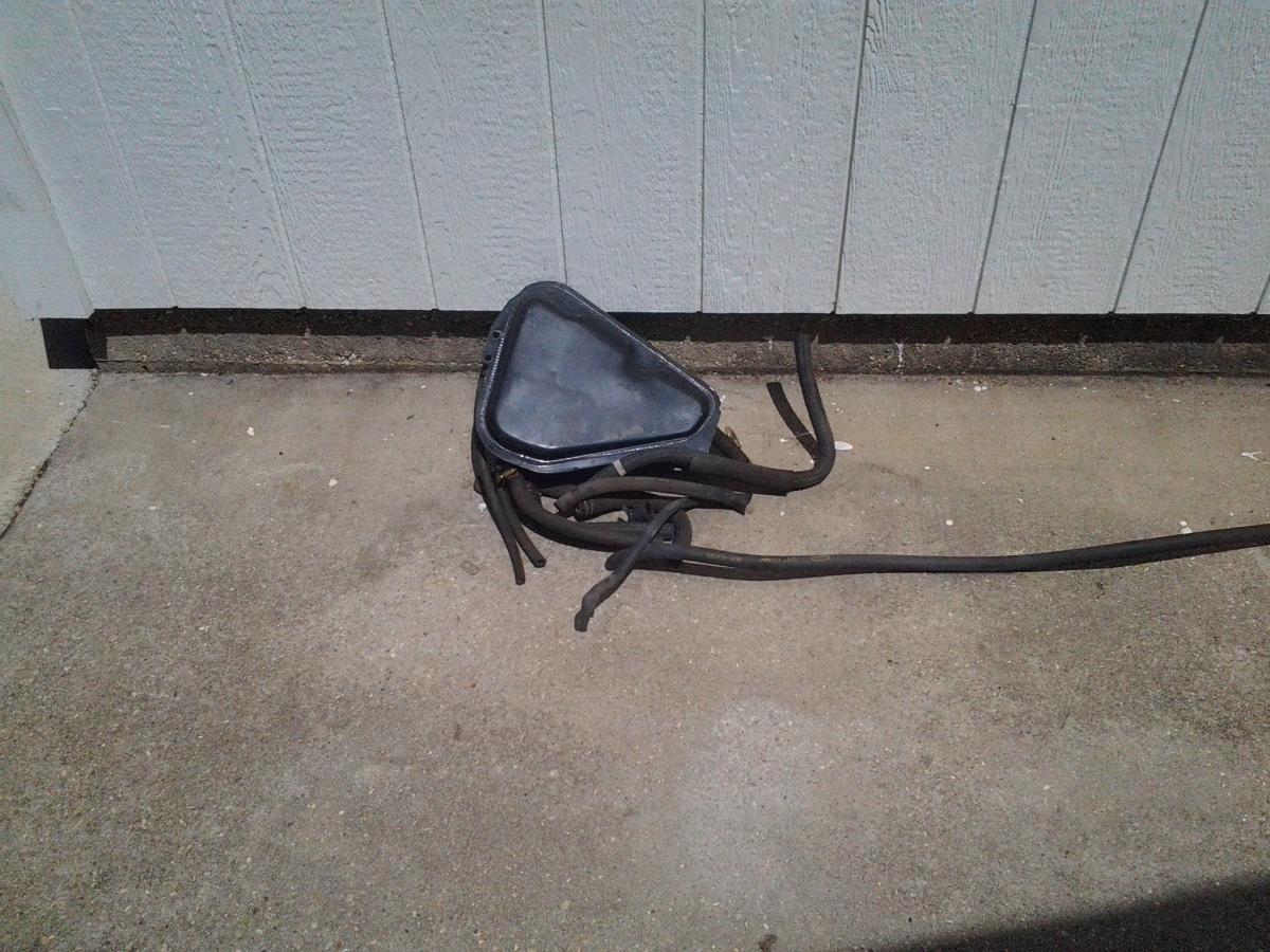

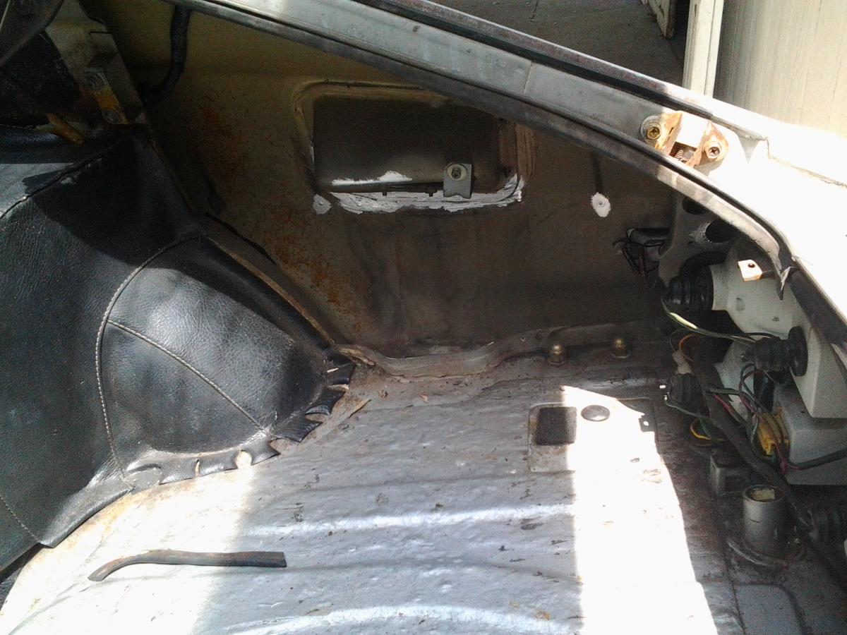

Well, I'll be.  Somebody already removed my interior panels, so I did not recognize them.  Here is my stuff.
post-29227-0-95957100-1428600118_thumb.j
post-29227-0-41376000-1428600146_thumb.j
post-29227-0-62369900-1428600191_thumb.j
If you decide to replace the hoses use a length of nylon cord or string and lay it around each hose then measure that.  Add an extra 10% then round up to the next foot so you'll have plenty.  I looked for my receipt from O'reilly's for lengths and part numbers but couldn't find it.  For the 90 degree bend I used two 3/4" P.E.X elbows with 5/8" low pressure fuel hose.
I'm going to delete the vapor tank and run the big filler vent hose direct to the gas tank.  I believe it is 5/8, I'll look for some pex fittings at the hardware store.
