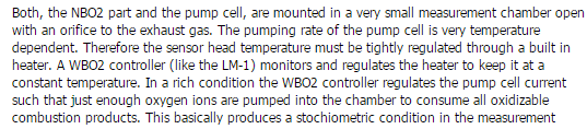

The only thing it does is detect oxygen- that's why it's called an oxygen sensor.  It doesn't detect fuel at all.  Neither is it an indication or guarantee that ALL the oxygen in that went into the cylinder was used up. If you disconnected the spark plug(s) it would detect a LOT of oxygen that passed through the cylinder, unburned, as well as a lot of fuel, and would probably give you a lean "reading."  That's if it didn't get fouled by the fuel.
Problems like these are why we have hobbies like Z cars in the first place.  Worlds colliding here...
I'm focusing on the narrow-band sensors.
It still doesn't tell you the air-to-to fuel mixture of what is going into the cylinders.  It tells you how much stuff  there is in the exhaust that can be oxidized.  Don't forget that only certain sensors have the Nuernst pump or the heater.
Most people in those Youtube videos are using the narrow-band sensors and claiming they have an air-fuel-ratio meter.
