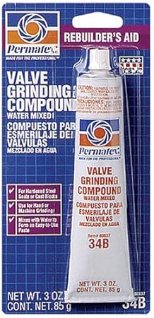

I'm no engine builder, but I've lapped a couple valves and about the only advice I can offer is... To start, use a finer grade of lapping compound than you think you need. You can always move to a more aggressive grit later if the fine stuff doesn't do what you need. And if you're not trying to get rid of large imperfections, you want a fine grit.
And I don't recommend this stuff... They call it a "multi-grade" compound where there is a mix of different sized particles in the base slurry and as you use it, the larger particles move out of the way letting the smaller ones make contact:
Unfortunately, I think that's the only stuff you can walk into your parts store and buy off the shelf. I've got a couple fixed grades that are much fine than this. I think I have a lifetime supply and would be happy to send you some of what I have.
Thank you for the offer, I'll keep that in mind because that's exactly what I bought ("Obviously")!  LOL
I need to think more about my problem.  I haven't tried any type of liquid yet, just the old mouth over hole redneck check.  All of them, but that intake, I can suck until my eyes get blurry.  That one, not as tight.  I'll figure out how to measure the straightness of the valve first.
