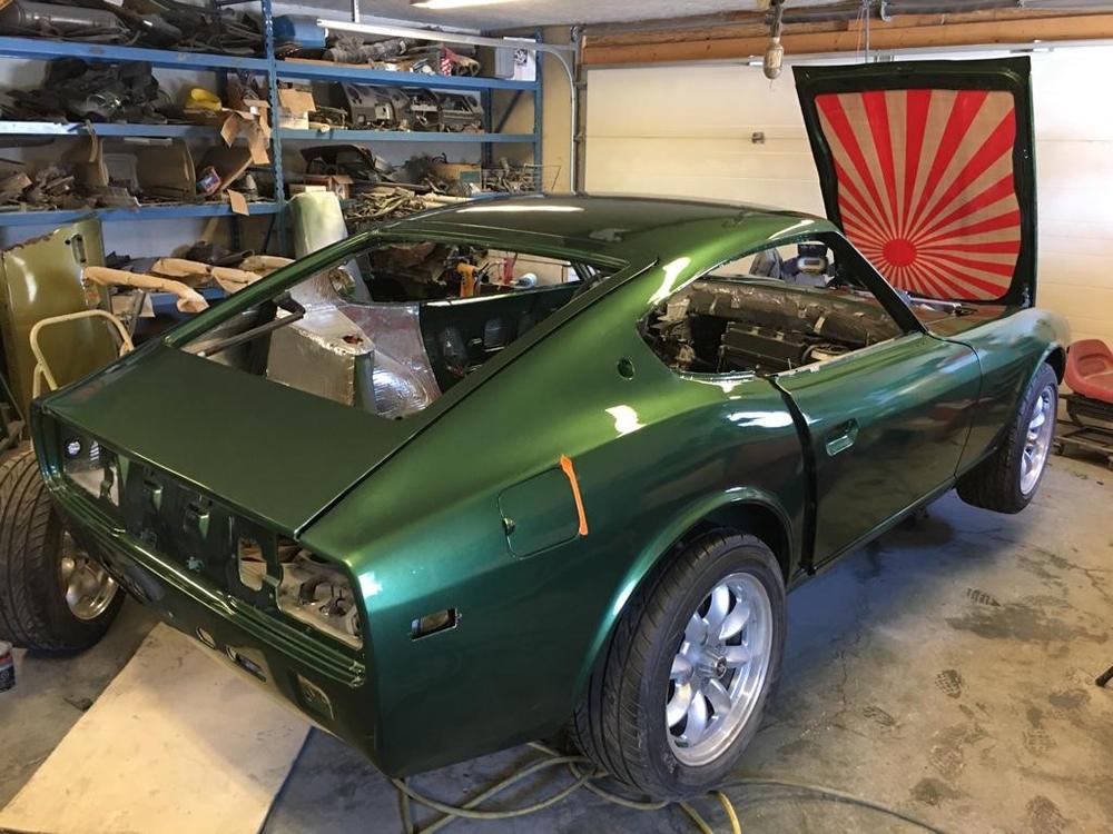

Gratuitous beauty shot...

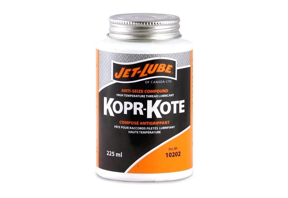

Does anybody know what the best grease/lube would be for the linkage joints that will last for many years without getting sticky or washing away?  Getting the linkages out was not easy, so had my car been a pristine car like Mark's, I wouldn't want to have to snake them out more than once.  In my case, it's not a big deal if I scatch something getting them out and back in, but I'd love to know what other people do with nice cars.
I used Kopr-Kote. After thinking about grease or other lubricants, the copper will last the longest and endure heat and cold well. The factory stalk boots I picked up from Nissan fit like a glove and sealed the top of the rotating mechanism with a watertight seal. Very impressed with the fit.
