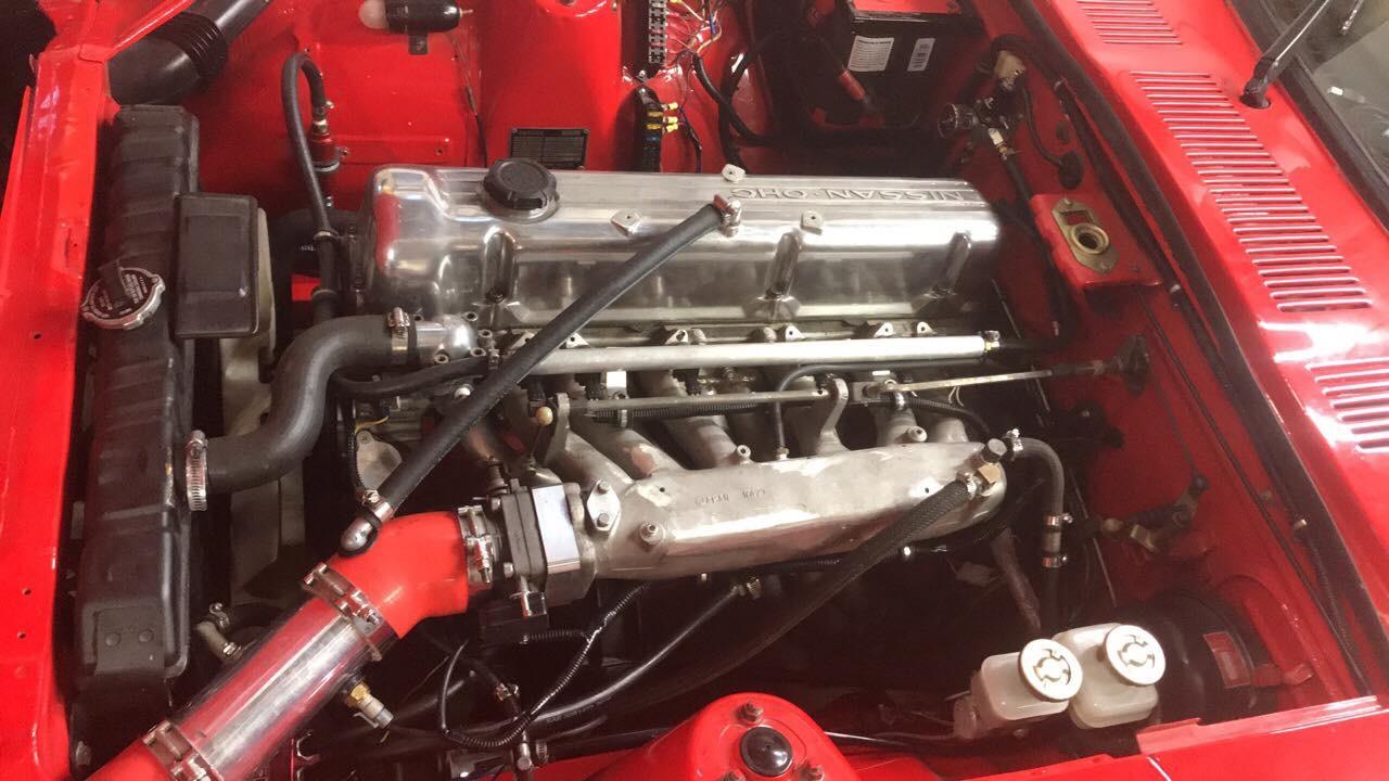

 Build is looking good. Too late now but I would have mentioned that you could shove 14mm high impedance injectors in the stock manifold and they will seal. Probably a mute point if have a 11mm fuel rail. I’m running Audi 1.8 Bosch type now.
As far as catch can , PCV, etc, I added a pic of mine . You said you run a catch can, probably plumbed the same way. There’s a few hoses there if you can pick it out. The hose off the intake is for the IAC . The can catches more than I thought.
I like how you cleaned the intake up. I need to do a cable myself to get rid of the linkage.

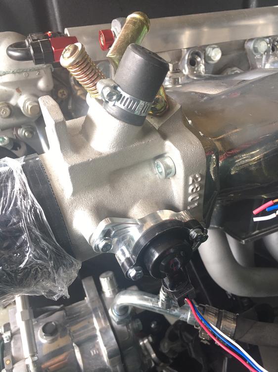

TPS sensor plate came in today too!
I was ready to go that route when I thought I was having issues with my TPS . Looks like a cool set up

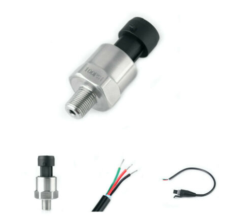

I also added a fuel pressure monitoring circuit to the return fuel line on the recommendation of my Z Car Club. The Haltech can monitor the pressure and shut down the timing if the fuel pressure drops below a preset. Cool! This along with two liquid pressure gauges in the engine bay should keep me well informed.
