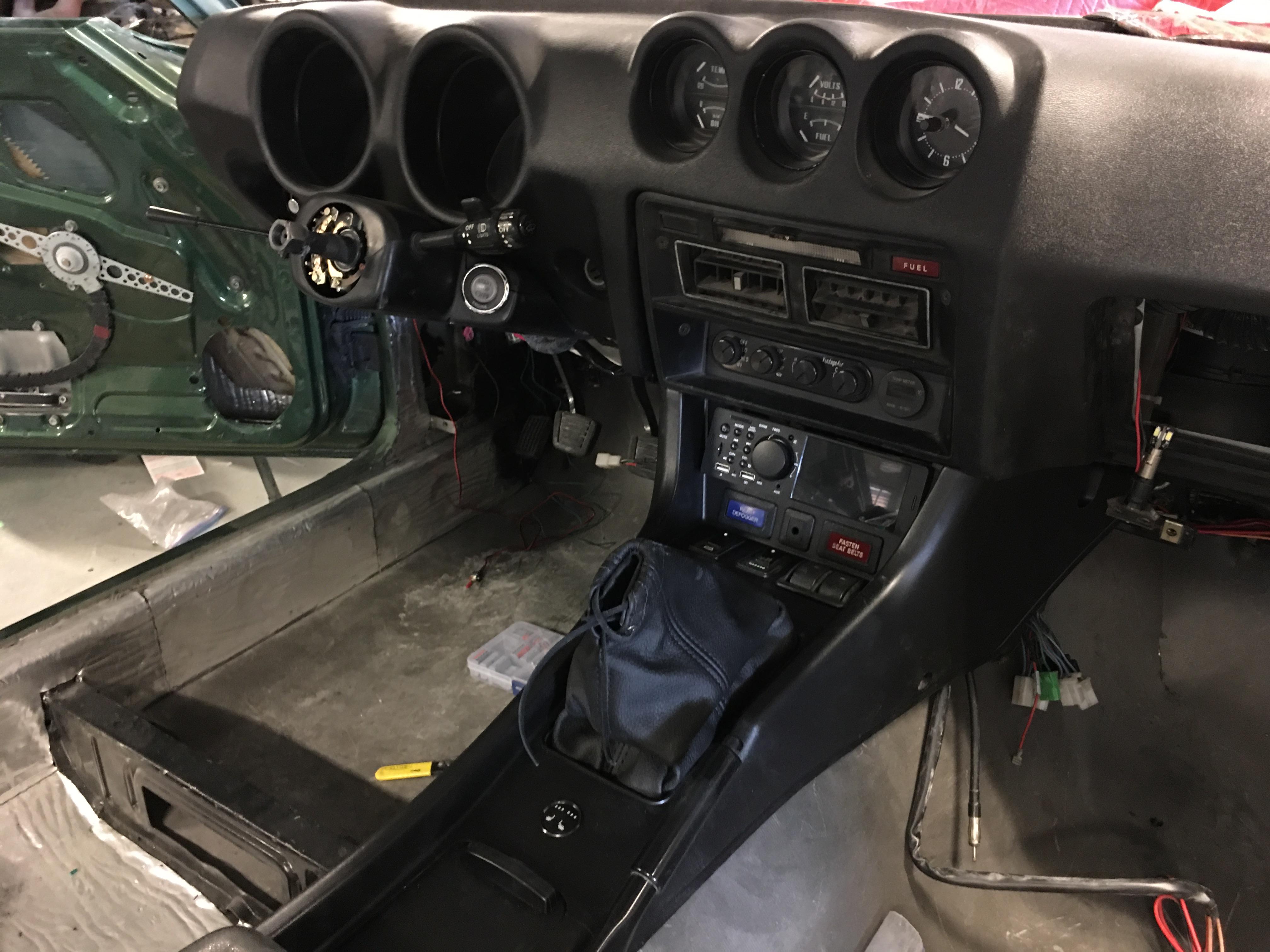

May 7, 20205 yr Author comment_599040 Test fit of the console with the seat heater switch and the power window switches installed. Link to comment https://www.classiczcars.com/forums/topic/50908-1976-280z-restoration-project/?&page=267#findComment-599040 Share on other sites More sharing options...

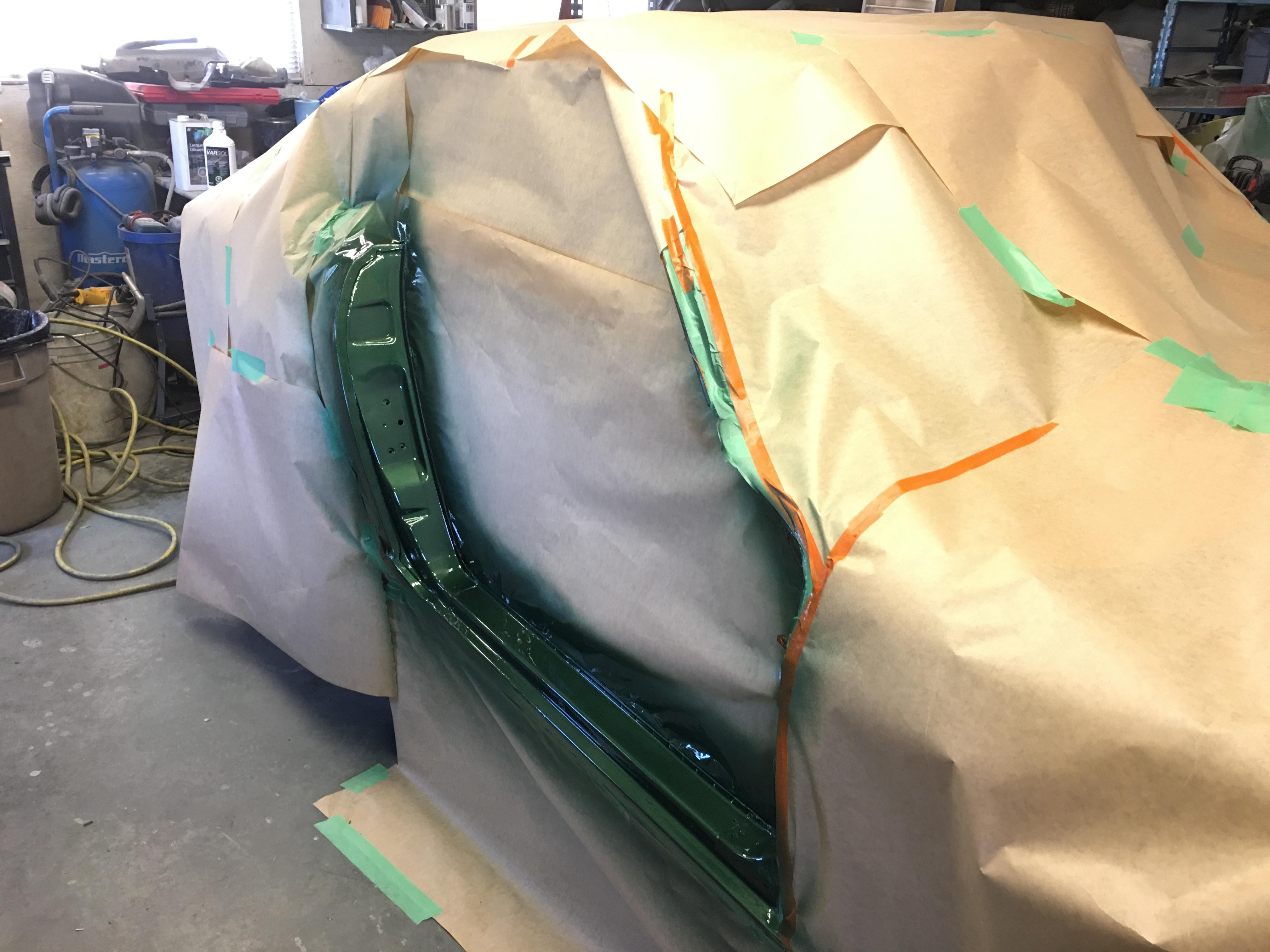

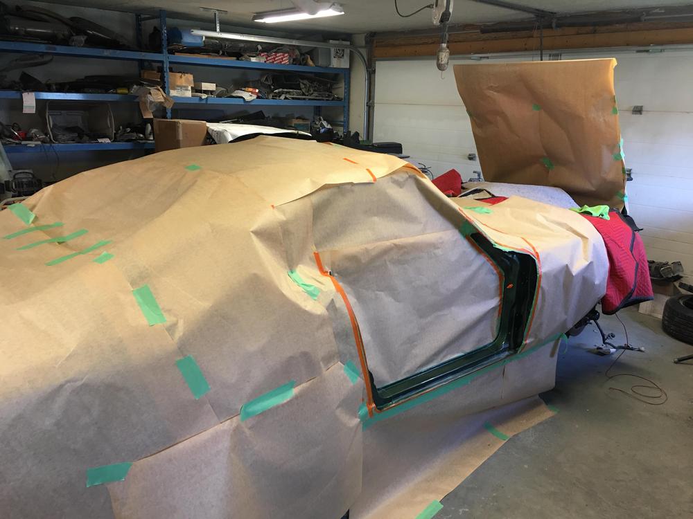

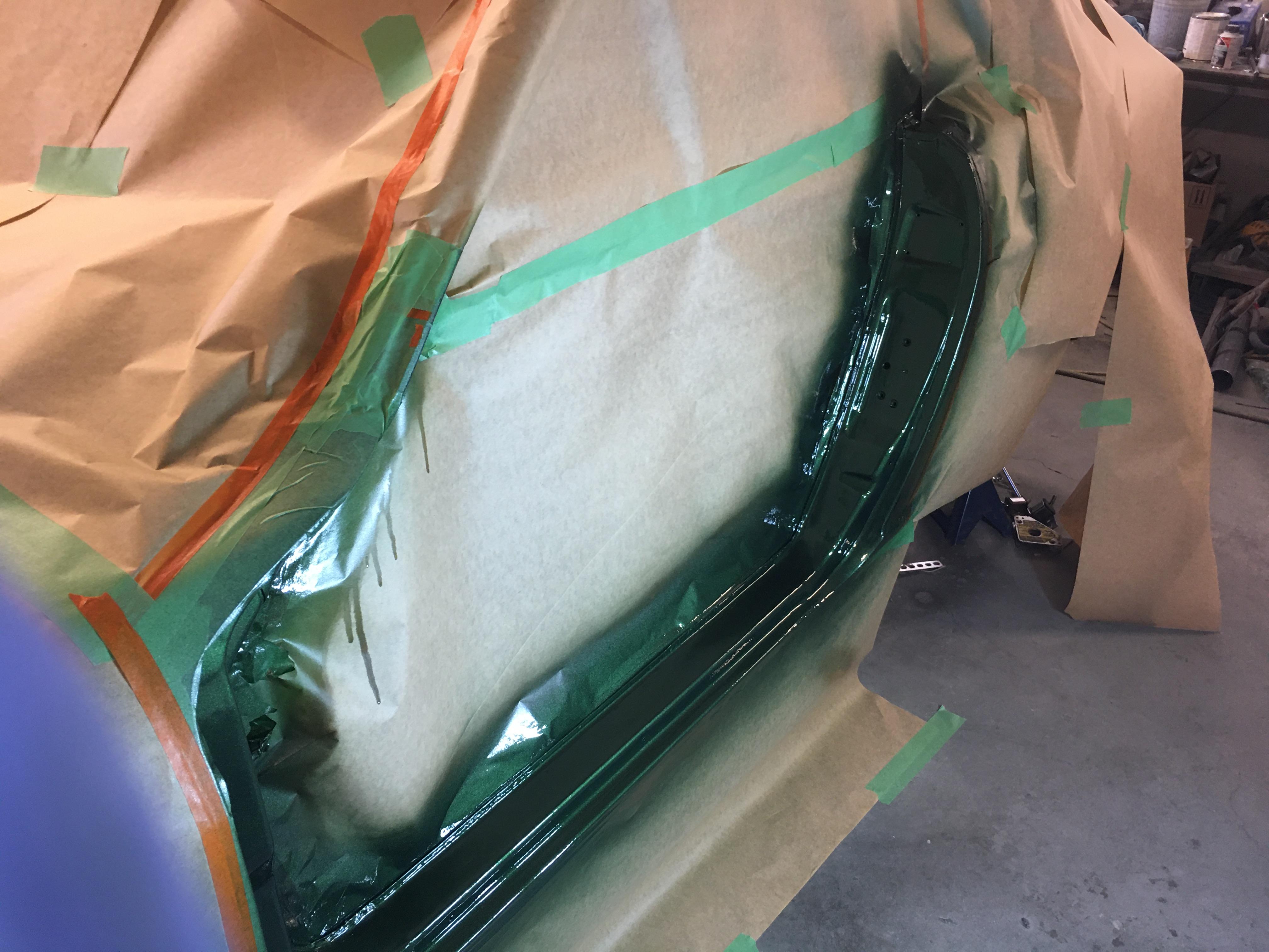

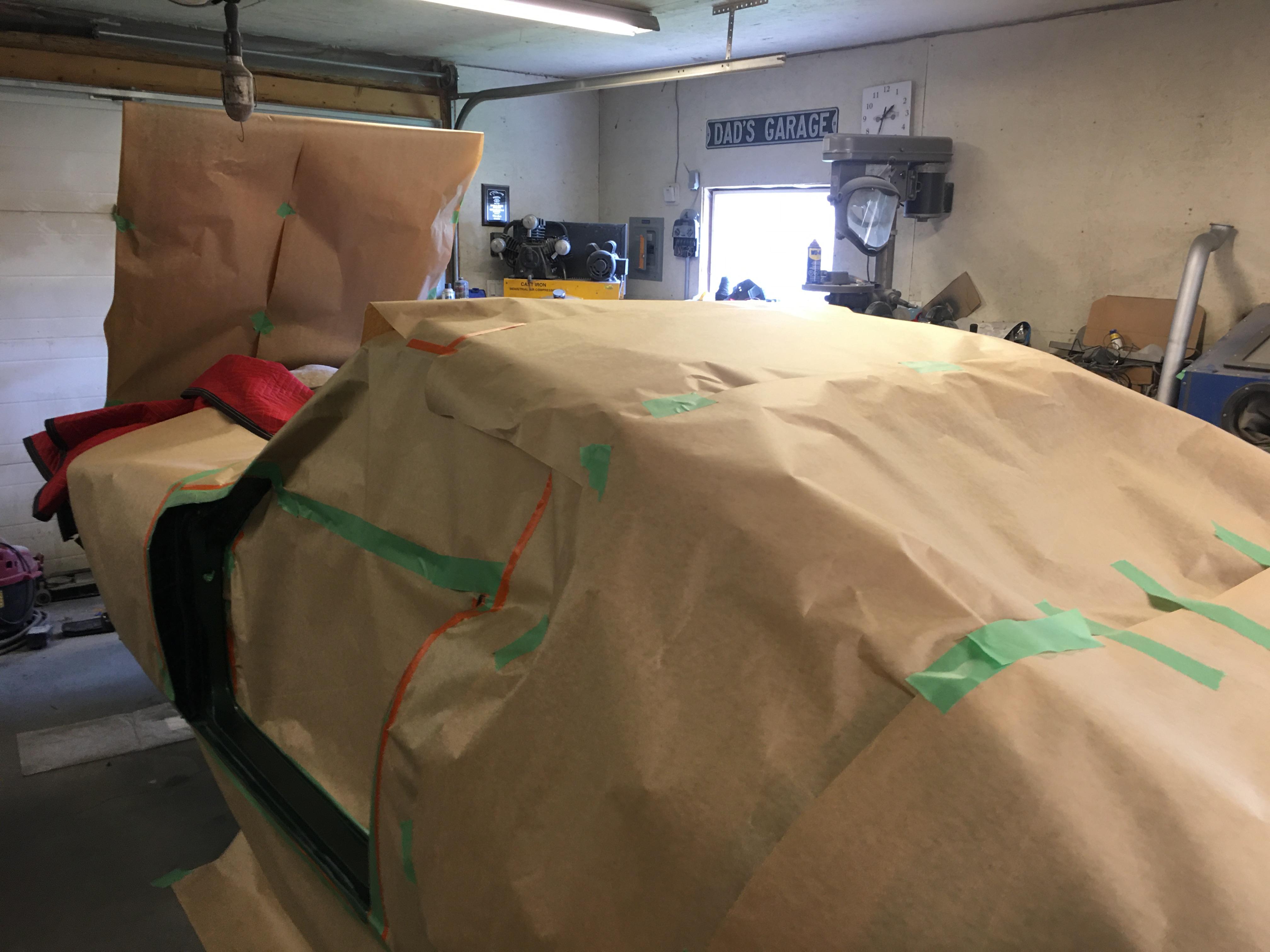

May 8, 20205 yr Author comment_599092 So every now and then we have a wart show... My attempt to paint the car with the doors on and the jambs already painted ended up with unacceptable overspray, even with the masking and joint filler. Today I masked off the car and removed the doors to paint the jambs all over again. Yay me.... Link to comment https://www.classiczcars.com/forums/topic/50908-1976-280z-restoration-project/?&page=267#findComment-599092 Share on other sites More sharing options...

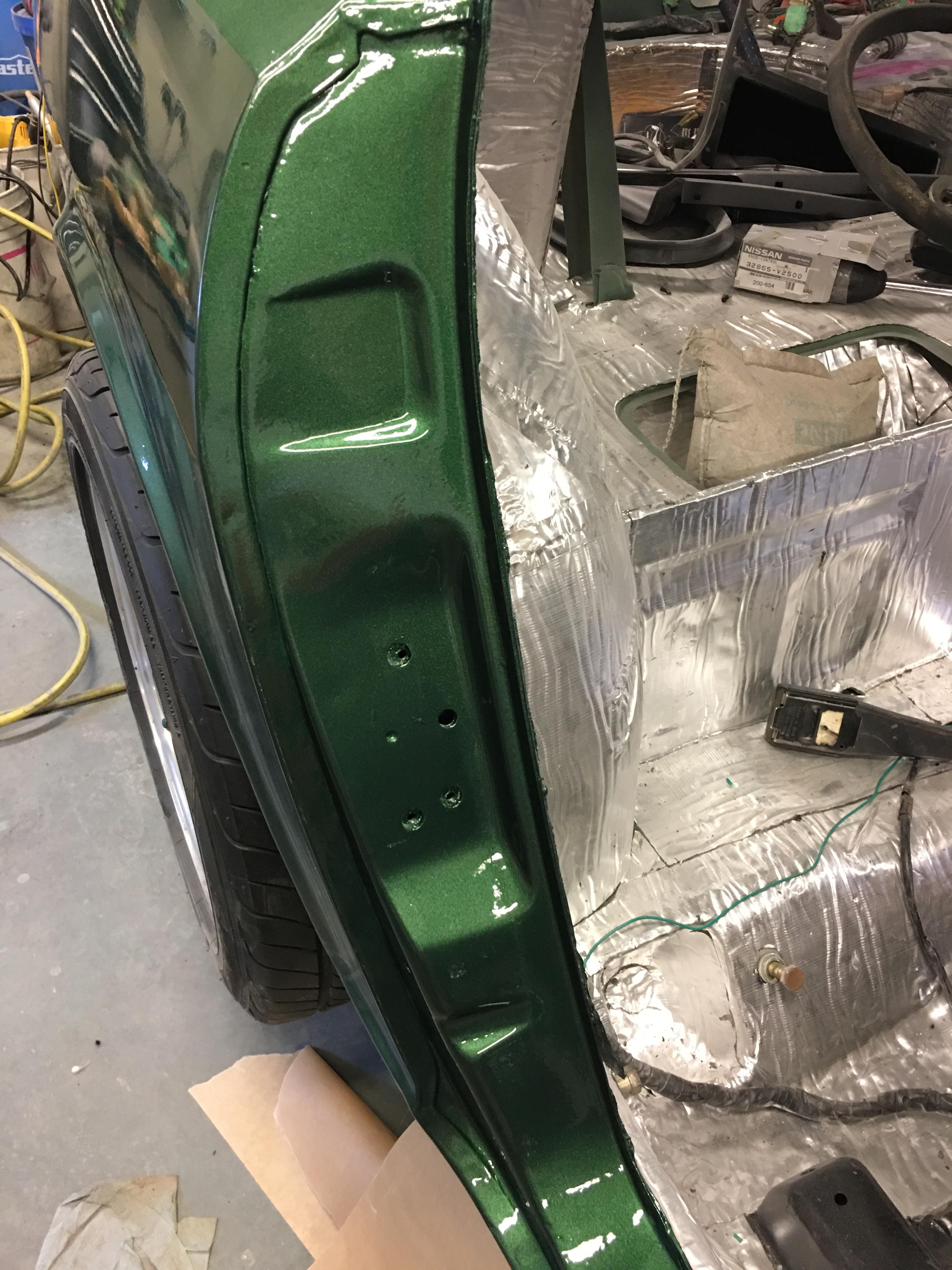

May 8, 20205 yr comment_599093 Always a silver lining. Now it’s easy to drill the holes for the speaker wires and grommets. Do it BEFORE you paint it Link to comment https://www.classiczcars.com/forums/topic/50908-1976-280z-restoration-project/?&page=267#findComment-599093 Share on other sites More sharing options...
May 8, 20205 yr Author comment_599094 I did drill them. Just 1/4” guide holes until I can find the right grommets. I will mask and tape the hole to resize it. It’s just door locks and power window wires. I am ordering the kick panel speaker covers so the speakers stay out of the doors. Link to comment https://www.classiczcars.com/forums/topic/50908-1976-280z-restoration-project/?&page=267#findComment-599094 Share on other sites More sharing options...

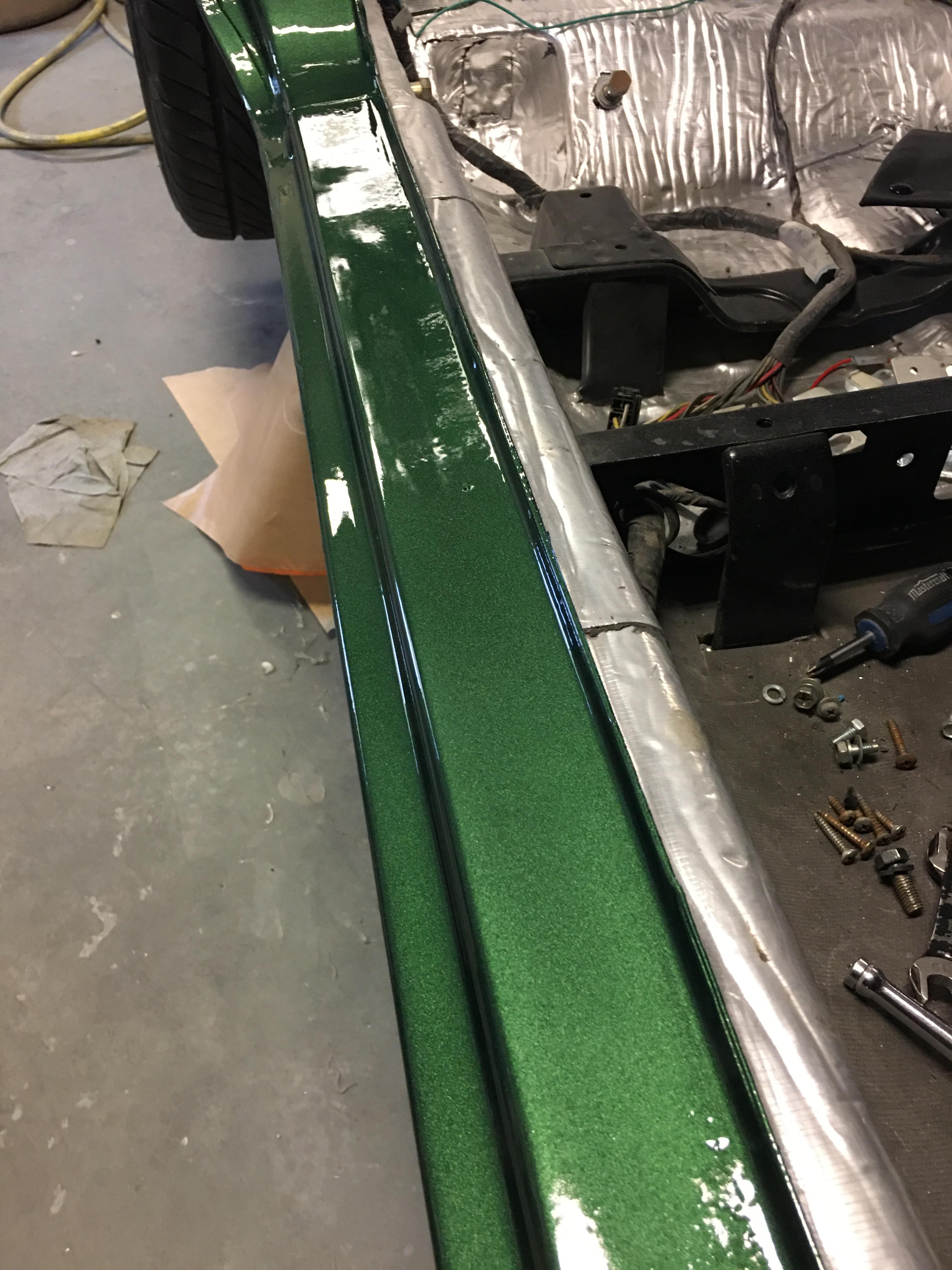

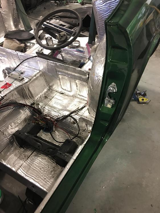

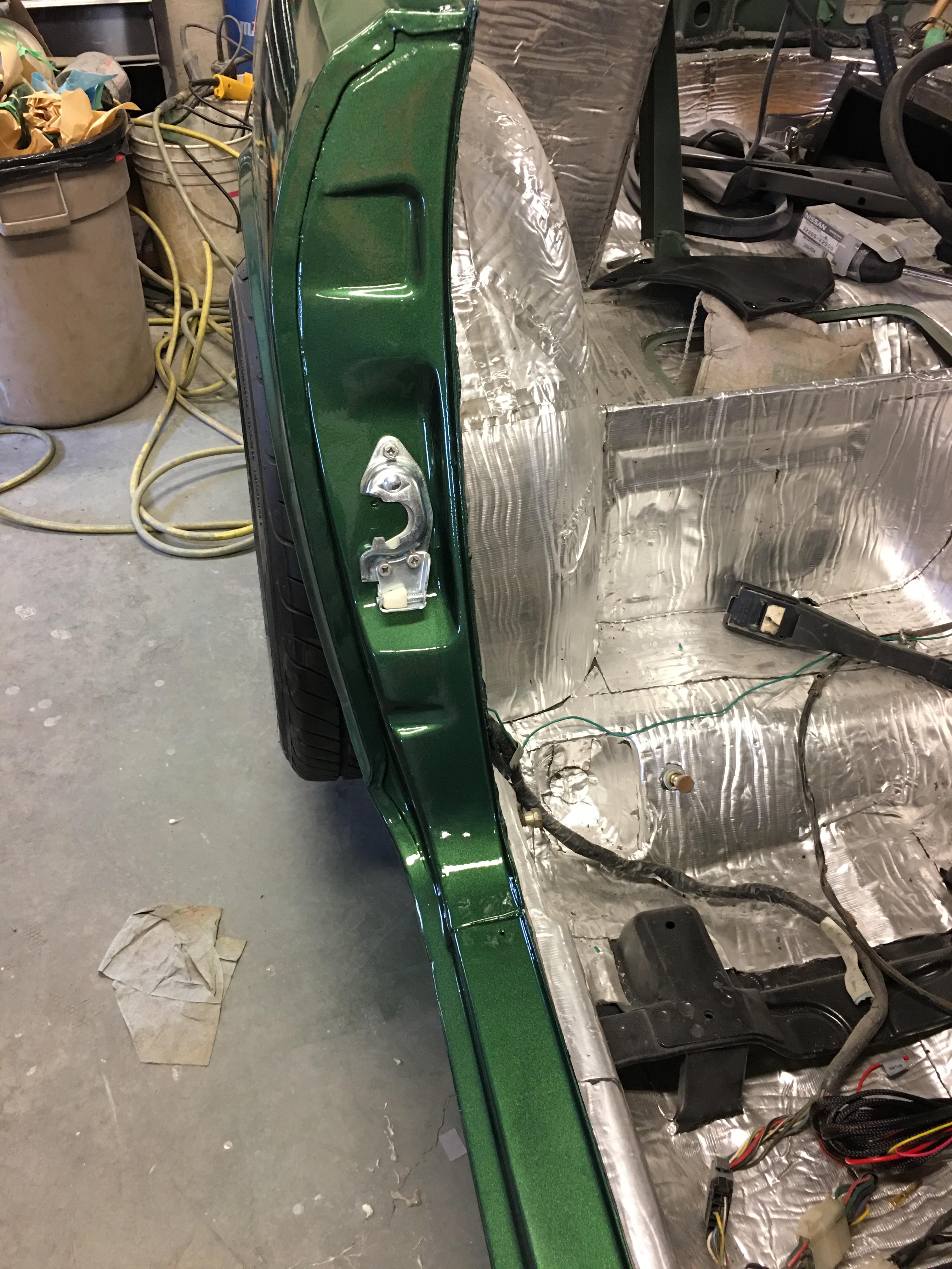

May 10, 20204 yr Author comment_599156 Well worth the effort... Link to comment https://www.classiczcars.com/forums/topic/50908-1976-280z-restoration-project/?&page=267#findComment-599156 Share on other sites More sharing options...
