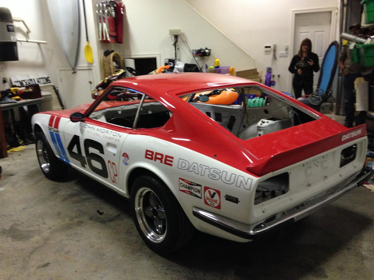

I will take some better photos of how it is sitting.....but I do want to share my excitement of 10 years. :-)
The car is actually sitting better now than in this photo. Springs were backwards in this one.
post-554-0-03399800-1424464817_thumb.jpe
Are you using stock suspension bushings or aftermarket urethane?  Looks like a fun car but the important details are sparse, re your problem.  And springs don't care if they're upside down or downside up, it doesn't matter, unless the perches match the ends (which would be unusual).  If you meant front to back backwards, that's a whole different thing, since they're different rates.
Urethane bushings.....and stock (for now, anyway). The Springs were front to back backwards. DOH!  The car is sitting much better now, but still seems high on the driver's side. (front and back)
Although I was out-of-line with John (thanks for setting me straight everyone).....I am going to take his advise and see how it sits after all the weight is in it. I think he is correct that there is likely no structural issue. As I mentioned, the body panels and doors line up better than ever.
